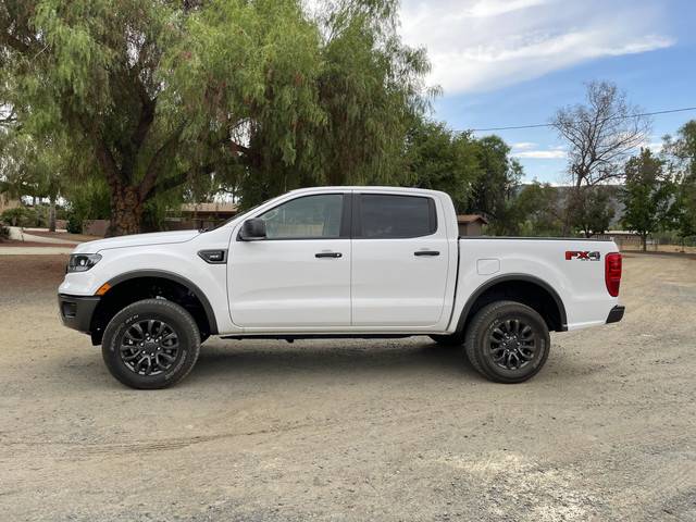

How she sits now:

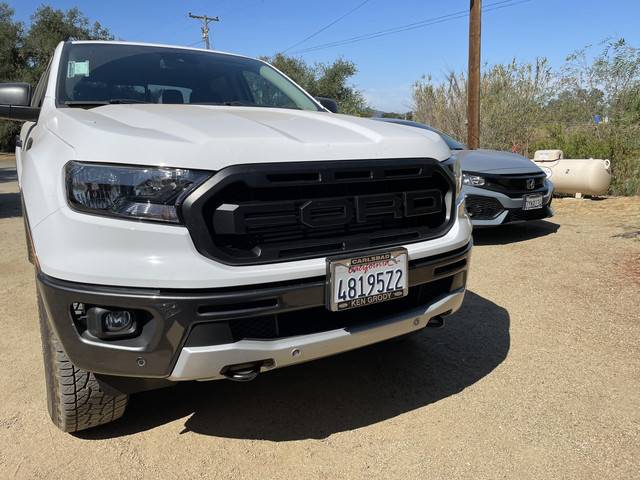

Ranger Raptor grill install. Purchased the grill from stage 3 motorsport.

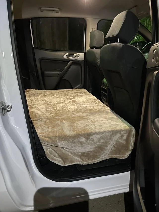

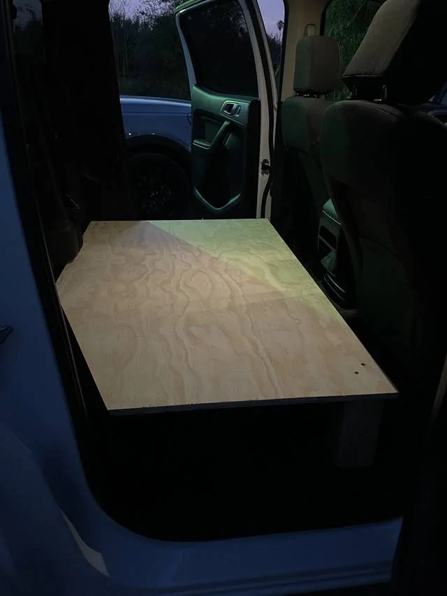

Built a platform for my dog and removed the rear seat. I have an abnormally large shepherd who loves to be spoiled. V2 of this platform is being built with a memory foam pad for the pup.

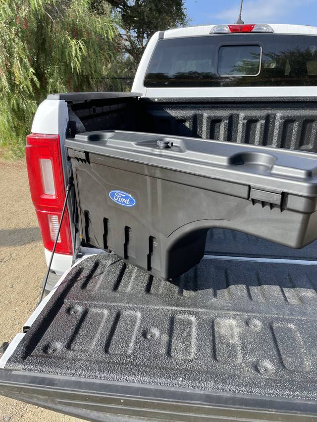

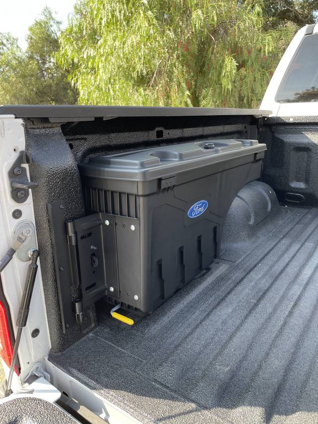

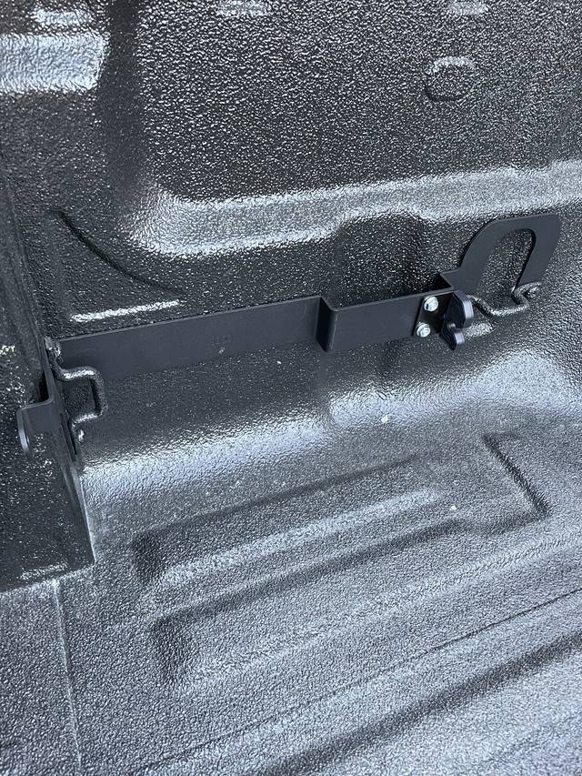

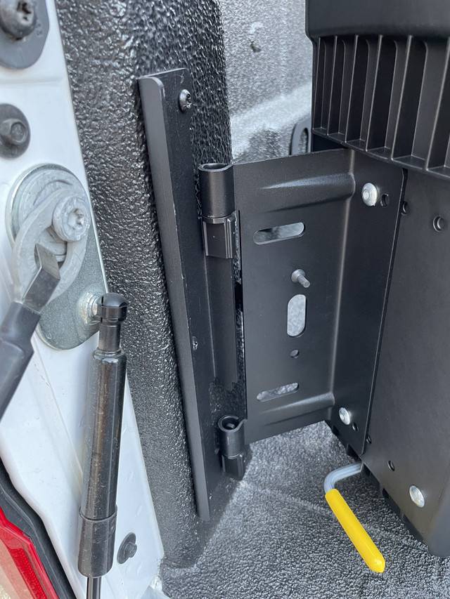

Ford driver's side swingout tool case:
Install was incredibly easy, just 2 brackets at 7 bolts. Everything was pre-drilled and tapped from factory, had to use a razorblade to clean up some of the bedliner around the holes so I could start them.

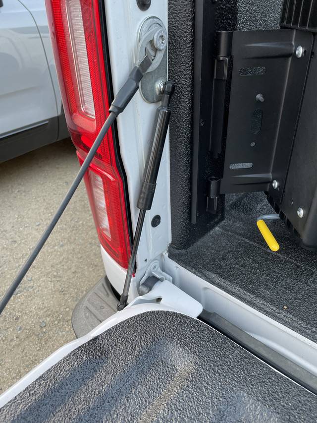

And of course, had to throw on the tailgate damper!

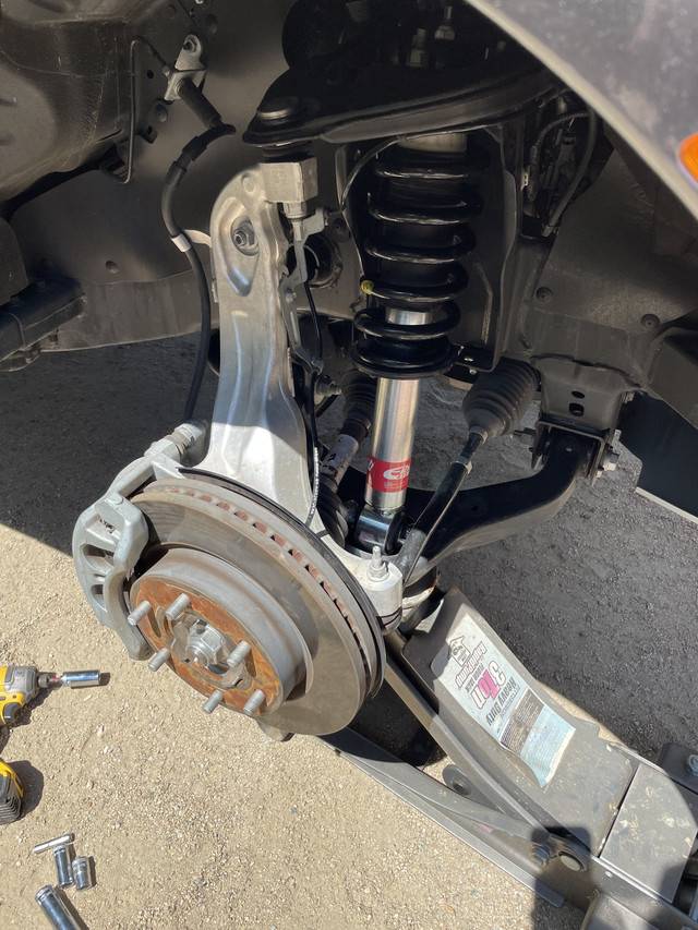

Eibach Pro Kit went on the front this weekend. Still waiting for my rears. Battled with it for about 7 hours in the dirt, only for it to have a rattle after. Cooled off for a couple of days and resolved the rattle issue when I realized I forgot to torque the strut shaft nut on top of the spring hat :facepalm:.

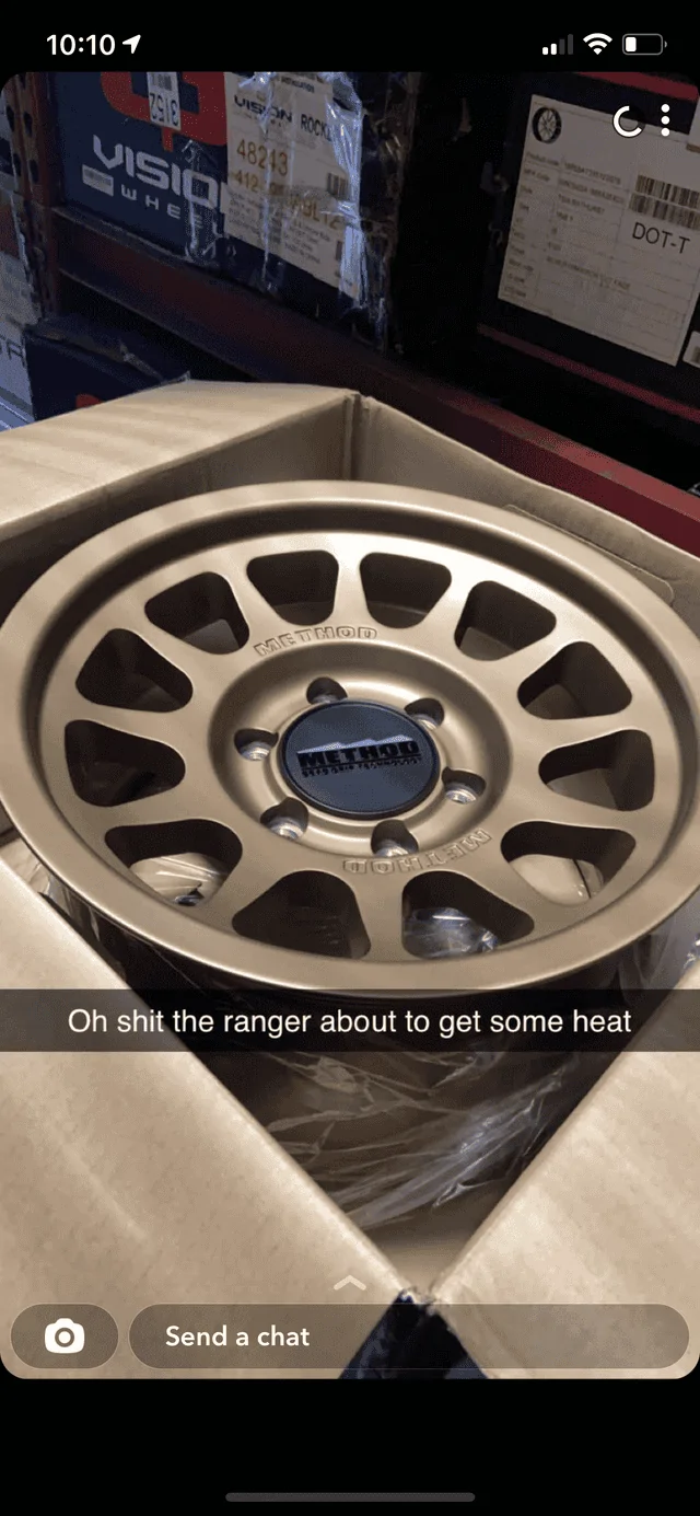

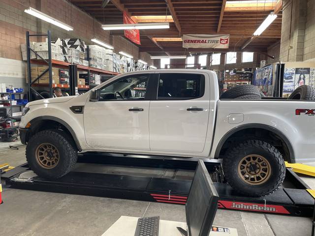

Also, my wheels came in this morning! Getting them mounted and the truck aligned on Wednesday. Sorry for the linked Snapchat picture, this was sent to me straight from my friend at Discount Tire, haven't even seen the wheels in person yet!

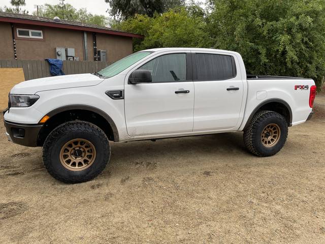

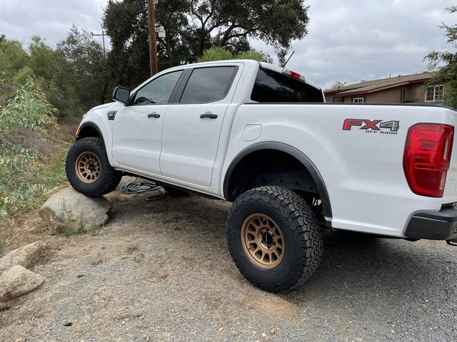

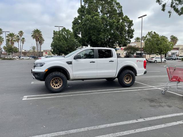

Wheels and tires went on yesterday!
I had to remove all of the crash bars and the 33s fit perfectly, no rubbing. Absolutely loving the fitment. Discount Tire in San Marcos did a great job installing, then North County Wheel and Tire in Escondido did my alignment. Slim at North County Wheel and Tire does a great job with off-road vehicles; highly recommend him for all of the North County SD folks.
Special shoutout to I Got A Guy Automotive in Escondido as well for helping me torque my UCAs and double check a couple of other suspension torques!
Here is some pic heavy spam for you all.
Wheels: Method MR703 in 16x8 +0
Tires: BFG KO2 in 285/75/R16

You don't happen to have a measurement on that platform do you?
Not on hand. I responded to your PM, I will get you measurements and detailed pics tonight. :thumbsup:
For others that may be wondering, I will post everything here after I collect the info!
