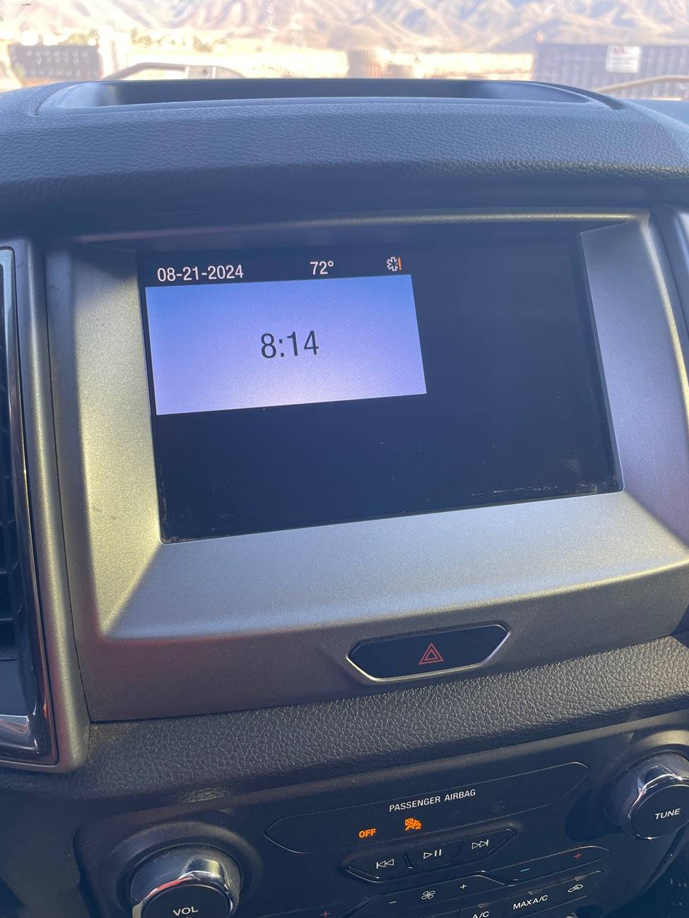

Were you downloading from the Ford site to get the update? Maybe the stick was not setup properly.
I have long since given up on the Ford updates and use the Cyan Labs SYN3Updater app. It formats the USB stick and downloads the files into the proper locations on the stick. No unzipping, or moving files. Just take the finished stick and plug it into the truck and it works. Oh and no bother with uploading a file back to Ford, Which never really worked anyway. They will figure out what version you have eventually anyway.
Hadn't heard of that, what does Cyan charge and have you had or heard of issues? I'd be surprised if not, its still the Ford Sync system!

Oh boy, that's great news! I always do the USB but only because it never was able to connect to Wi-Fi.
I use a 64 GB but I also have the lower Sync. Under $10 and on my keyring only for Ford Updates.

It is still the Ford SYNC system. Cyan Labs simply gets the files from Ford and takes care of formating the USB stick as required and downloading the files into the proper location/folders for you. No hassle of downloading a zipped file and unzipping it and making sure they are located properly. Just tell it what version you want and if you have NAV or not.
It doesn't cost anything

I don't mean to interrupt the key talk, but I did download the update through the ford website onto a 32 GB USB, plugged it into the truck and let it run for 30 mins, did the soft reset (Seek Fwd + Radio power), and now everything works and is back to normal.
Thanks guys!
