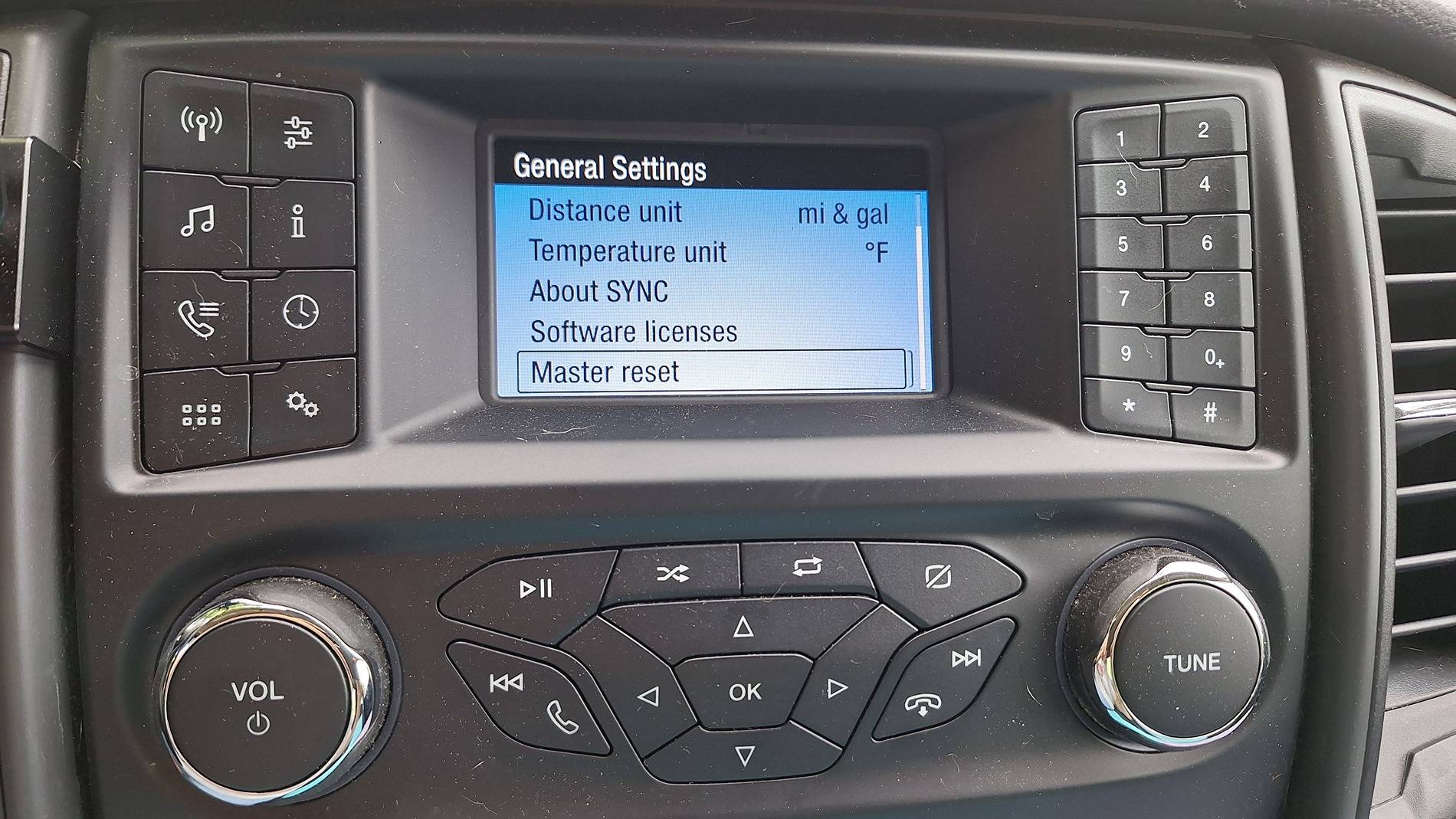

I don't think the OP can do a master reset because he doesn't have the same buttons as the little Sync does. I could not get to a master reset via the steering wheel controls, only by pushing in my radio knob to turn it on, then clicking the little cogs button that I have, and then navigating with the Up and Down buttons.

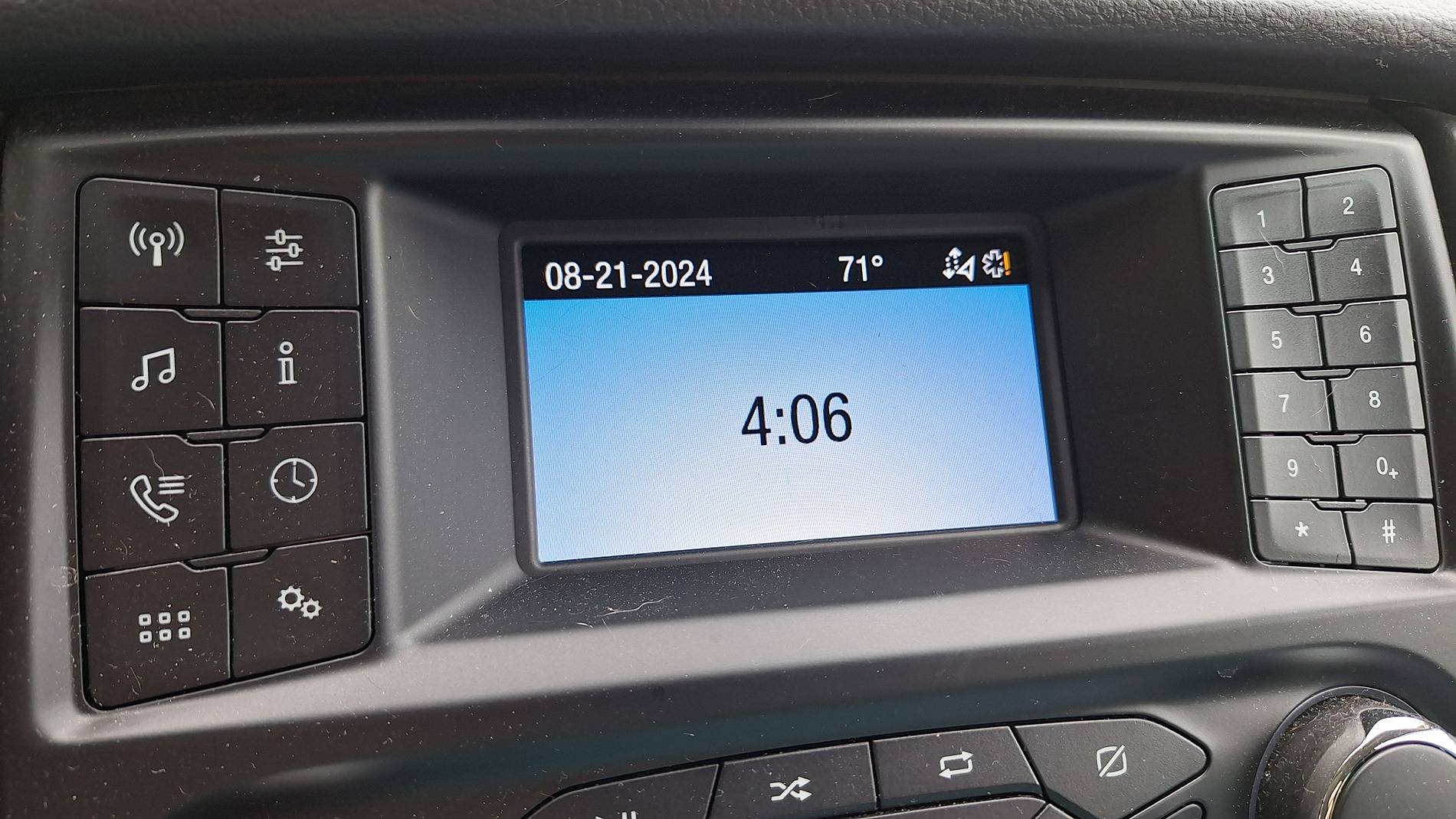

UPDATE:
Called the Ford Customer Relationship Center and after only being on hold for almost 30 minutes I spoke with a nice guy who let me know that because I had initially started an automatic update yesterday but didn't let it finish (was taking way too long) and then I drove off this morning, disconnecting the truck from my home WIFI, my Sync3 system got stuck in between updates. So this is what that looks like. He recommended the manual USB update method. He also said something interesting in that he mentioned anything larger than a 32 GB thumb drive can cause issues with the updating process. He recommended anything above an 8 GB and below a 32 GB.
This was my issue exactly

UPDATE:
