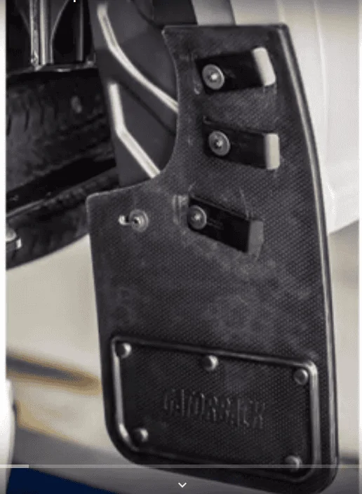

Can you post a pic like this, I want to get an idea of how they look with the wheels on.

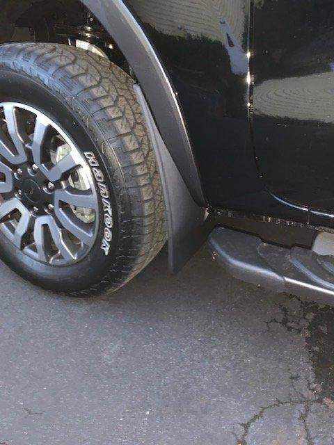

I looked at a bunch of reviews and went with WeatherTech flaps, front and rear. Installed myself. Very happy with them. Good stiffness, without being like a board, and I believe price is considerably less than OEM. Installation will take an hour or two. They say you need a trim plug removal tool; you don't. The retainer pins you have to take out you can easily get with your fingers or a small screw driver. If you do go WeatherTech go to a local shop that sells them (just about any four wheel or truck place) and get them to order for you; then you don't have to pay shipping costs (which you do if you order direct from WeatherTech). One installation point, they say to turn your front wheels to aid with getting the room needed; I found with FX4 and Hankook tires turning them the opposite direction they suggest actually makes it easier.

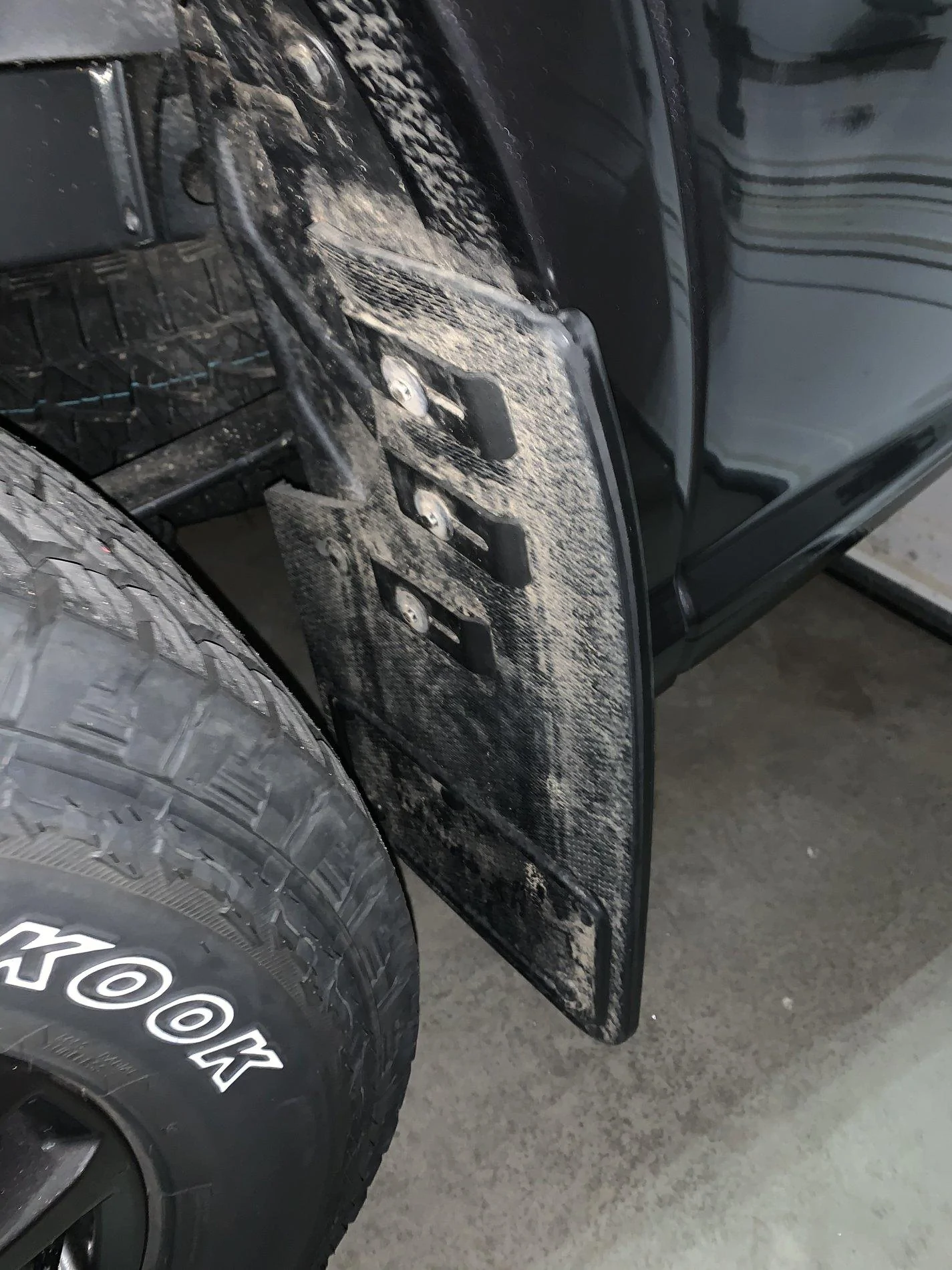

They seem big and bulky but the fit nicely. Keeps the flap locked tight to wheel well. Went to the ski hill twice this week. Nothing got by the flaps onto the paint behind them. I moved mine out wider. I’m impressed. Checked the bolts and everything is lock tight. Installation was easy and would highly recommend them. Everyone who sees them comments on them. They’re not cheap but they do the job. Seems like they’ll last forever.

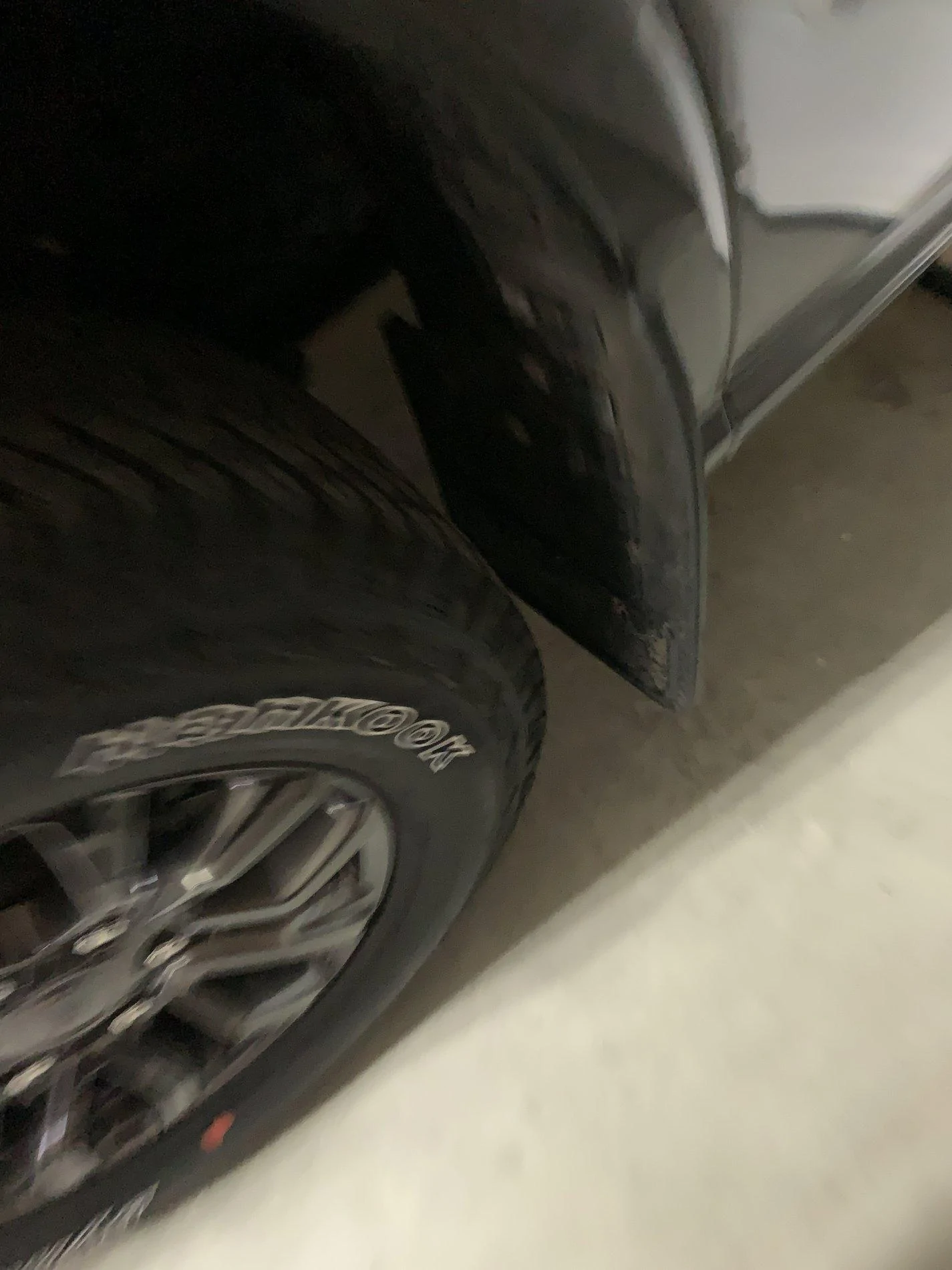

Did you use the little paint protector strips? I'm not sure exactly where they should go
Yes, I put them on. Take a look at the attached pic. They go on the area between the flap and the wheel well. Install them on the wheel well (grey in pic) with about 1/8 inch exposed beyond where the flap and grey painted area meet. Keeps the flap from rubbing/damaging that area under the flap.

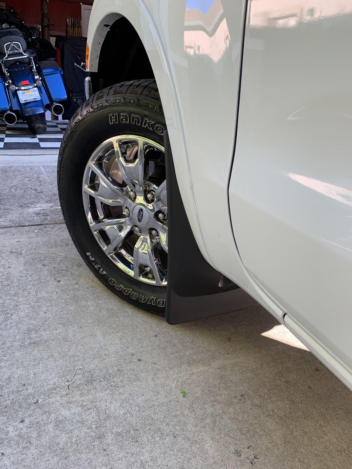

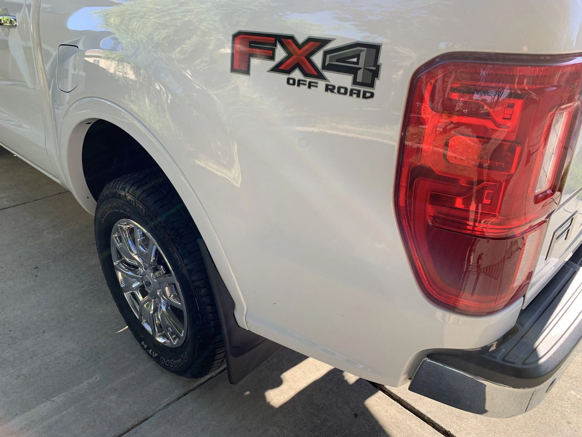

I installed a set from Weathertech today. Not too difficult although if I ever meet the tiny handed bastard who invented those clips you screw into I’m going to take several projects worth of frustration out on him. If anyone gets these the instructions say turn the wheel all the way to the left to work on the driver side and right for the passenger side. That’s fine for the outer screws but leaves no room for the inner screw. Turning the wheel the opposite way gives plenty of space to work on that one. I only wish I had figured that out before the install was complete
I installed the Weathertech ones also and am very happy with them...the install was fairly easy but did require some nimbleness...I'm a big fan of Top Coat F11 and I use it on everything including glass, plastic and rubber...it is very expensive but to me is worth it...
