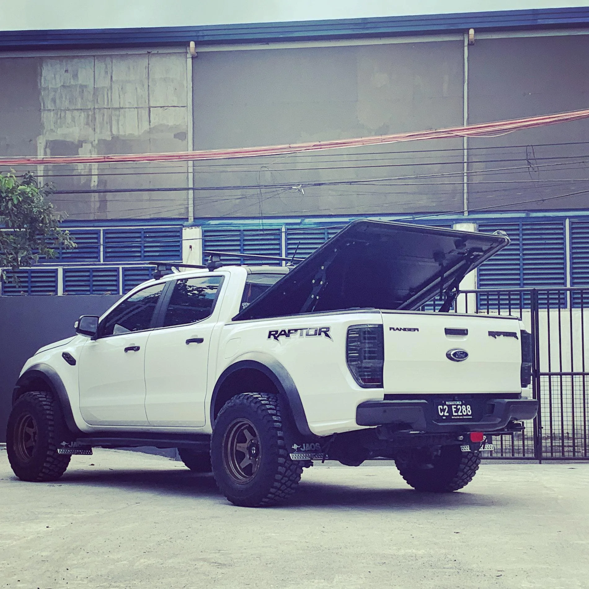

I hesitated on getting aftermarket mud flaps for a long time.
i pulled the trigger because my tires were throwing rocks onto the body, this is what it got

Angle showing how the tire extends out

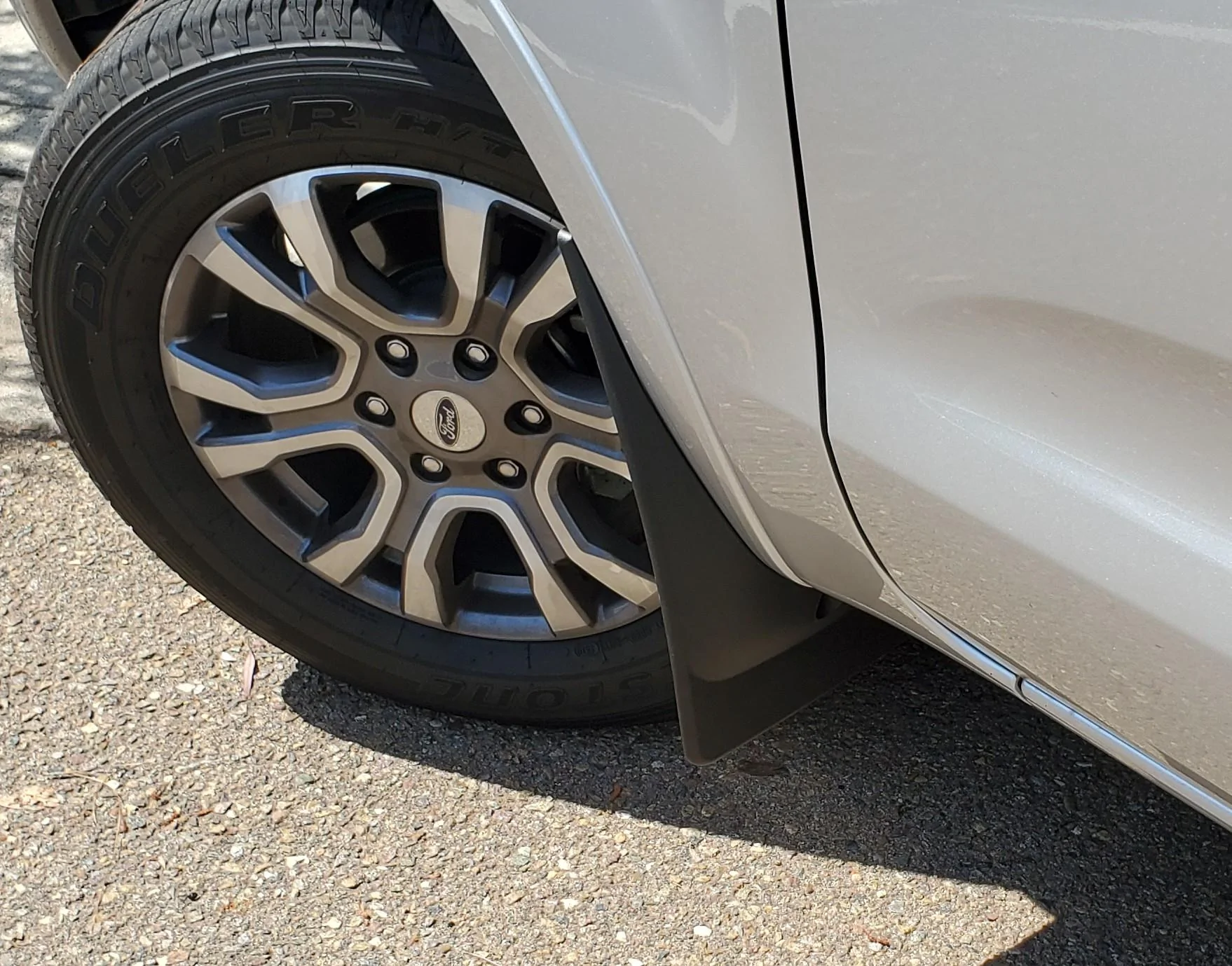

Installed the Weathertech's today, 1hr, perfect fit
I highly recommend them?

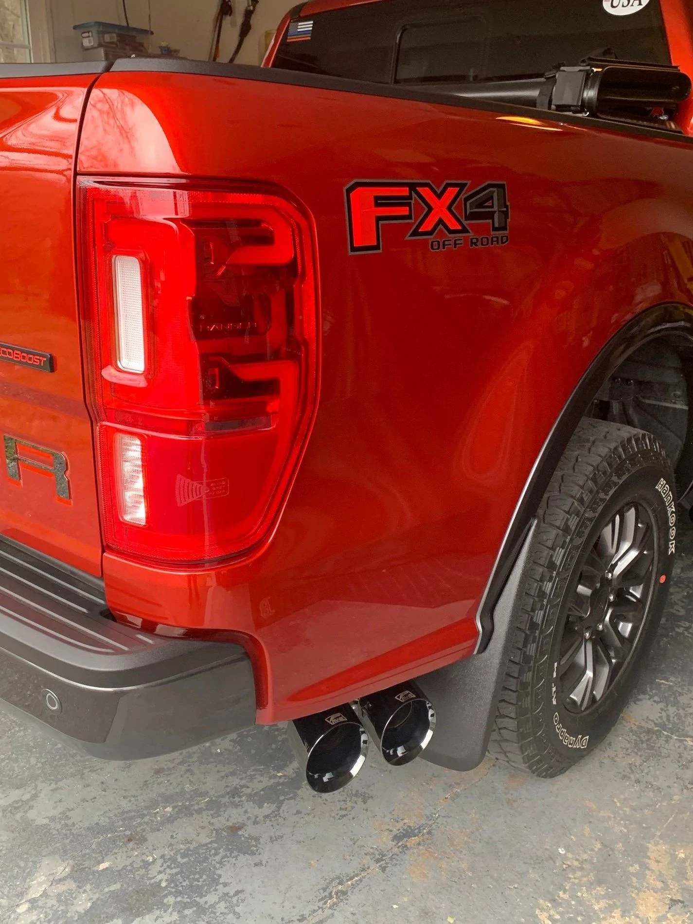

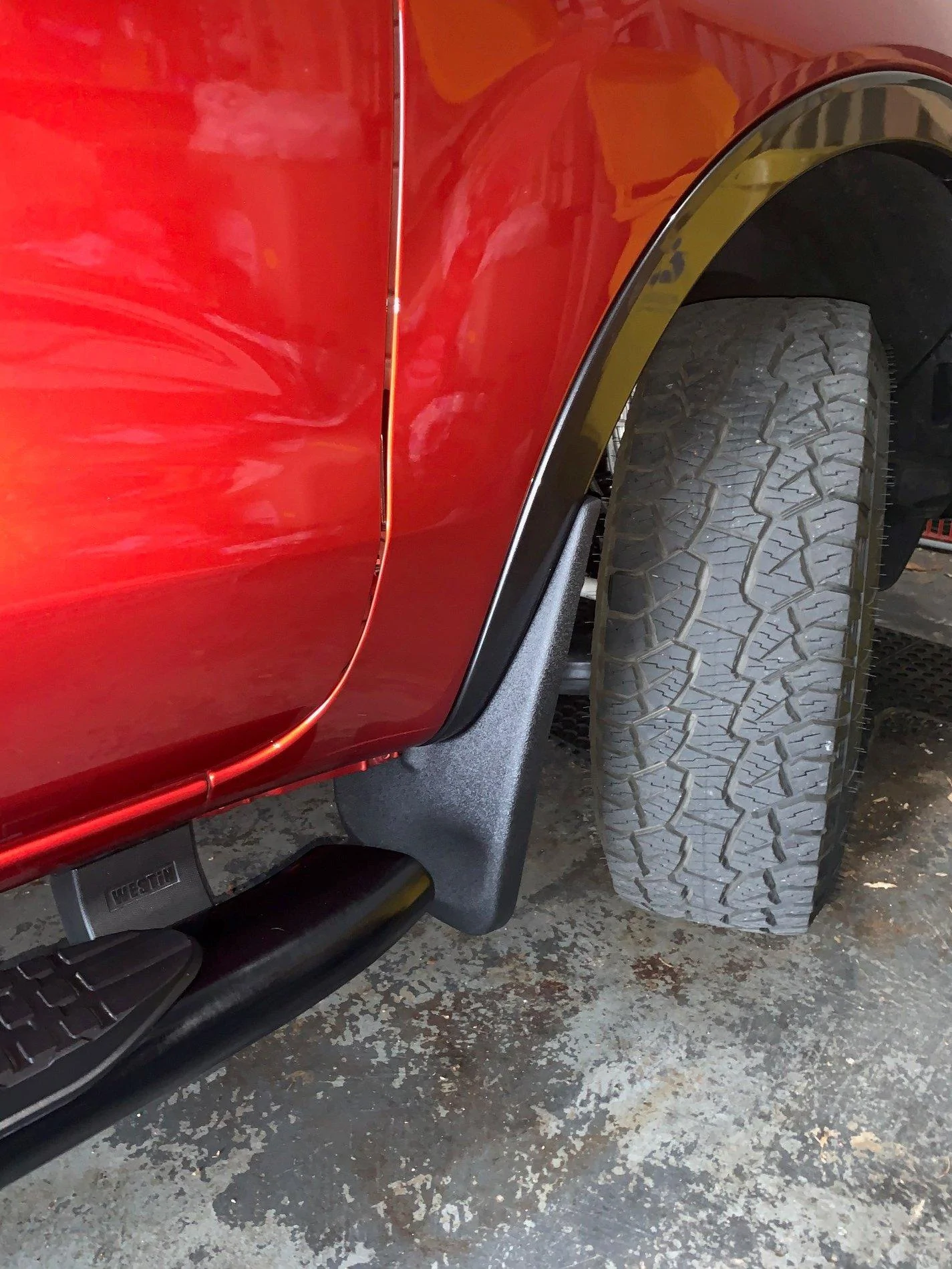

Decided to give the Husky Molded Flaps a try. At $72 shipped, was worth a shot. Put them on today in a fairly decent amount of time. Few notes:
  • They seem a bit flimsy compared to others I have put on in the past, but should hold up well in this area.
  • The clear paint protection film was bit of a hassle to remove from the sheet as you cannot see the outline of the cut out. I had to pull more than should be necessary to separate the film from the sheet. But it is easy to apply.
  • Biggest PITA was attaching the clips that hold the top to the inner wheel well. Fronts were the worst, rears went on easier. Several F'Bombs dropped...
  • They use double sided tape to mount to the inner frame on the front and to the wheel well liner in the back.
    • Twice the tape came off the mud flap, so I replaced it with some 3M heavy duty tape, clamped the rear for a few hours to ensure they bond.
  • They look decent enough, time will tell as to how they hold up. Guess they are worth $72...

I ordered mine a day or so before you posted and they just came. Those clips: dead on as well as the front double sided tape sucks to hold. Same issues with peeling the clear decals too.

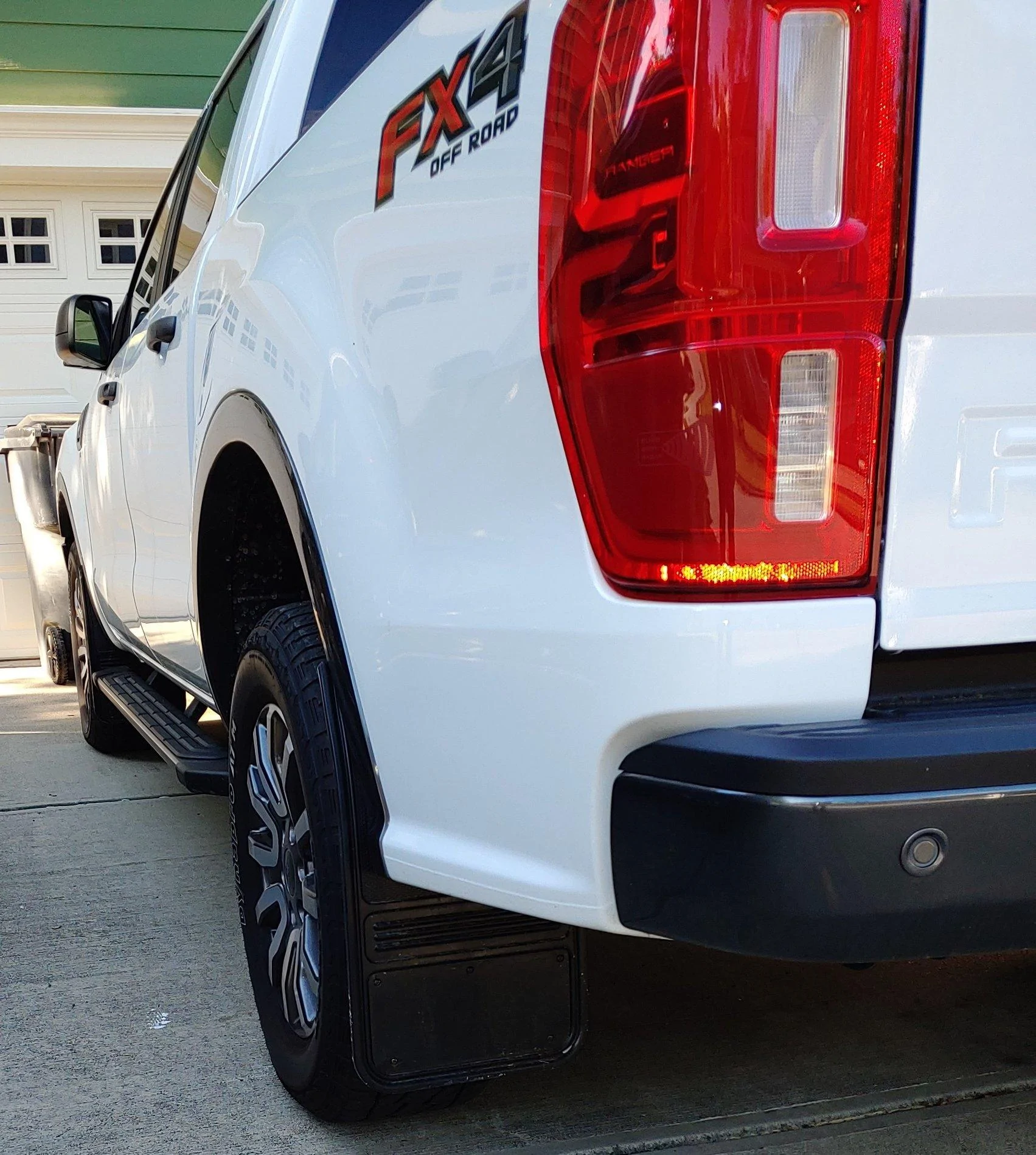

I spent extra and went with Gatorback. Got them with out the metal plates to make the price more palatable - LINK.
Still pricey but real thick rubber mud flaps. And if I win the lottery someday I can buy the metal inserts then.
Install was easy. 1 hole to drill in the plastic rear wheel liner, which I was able to do without removing the rear wheels. But be careful not to over tighten!
Very Happy with them.

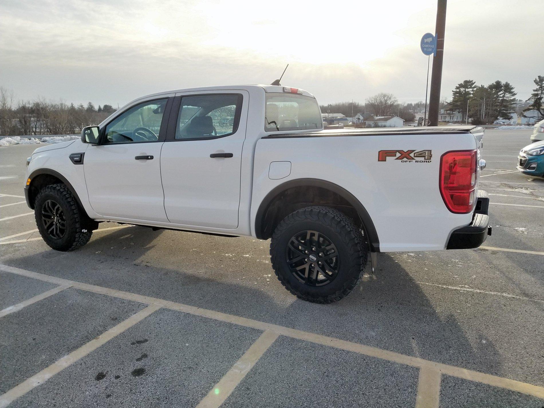

Put on weathertechs for the same reasons . They are rugged and keep the rockes off the rockers . Even protects the front of the steps or rails .
