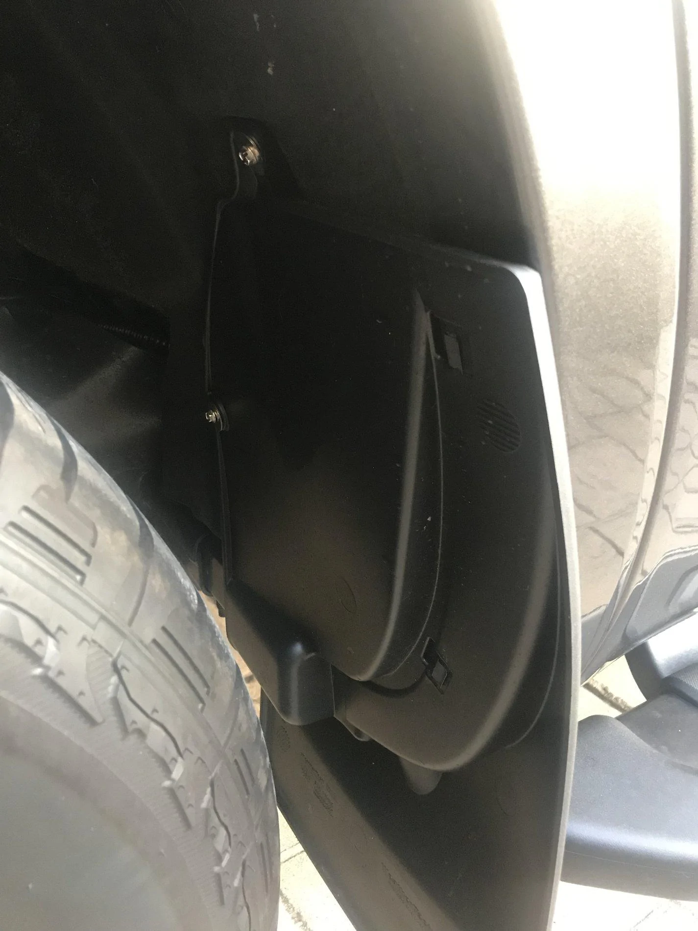

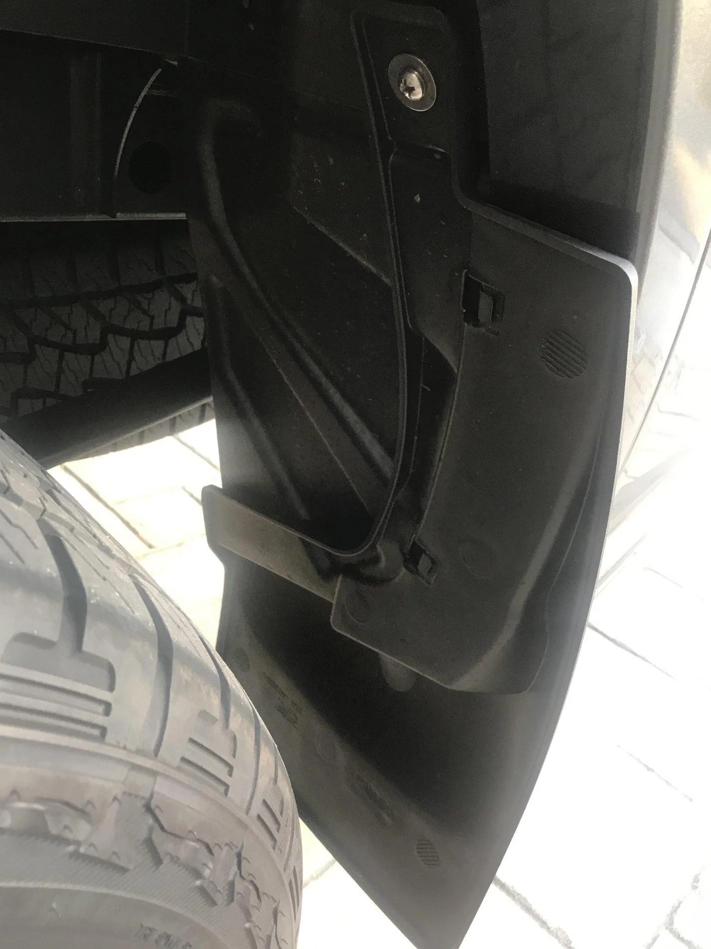

Thanks. When you get a chance sometime, could you post up a picture or two of how they mount?
Edit.. sorry I was thinking it was you who had the Weathertech ones!
Here are a couple of quick pics of the mounting. A few of the plastic fasteners inside of the front fenders come out and are replaced by those u-clips and screws. It was only tough to place 1 of the 2 u-clips needed only because I wasn’t comfortable pulling the wheel well liner as far back as the instructions show...didn’t want to deform it. Then just a couple of small clips hanging onto the flap and fender. The back mud flaps are super easy to install

Thanks! So I could just leave those u-clips in and just put a black screw in and it wouldn't show if I took them off in the summer. That's all I do with my Mazda and it's Rally Armor flaps each spring when I take them off.

That would work.
