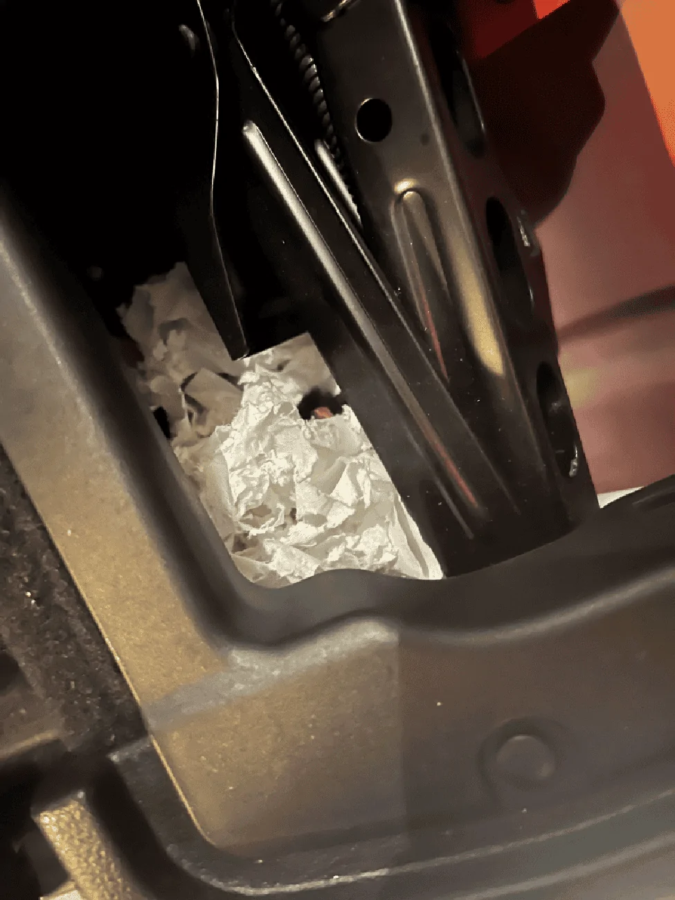

I live out in the country with all the pluses and minuses of abundant wildlife. This week I noticed that my truck was starting to smell, as my sister-in-law would say, "like the monkey house."
I found a nest by the jack under the rear seat, along with a decomposing mouse carcass. He was just a little guy, though, so I was skeptical that he was the only stinker.
Under the back seat cushion on the other side is a sealed compartment, held in place by christmas-tree fasteners. I pried them out and found a second dead mouse under the box.
Obviously I gave the entire cab a good going over. I found some plastic debris and a couple turds in the glovebox but no dead bodies. Happily the cabin filter hadn't been chewed, so I think they hadn't invaded the HVAC plenum.
Just a suggestion that people doing a similar search don't overlook the space under that storage compartment. If they can get in by the jacking equipment they can get in under the box.

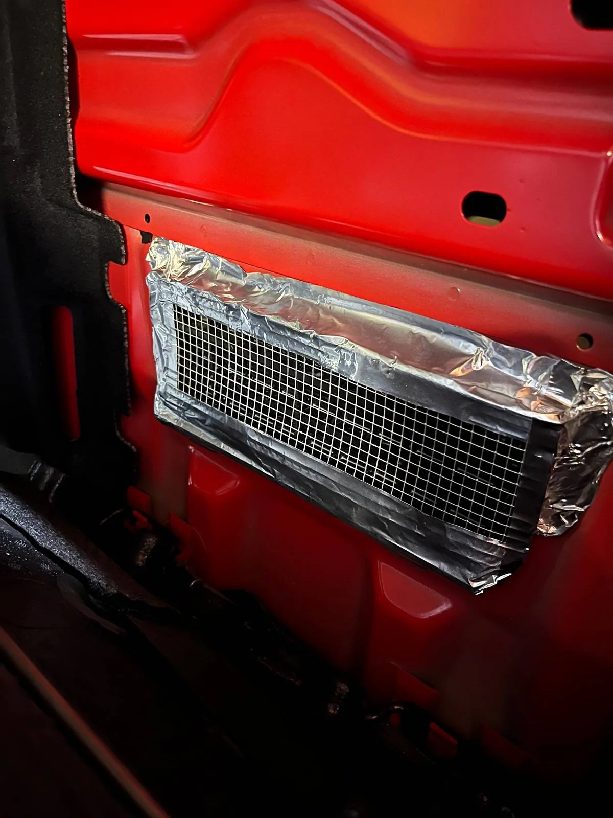

Continuing my mission ... I pulled out the rear seat backs this morning and found the two cab vents. One had a piece of rigid open-cell foam glued over it as a filter for dust, vermin, whatever. The driver's side vent was lacking that foam piece, though. It looked like a great entry point for mice, so I cut a piece of 1/4-inch hardware cloth to fit and duct-taped it over the vent. That should be a deterrent, assuming mice don't like the taste of duct tape.
While I had the back seat out I pulled the sill trim. There was more nest material on the driver's side but the passenger side was clean. I'm hoping I've cleared out the mouseketeers for the foreseeable future.
Any chance you can provide more detail on how to remove the cloth liner that covers these two rear vents?
I have sealed up my front HVAC intake vents under the plastic cowl (the entry to the cabin filter). I would like to screen up these rear vents also.
I have a crew cab if it matters.
Thank you.

The crew might be different from my supercab. I had no cloth covering over the vents, just the foam covering one of them

You may also want to do the rear vents behind the back seat. I've had rodents enter there on a camping trip in northern Vancouver Island. I haven't done that myself, but I will be doing it soon.
Here's my after pic for the cabin air intake vents. I used standard aluminum screen from Home Depot and butyl tape, which I had on hand for RV repairs.
