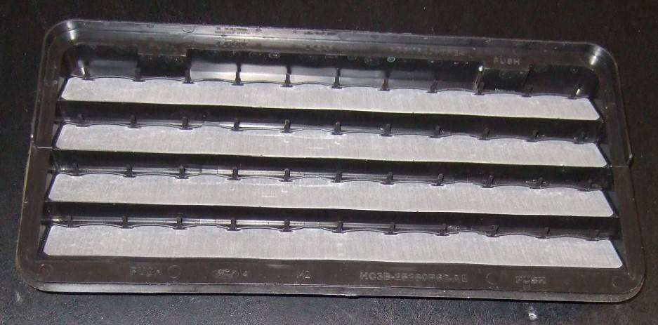

I just did this modification 3 days ago.
I agree working space is very limited.

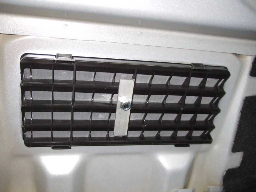

You may also want to do the rear vents behind the back seat. I've had rodents enter there on a camping trip in northern Vancouver Island. I haven't done that myself, but I will be doing it soon.
Here's my after pic for the cabin air intake vents. I used standard aluminum screen from Home Depot and butyl tape, which I had on hand for RV repairs.
Unfortunately, the tape is a weak link. Mice will eat right through it.
How would you attached metal screen material? Others have used HVAC ducting tape, which I am not sure will stand up to moisture like butyl tape.
Short of using metal rivets or screws, I am not sure how one can attach metal screen without some kind of tape. The butyl tape I use is pretty solid stuff. It is used to seal the roofs of RVs.

Iā€˜m well familiar with butyl tape. I used many rolls of it to attach vapor barrier to the concrete walls of my crawl space when I enclosed it. Great stuff, but no contest for a mouse.
Maybe something like this butyl tape with metal mesh built into it. I don’t know how hard it may be to work with.
https://www.wildlifecontrolsupplies.com/animal/WRAT00X.html

That looks promising. I’d verify the temperature threshold of that adhesive though, engine bay gets hot and after several temperature cycles it may begin to peel… just a thought.
Maybe give the 3m weatherstrip adhesive a go
