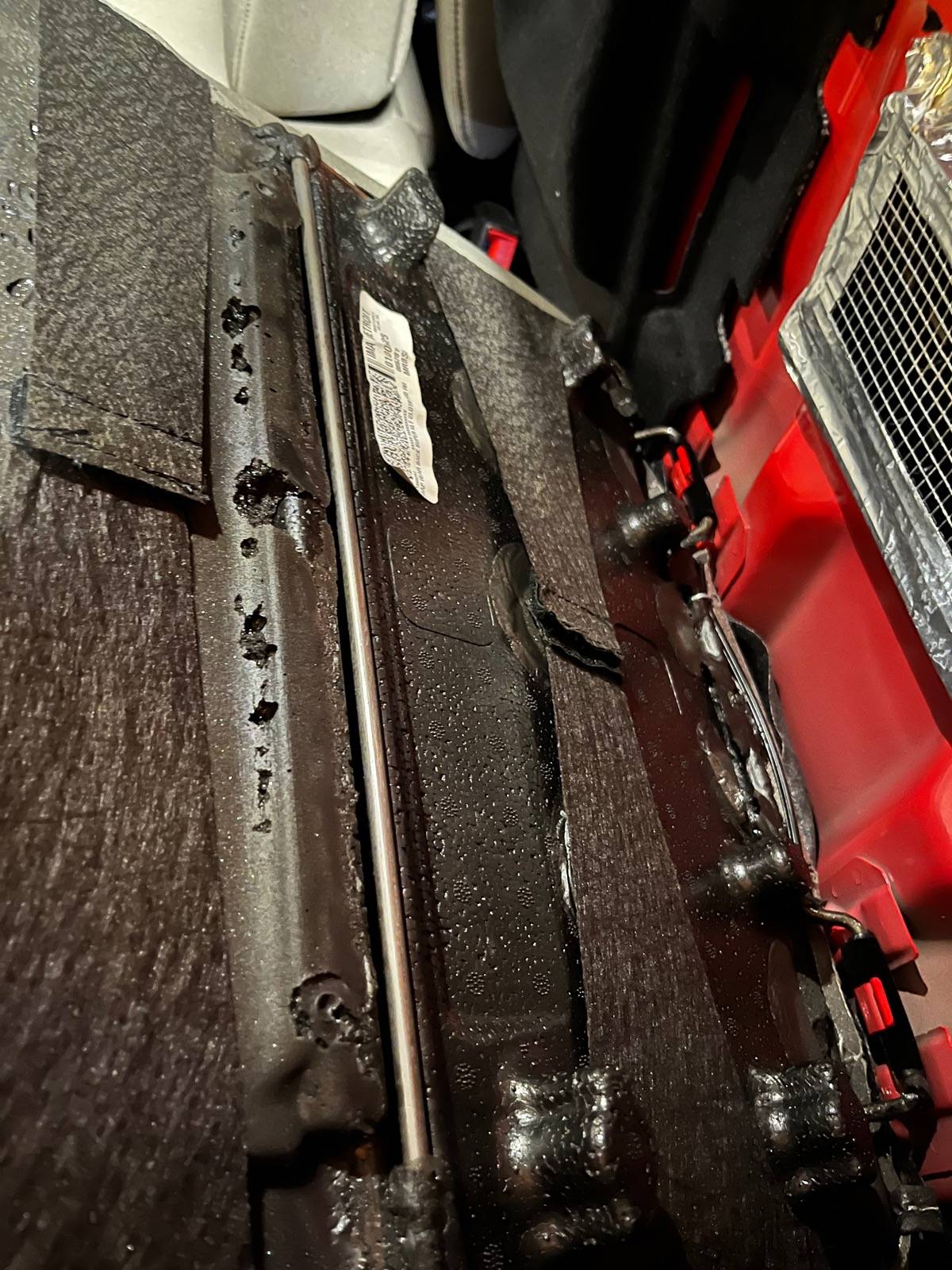

Yes. The back of the seat against the vent has chew marks all over these things that almost remind me of backer rods that are glued to the back with chunks missing at some parts. It appears to be the same material (along with the napkin) i found below the seat in the jack storage compartment. I can get a pic of it tomorrow. But as soon as I saw the chunks missing I knew that was where they had got in. There is actually a post on the maverick forum regarding the vent as well.
Ok, so we have a verified second point of entry- thanks

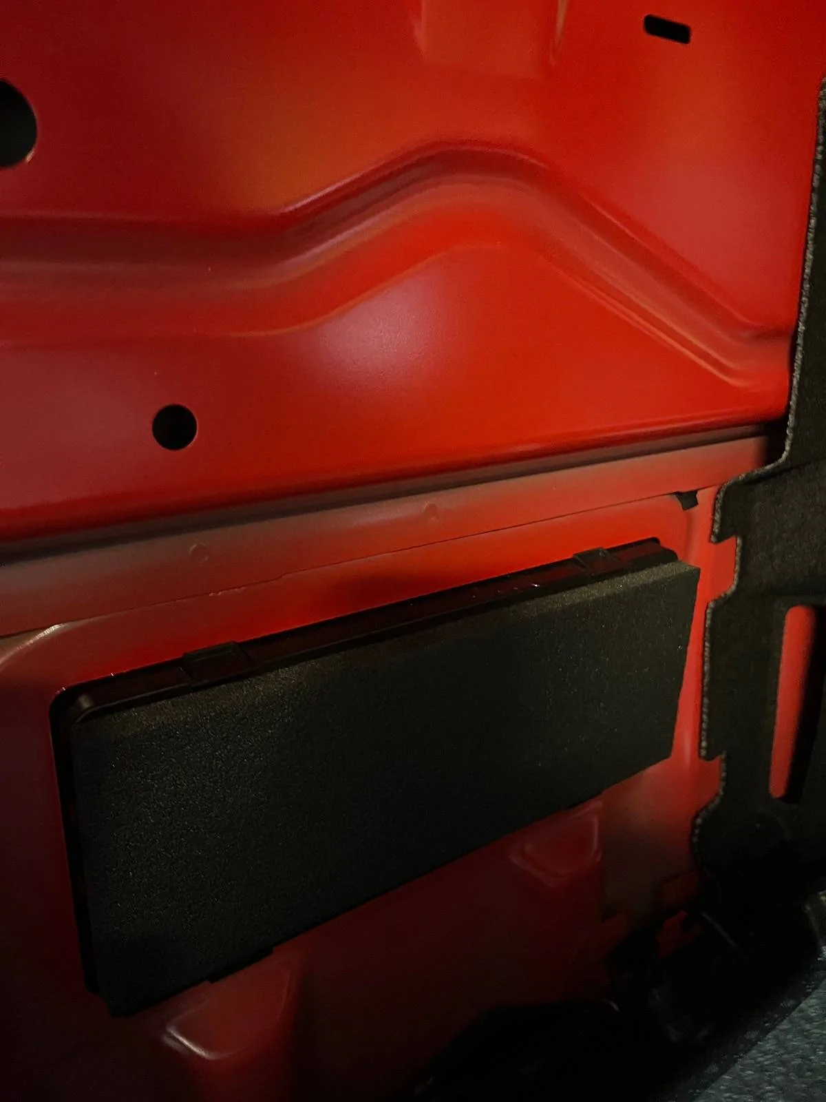

Does anyone know what this piece is for? It is glued to the passenger side vent behind rear seat and there is no evidence of any mice chunks but i would like to cover the vent with the mesh like the drivers side. Not sure if I should remove it to cover it with mesh as it is basically the same except the foam piece.

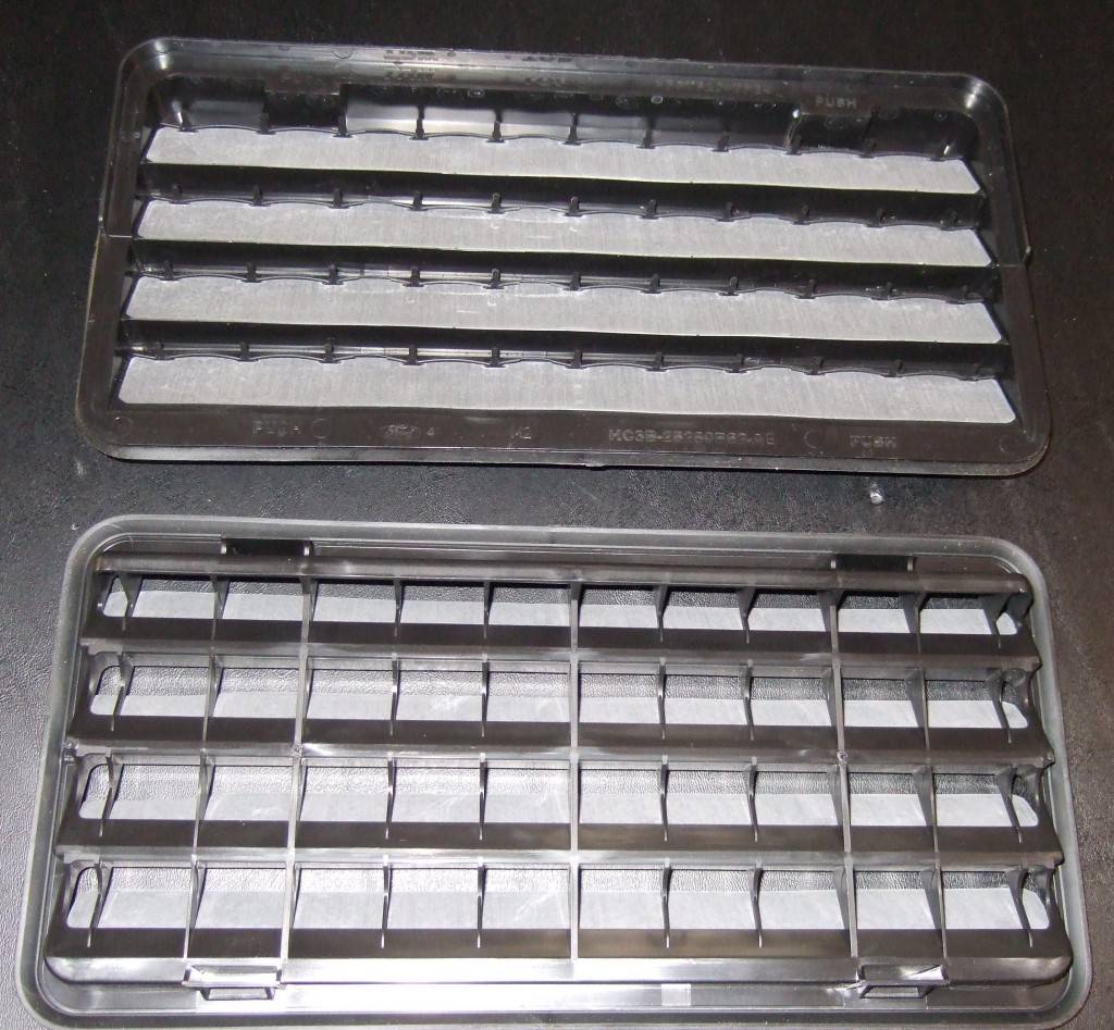

I just removed the back seat backs to take a look at how I planned to block the mice. I have two identical vents back there that open to the air! I figured the engineers would have designed a more robust vent than 2 - 11/5" x 5.5" holes in the back of the cab!
I also am wondering just how long the plastic will last before it deteriorates or becomes brittle and falls out the hole.
I removed the plastic vents in an effort to determine the cleanest way to block the mice.
They will be easy enough to reinstall. Here are the vents removed, one facing forward, and the other showing the back side.
I think I am going to experiment to see just how much of an opening is required to allow the doors to easy close. Those openings must allow road/wind noise into the cabin.
Comments before I do something stupid?
I had two identical vents in my SCAB. And you only having one makes me wonder if two are really needed.
I pryed if off a bit to take a look a couple weeks ago, There is a vent behind it. Whatever adhesive they use for that sure stays super tacky even going on three years. It’s basically the same except for that plastic/foam piece. I am still parking outside though even with all the fixes I’ve done, still nervous to park in the garage.

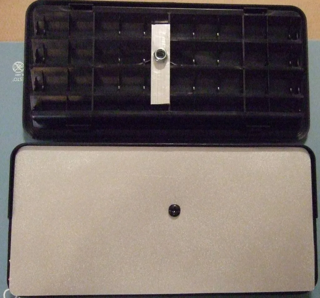

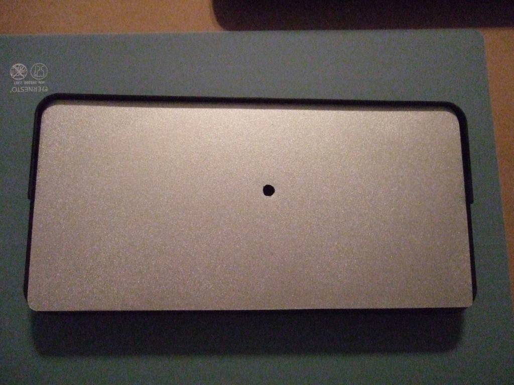

I've got the aluminum panels cut out, cleaned, degreased, and painted to match my iconic Silver SCAB, not that anyone will ever see them! I'll install the panels to the vents after dinner, then reinstall the vents in the truck later tonight.
The ingress for the mice will be closed. No more mice threats inside the truck. The traps however, stay set in the garage.
UPDATE:
Here's a picture of the plate placed in the vent checking for fitment. I will seal the edges with exterior high density double sided tape and insure it says in place with a single bolt through the center. Then replace them back in the truck. This silver side faces the exterior of the truck.
UPDATE 2:
All done! Here are the finished blocked vents. The adhesive would have probably been enough to hold the plates in place, but just to be sure I secured them with a nice powder coated black bolt. I used a 1/8" x 3/4" x 3" aluminum stock as anchor with a nylon lock nut, just snug enough to hole the plate without stressing the plastic. Time to pop them back in the truck.
We'll see how it works out over time.
