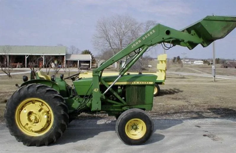

My dad taught me how to drive and stick shift on a John Deere 2020... when I was about 10 years old.
Later I drove his pick-up truck to Driver's Education classes. ?

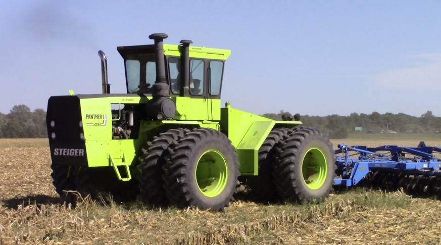

Then I moved up to a Steiger Panther III 325 which had so much power you only shifted to adjust the ground speed.
