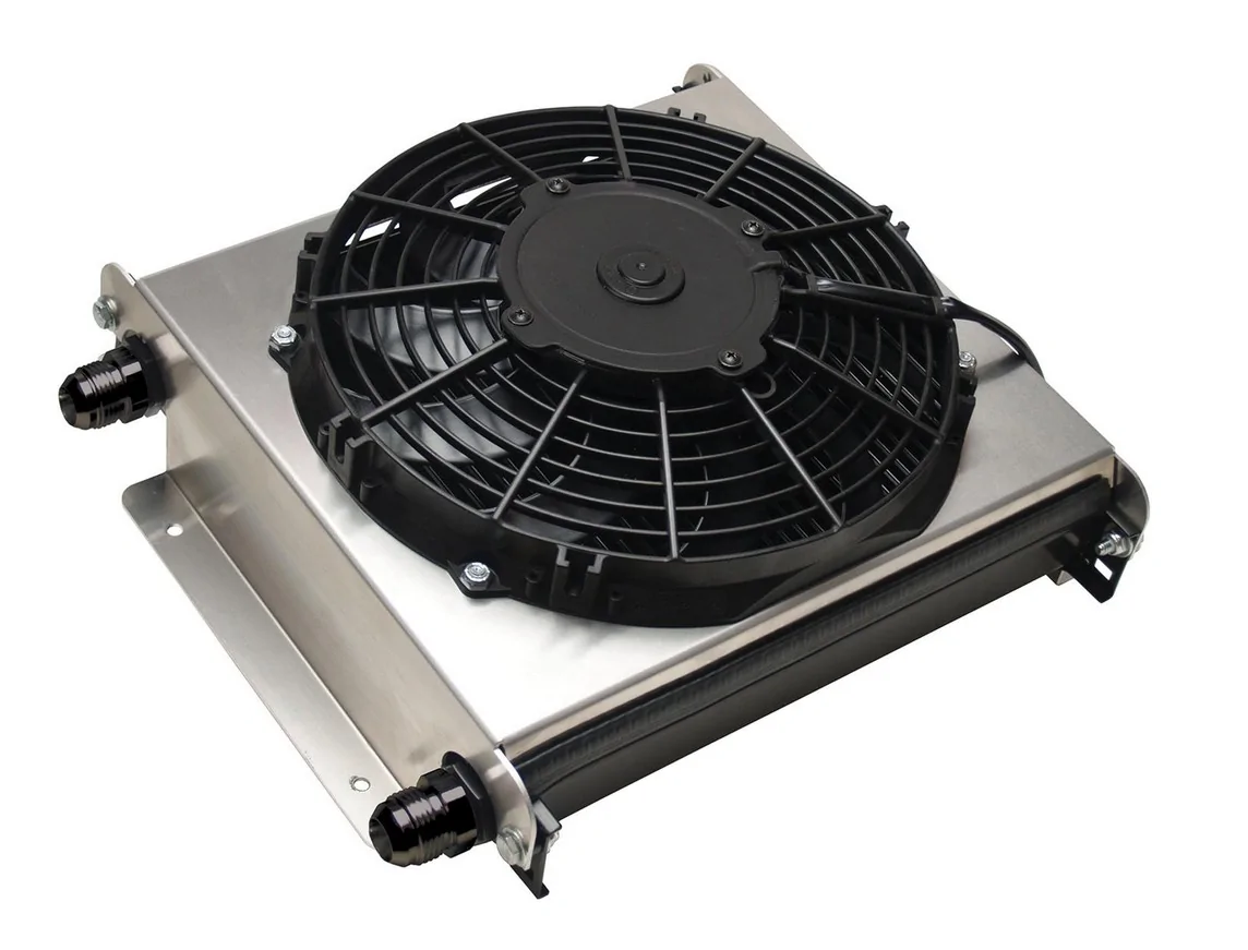

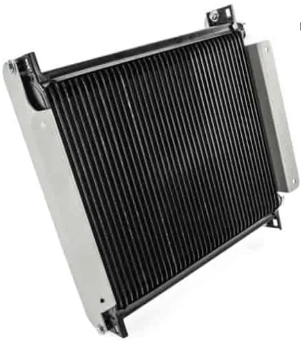

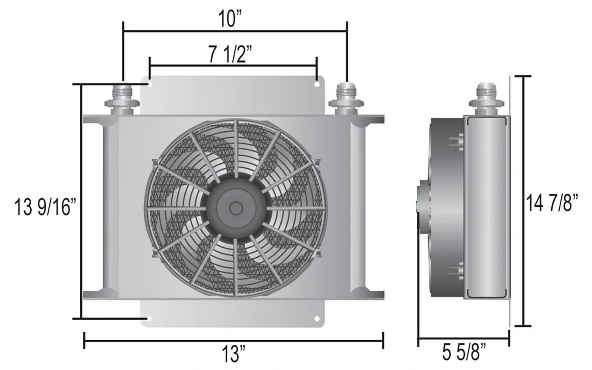

This is a Derale kit that sells for ~$500. It has outstanding reviews. The components that I purchased are identical (fan and stacked cooler) including the pressure & temp rating.
For $200 I also received a fan digital controller and transmission fluid sensor that allows me to set the fan temp range. I do have to fabricate the plenum, but I have plenty of sheet aluminum around to do that work. And now I have the design and size specs to fab up the plenum too!
I'll fab it up in cardboard, test fit, get it right, and the transfer the design to the aluminum.

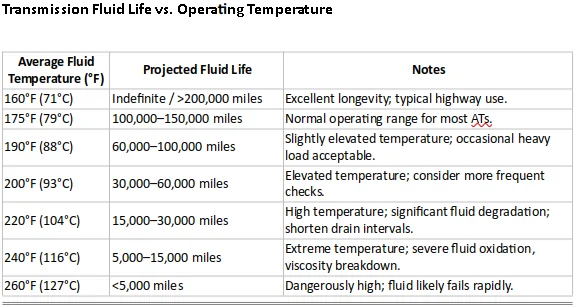

Something I probably should have put in my very first post. Here is why I'm attempting this...
Below is the industry standard chart for Transmission Fluid Life at different temperatures. The best case for our Rangers is 200F or fluid change every 30K-60K. I personally believe the chart to be optimistic.
Key Points:
  1. Mercon ULV is formulated for high efficiency, low-viscosity operation, but low viscosity also means it’s more sensitive to high temperatures.
  2. Continuous temperatures above 200°F will significantly shorten fluid life.
  3. Stop-and-go driving, towing, or hilly terrain can elevate fluid temperature and accelerate oxidation.
  4. Transmission temperature sensors can be used to monitor and manage life.

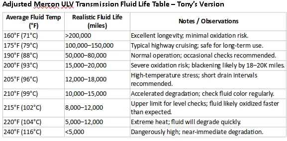

Here is my version of the chart based upon a sample size of 1, Me! I think this is a closer real world representation. This is why I am aiming at the 150F - 160F target range. It is optimal. I feel it when I drive the truck and the fluid is in this range. And both charts prove fluid life is longest at this temperature range.
The primary reason for the digital temperature fan controller is to allow me to reach the 160F goal.
With fluid at the sweet spot of 160F, there is the possibility of moisture build up over time, esp in hot humid climates. The secondary reason is to control the possible moisture build up by occasionally burning off the water vapor by temporarily raising fluid temps.

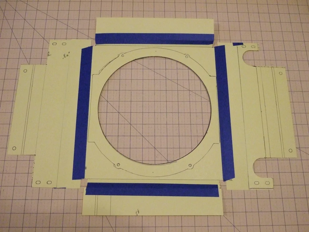

A quick update. Waiting for a few stainless steel rev nuts (Push Nuts) to arrive. In the mean time I completed and test fitted the plenum for the trans cooler / fan assemble. Did the math for most effective cooling depth for the plenum, going with puller fan positioned 1.5" above the cooler , with `1.5" clearance in the intake side. Here's the first mock up. Optimized the fan flow with correct radius opening. Will have 2"-3" clearance above the fan for exhaust. The plan is to complete the assembly and test fit / mount it to an added skid plate in front the gas tank. If that all goes well, it will be time to fabricate the AN8 hoses and run the lines from the transmission to the cooler. Test for any leaks. The wire up fan controller
The plenum will be made formed from sheet aluminum. The mounting point are built into the plenum, see left and right side mounting holes, Cooler ports on the right side.
I've got to dig around my garage to find and cut the aluminum, then transfer the pattern and begin to make the necessary bends. It is starting to come into focus.

Looks good so far, nice design but I thought the fan kit from derale in post 33 had what was needed?
The Derale is a very good unit, but more than double the cost, at $500-$600 depending on where you source it.
It is also compact at the expense of efficiency. It sits a bit low for air intake, and has very little plenum space, the fan is mounted too close to the cooler for optimal cooling. It also did not come with the digital fan controller.
I picked up the identical fan and cooler, plus the digital controller (with excellent quality relays) for 35% of the cost of the Derale unit - ($199).
The downside (there is ALWAYS a downside) is that I do have to fabricate the plenum. I borrowed from the design of the Derale unit, and raised the cooler up 1" for better air intake (from .5" to 1.5"), and tripled the plenum space from .5" to 1.5". Those changes insure air flow will be uniform across the entire cooler surface, but increases the package height size from `5.5" to 7.5". The sweet spot for both is 1.25" - 1.5". I also optimized the fan diameter opening in the plenum. I have no idea what the Derale unit diameter is, but based upon the fan blade diameter of 10", the diameter of the opening should be in 9.125". This keeps turbulence to a minimum... increasing airflow.
Having said the above, this is a bit of an experiment. I'm flying blind until I see results. My objective is maximize cooler ability so that is controllable by the fan runtime. I can then use fan cycle time to adjust the temperature window to the optimal target range of 150F-160F. Hopefully the fan duty cycle won't be 100%, much like the radiator cooling fan.
