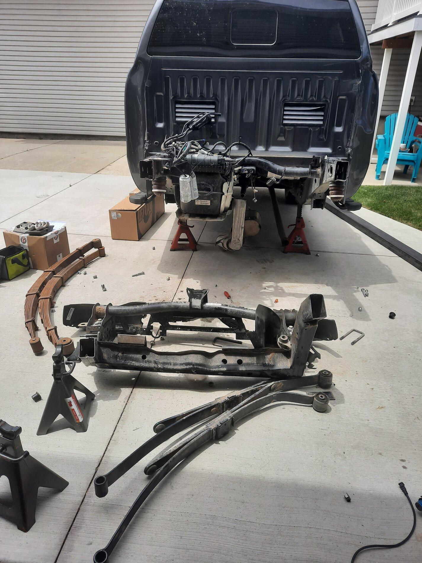

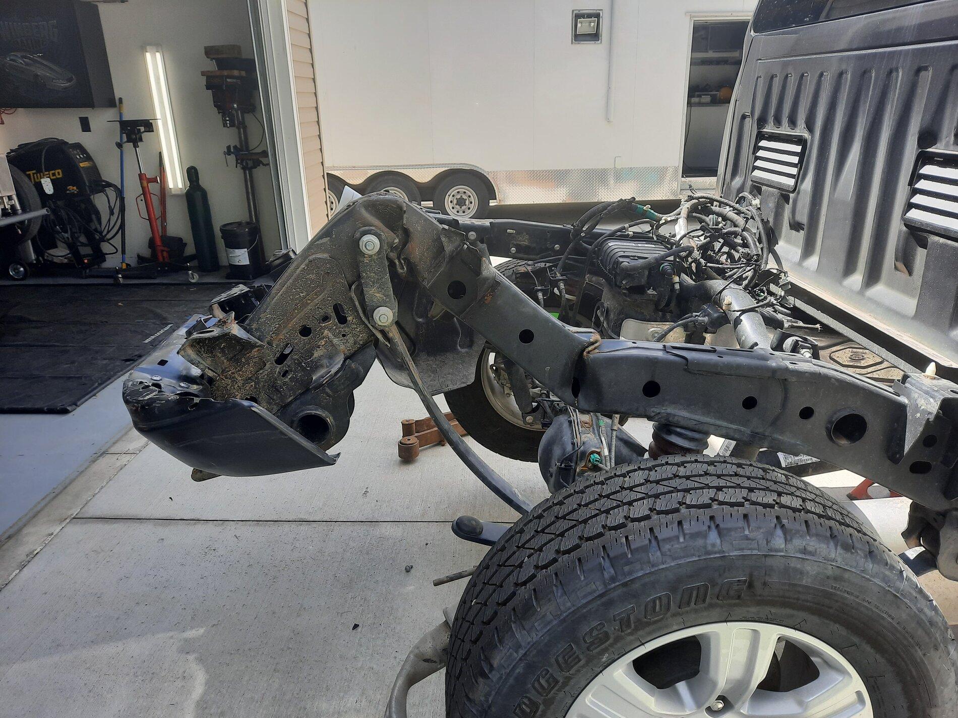

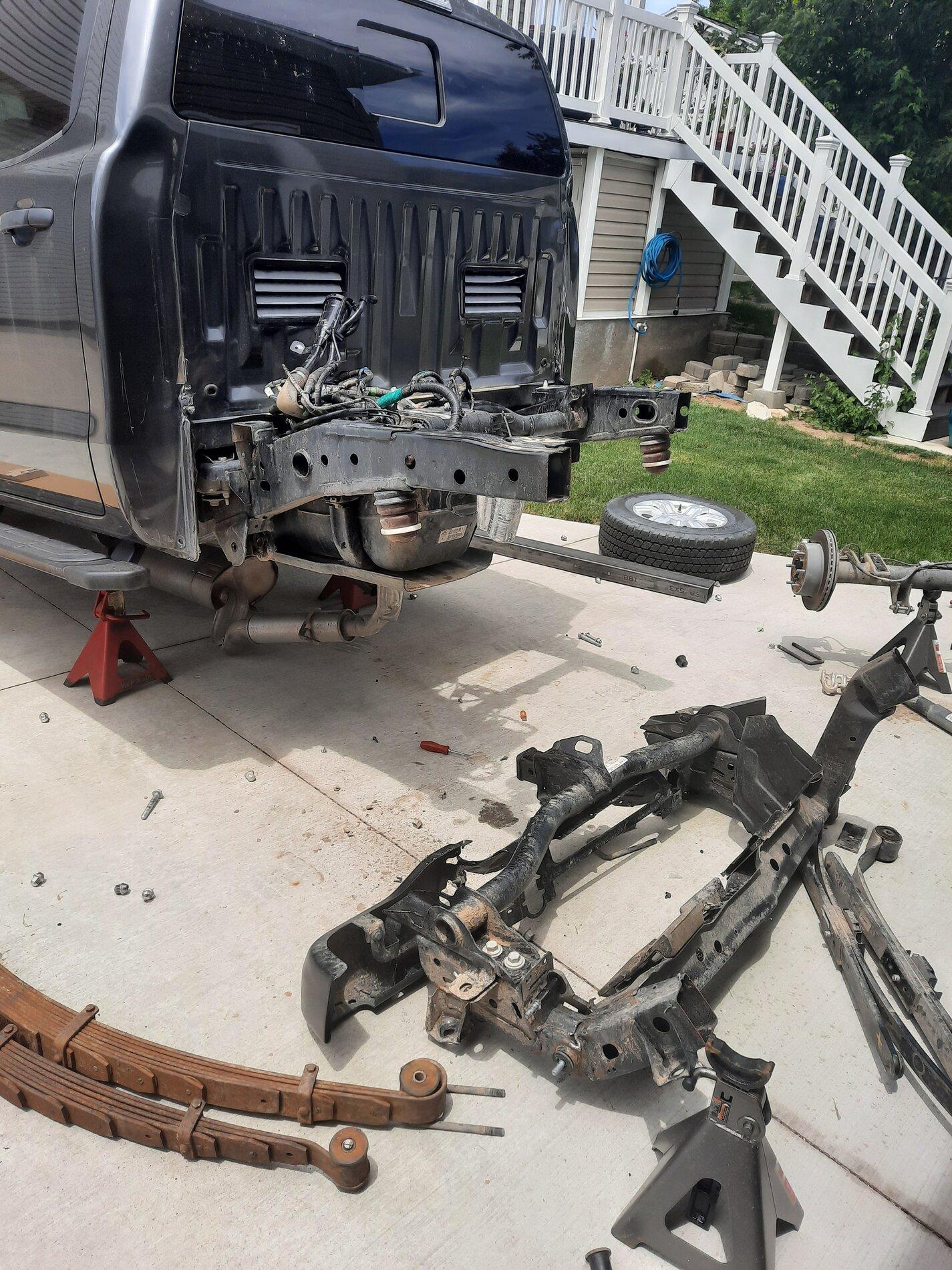

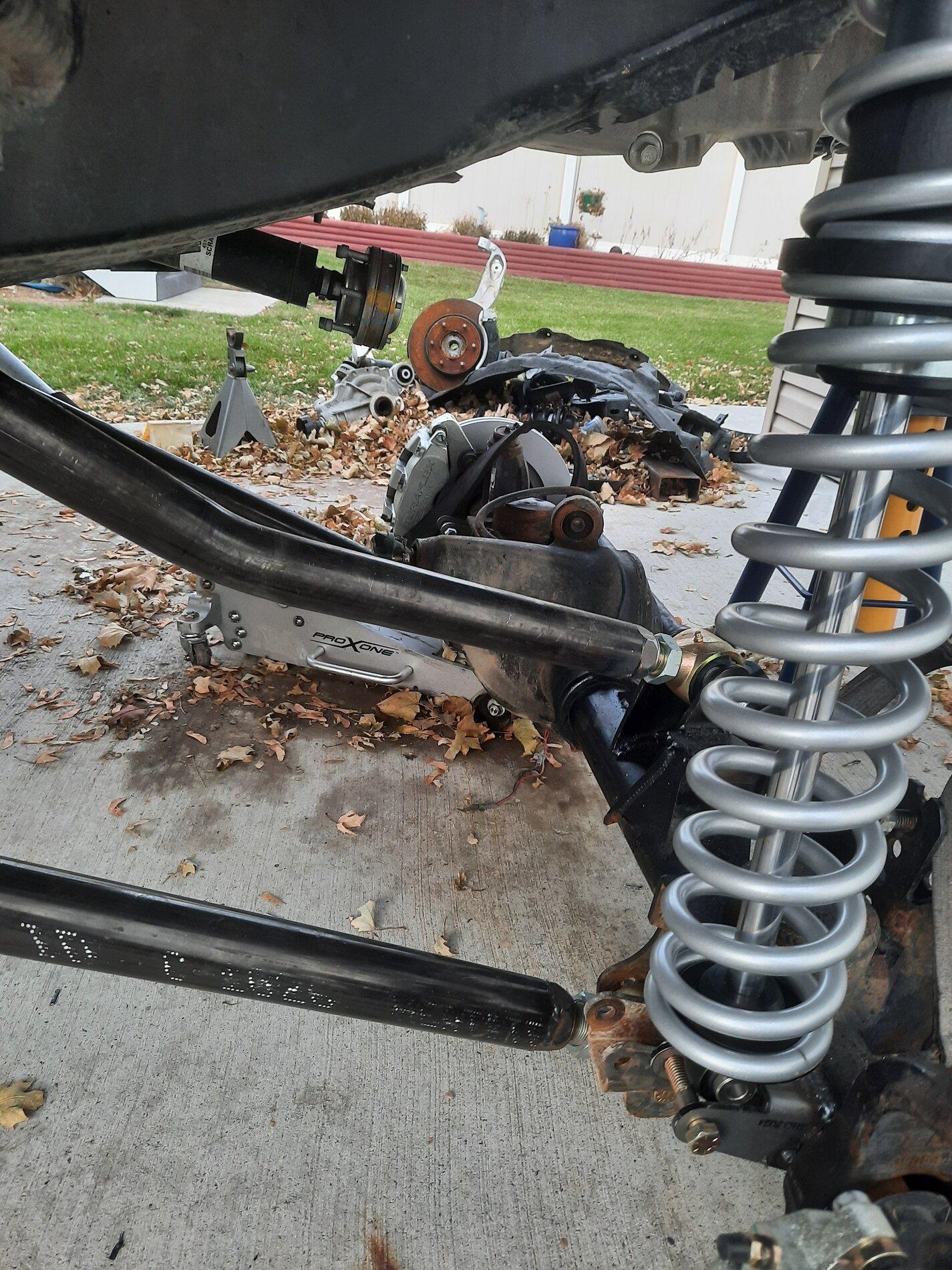

I've been working on this project in my spare time the last several months. Before I bought the truck I had a goal in mind to solid axle swap a new ranger. I bought the truck with 3890 miles on it as a salvage vehicle. The rear frame, bed, and suspension were pretty hammered. Engine, transmission, and everything from the cab forward was in great shape, no airbags were deployed.

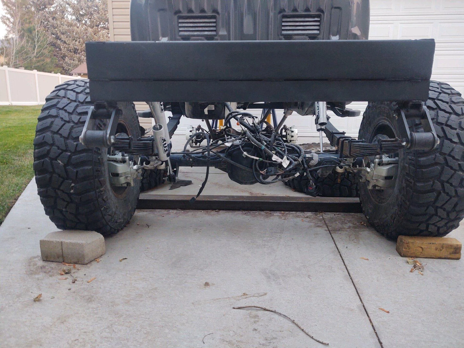

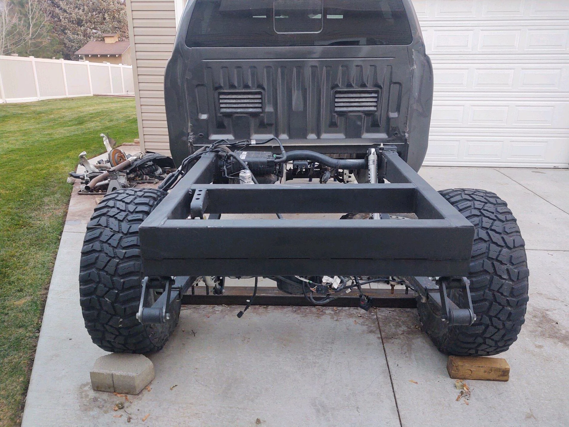

I kept the overall frame length about the same, but pushed the rear axle back by using 64" Deaver springs made for desert racing. They were on the rear of my previous sas 2004 ranger and worked amazing on and off road.

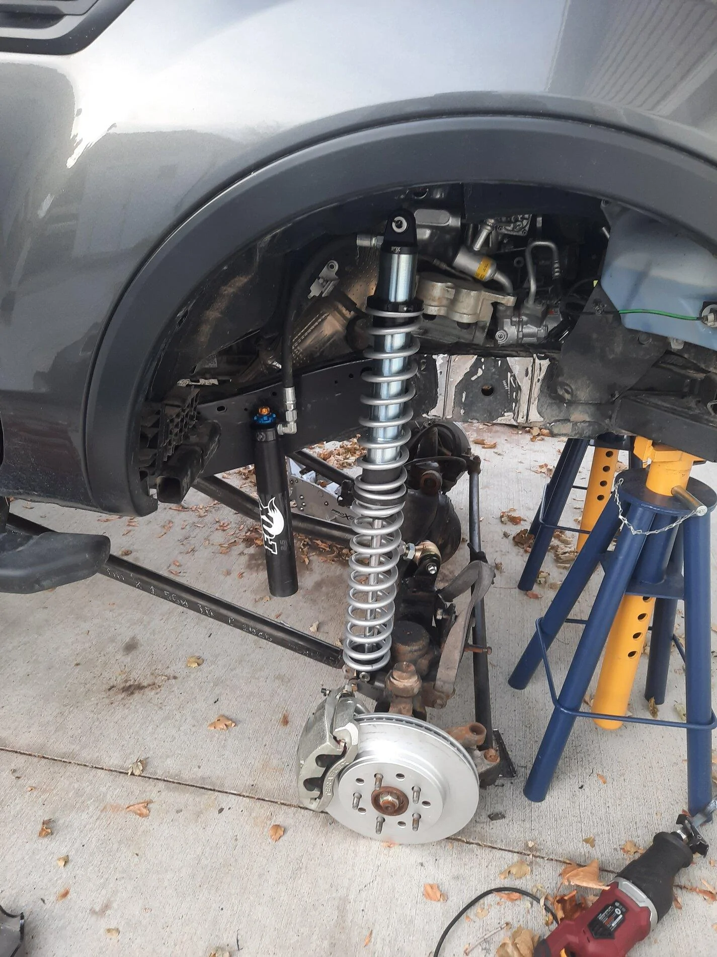

The overall plan is 3 link front w/panhard, jk steering box from PSC, along with a PSC hydro assist kit, psc power steering pump (still trying to figure out how to mount the pump on the engine), fox coilover, tera44 front axle made for a jk (have from previous ranger sas) 37s (maybe bigger?) Aluminum flat/offroad bed, sliders, bumper with winch, and more.

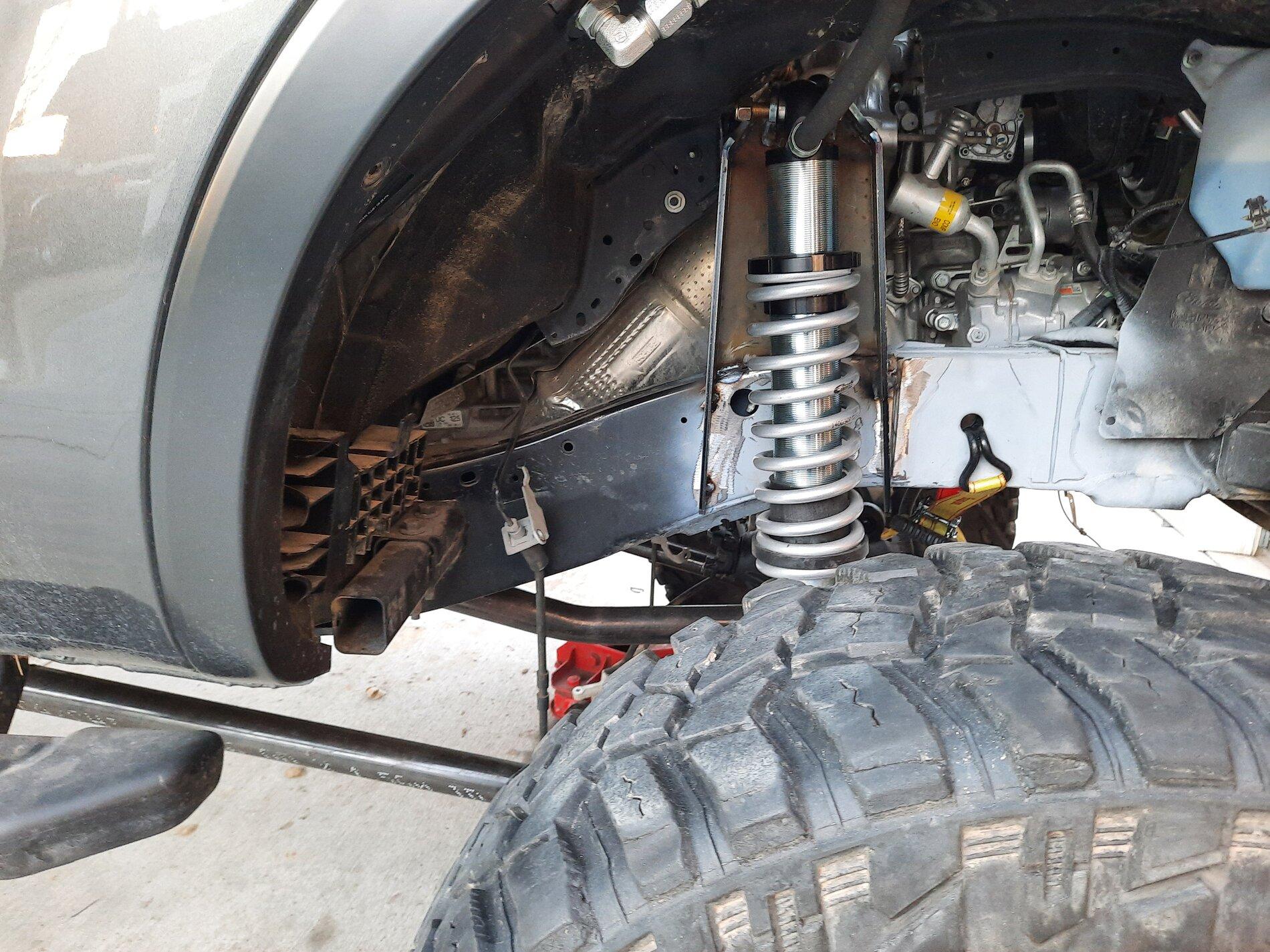

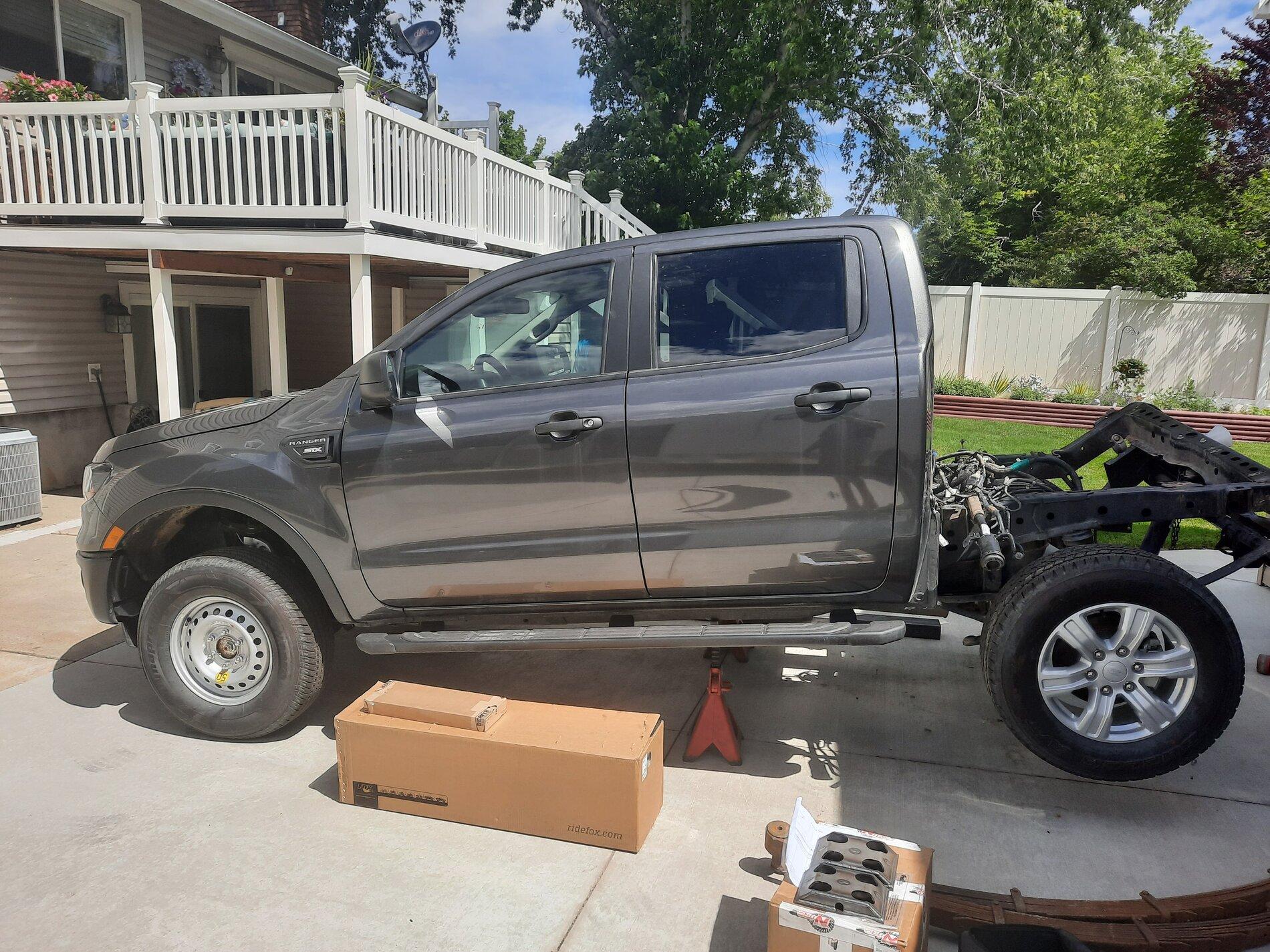

This is where the project currently sits, all the ifs has been completely removed, 3 link mounts on frame, coilover towers on frame, steering gear box mount in place (waiting for psc box to show) truck sitting on its own weight at the moment.

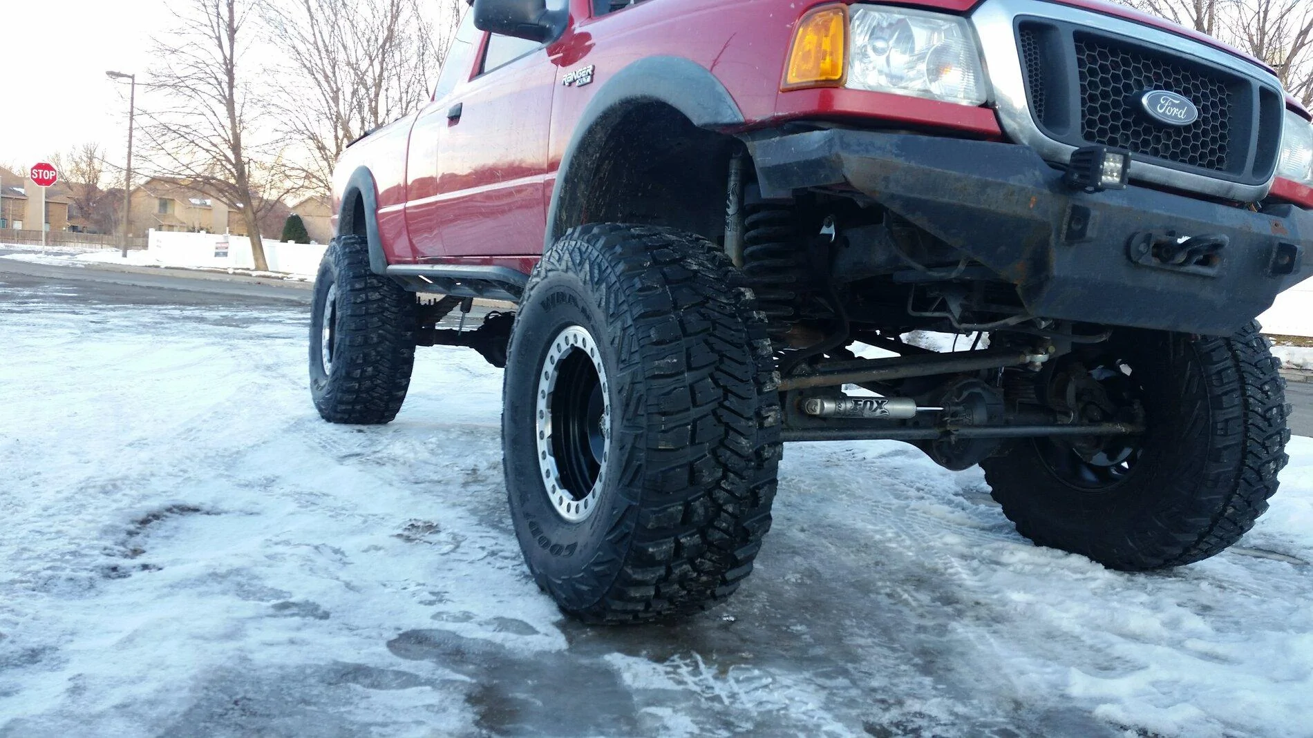

Here is a picture of my old sas Ranger.
