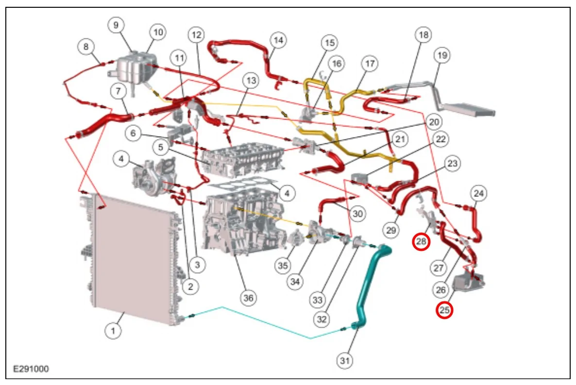

The diagram below is the 5G cooling system pulled directly from the Service Manual
Item 25 is the Transmission Oil Cooler
Item 28 is the Transmission Cooler Control Valve
Item 6 is the EGR Cooler
Coolant flows out of the EGR Cooler across the back of the engine down to the input of the Transmission Cooler Control Valve (the center port). Above 195F coolant flows out the Transmission cooler inlet hose (27), exits the Transmission cooler via the Transmission Outlet Hose (26) up to the Engine Oil Cooler (22).
I'll be removing the Transmission Cooler completely, replacing it with an adapter plate with a pair of AN8 fittings. I'll remove all hoses from the Transmission Control Valve and cap them. The Control Valve will stay in position and remain electrically connected.
It appears that the EGR Cooler Outlet Hose (14) can be connected directly to the inlet port of the Engine Oil Cooler (22), eliminating all the downstream hoses. I will validate once I begin the work.
Anyone see any issues with this thought process?

My only thoughts are
1. I think it would be better to (Loop) the valve and leave some coolant inside, to protect the internals of the valve (seals etc) from drying out as electrically it will still be operational and loop it so it can still move fluid as the valve opens and closes vs capped dead end pressure changes as the valve opens and closes.
2. Bypass straight to the (Eng Oil Cooler), may provide slightly higher oil temps (engine coolant temps) as you are removing some restriction of flow, so it may flow faster through the cooler and lower its effectiveness. ---Just an outside the box thought, how much if any notable difference (IDK)
3. Since you are focused on (Transmission Cooling) and the secondary function of the valve is to provide heat to the transmission - how much does it actually contribute? during the cold start process - you may note a longer warm up time for the transmission.
Now you have been monitoring (deeper) than I have, in fact I have not had time to dive deep into the operating aspects yet
TJC
Aug 28, 2020
46
3,978
10,030
Thanks for the feedback.
1) I'll investigate the valve design to determine the mechanics of it. I don't need it failing prematurely. I'll probably cap it with coolant fluid inside just in case..
2) It's an interesting point made. I'd considered the opposite effect. Less heat from transmission fluid, and faster fluid flow means coolant should complete the circuit faster and be cooler, but I can easily seeing it go the other way. I'm sure there is an optimal coolant speed.
3)I've tested Transmission Fluid warmup times at idle and documented it up to 180F. Almost 39 minutes to reach 180F. I drove 40 miles with a 15 minute stop at 20 miles. Transmission temps never exceeded 185F. But in stop and go traffic and long lights I see it go up faster due to torque converter slip. I start to see ever so slightly rougher shifts above 170F. By 200F they are not severe. but not as smooth as 150F - 165F, where the transmission is silky smooth.
Thank you again. I appreciate your thoughts.

All this nonsense in the diagram makes a 7 speed conversion seem like a pain. This looks worse than the smog pump nonsense on old 5.0s.
Good luck and I hope it works well. I would not be against loosing a few hundred feet of hoses under the truck.
TJC
Aug 28, 2020
46
3,978
10,030
Yeah, an EGR cooler, an engine oil cooler and a transmission fluid "heat exchanger", all in a (almost) Christmas tree light strand configuration. That's elegant engineering! :facepalm:
