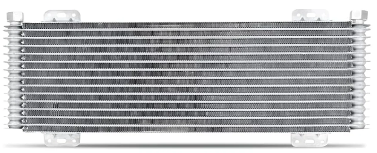

Here are the two coolers that I have purchased for this project.
This is the first, purchased thinking there was more space behind the grill than I found.
It will find a home in my 2005 Ranger protecting it's new Jasper remanufactured 5R55E transmission. It's a 30 row 12" x 10" x 2" design.

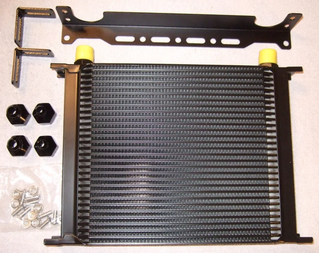

This one is a 13-Row Stacked Plate, 22.85" X 7.10” X 1.25” Core. It is what is going into my 2020 Ranger.
This one went back, and was replaced with a 40 row Stacked cooler much like the one above, just taller.

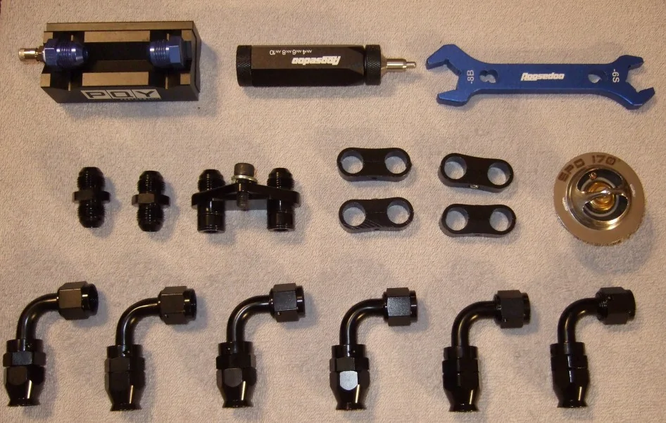

Some of the bits and pieces that I have collected before starting

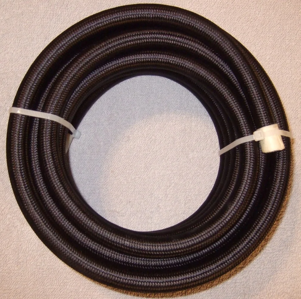

20' of AN8 PTFE hose
