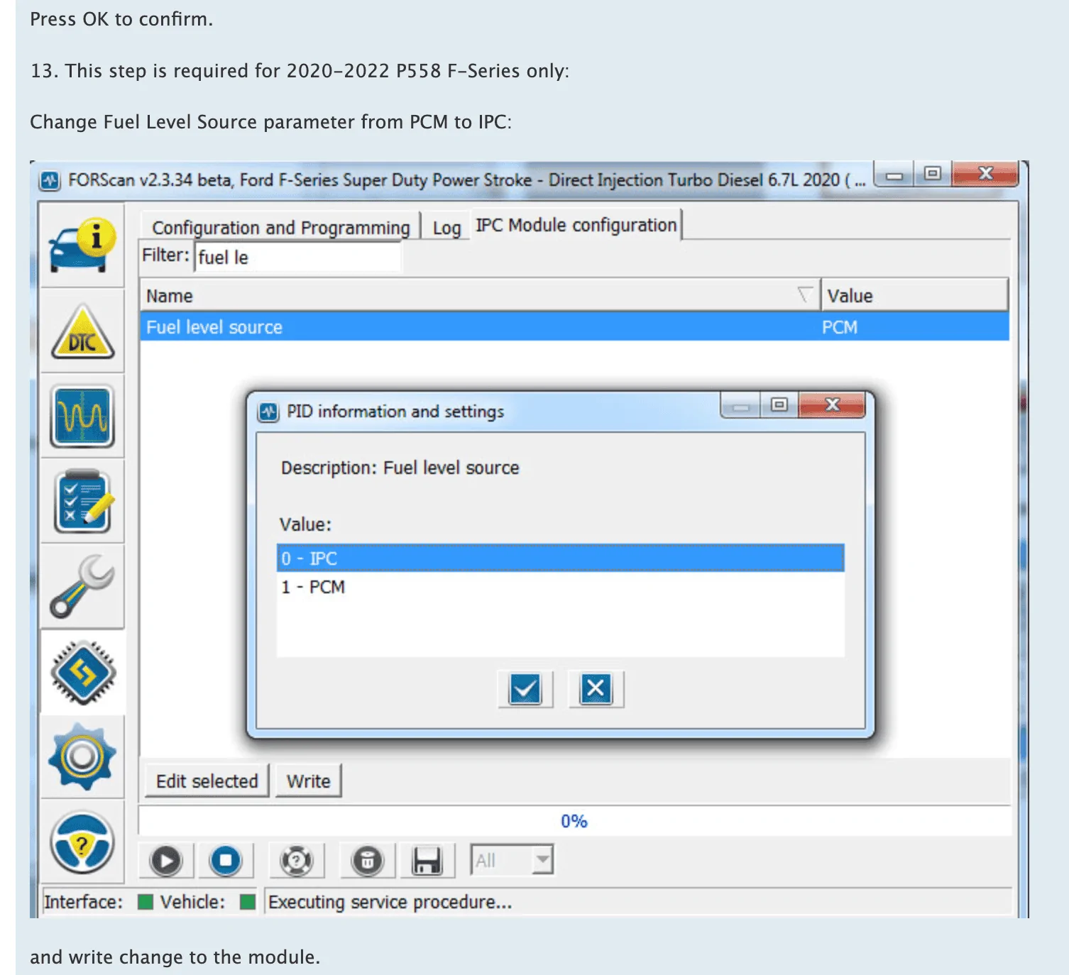

I did not. That wasn't mentioned in the steps I followed to change the tank size.
https://forscan.org/forum/viewtopic.php?t=14698
The link you posted is where I took the screenshot from... It says F series only, but I wasn't sure if that was outdated. I will continue to see if the gauge starts to read. I am going to check it in Forscan tonight too, just to make sure I didn't enter something incorrectly.

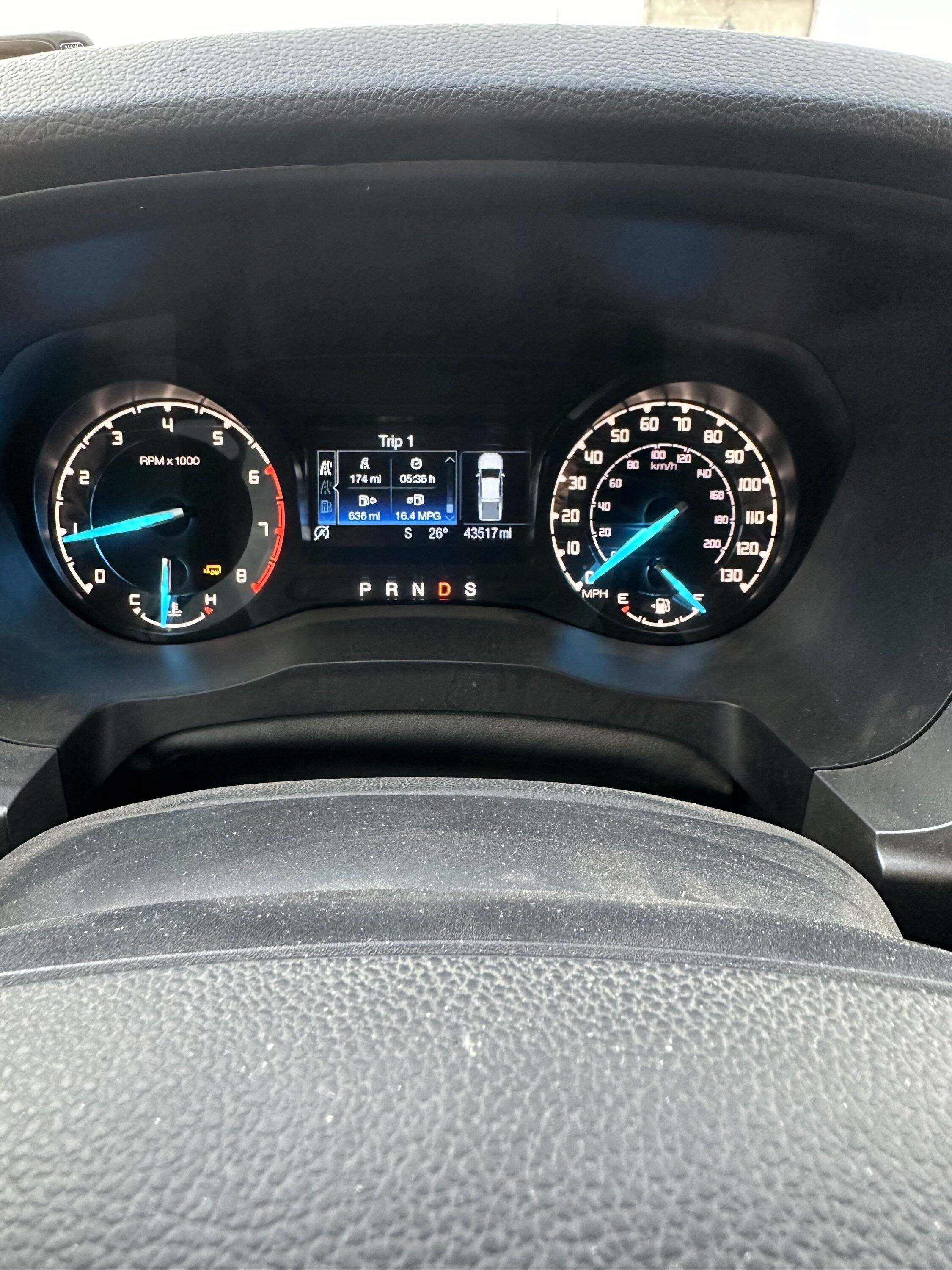

I was scared my gauge wasn't working, but then it finally got low enough to start reading. There is a lot of fuel that is above the sending unit. So it takes a few miles to get it down to a readable level.
The top half of the tank definitely lasts longer than the bottom half.
That's good to know. Thank you! I know we were careful with the float and the pump, so I can't imagine we damaged it, but I don't want to just... not pay attention to it.
I hooked up my laptop and checked FORscan at least 6 times to see if I had entered everything correctly and to see if it was throwing any codes. I was hard to trust it was reading correctly.
Glad to know I am not alone.
