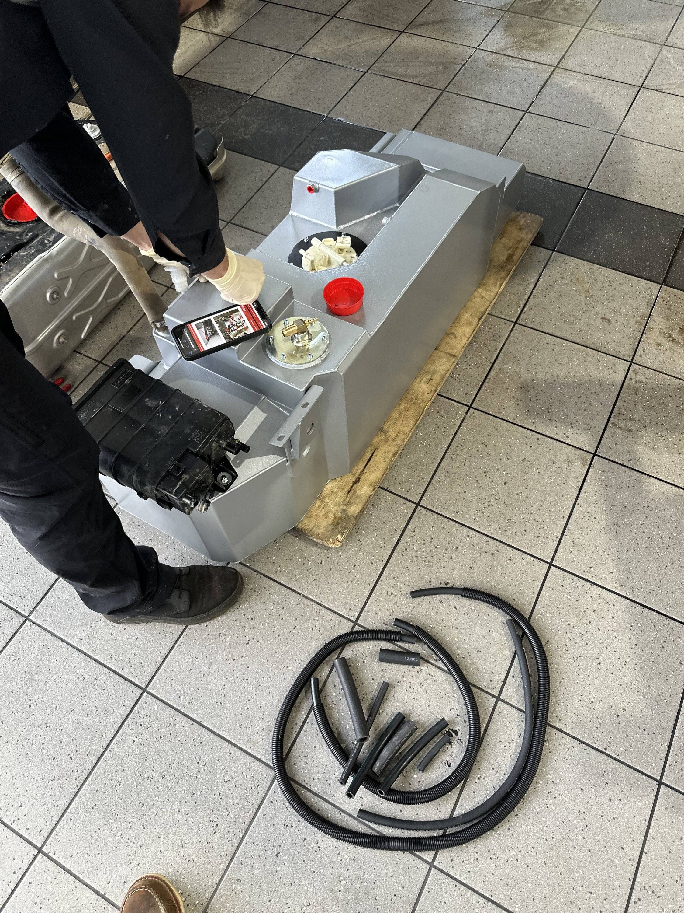

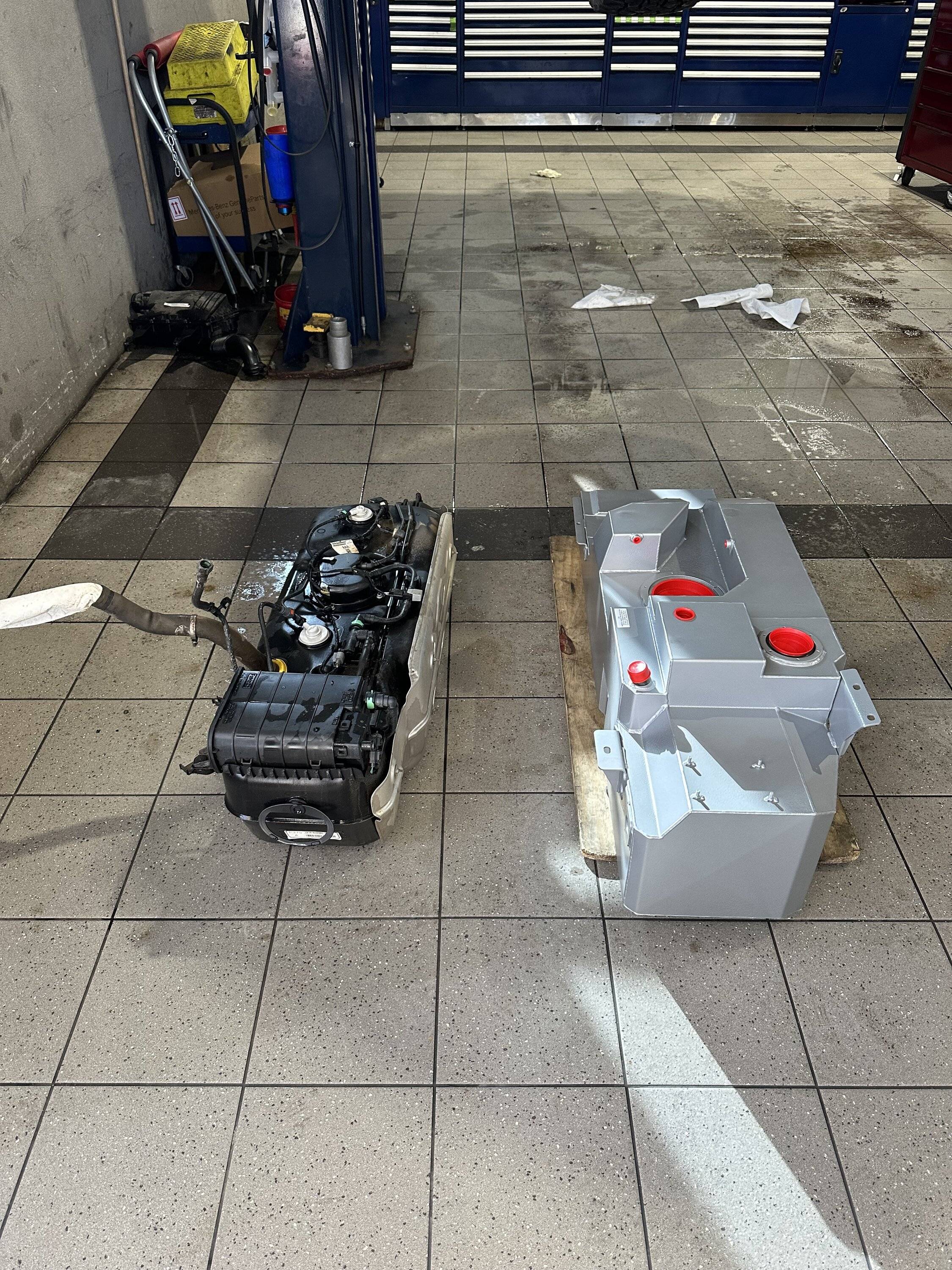

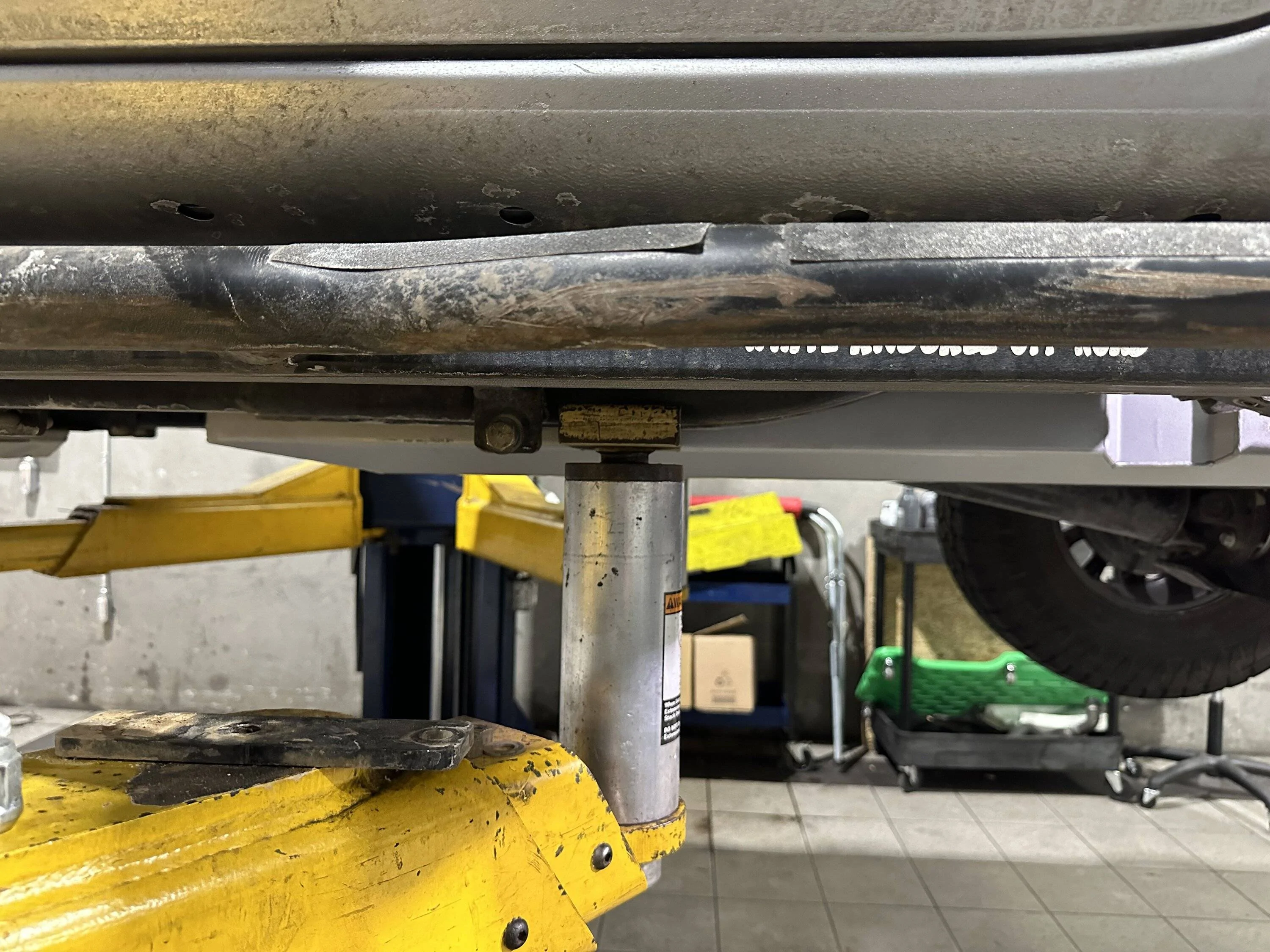

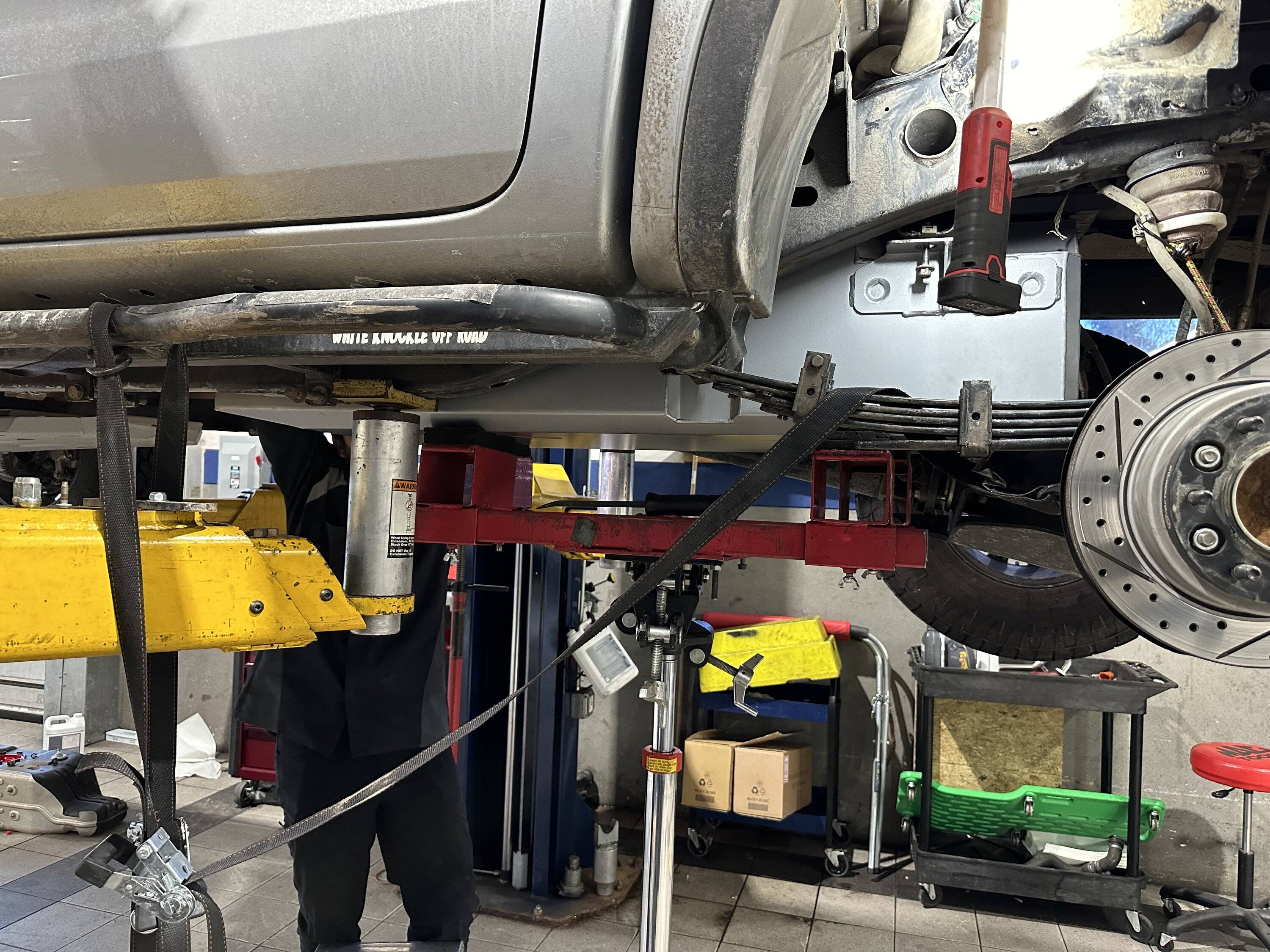

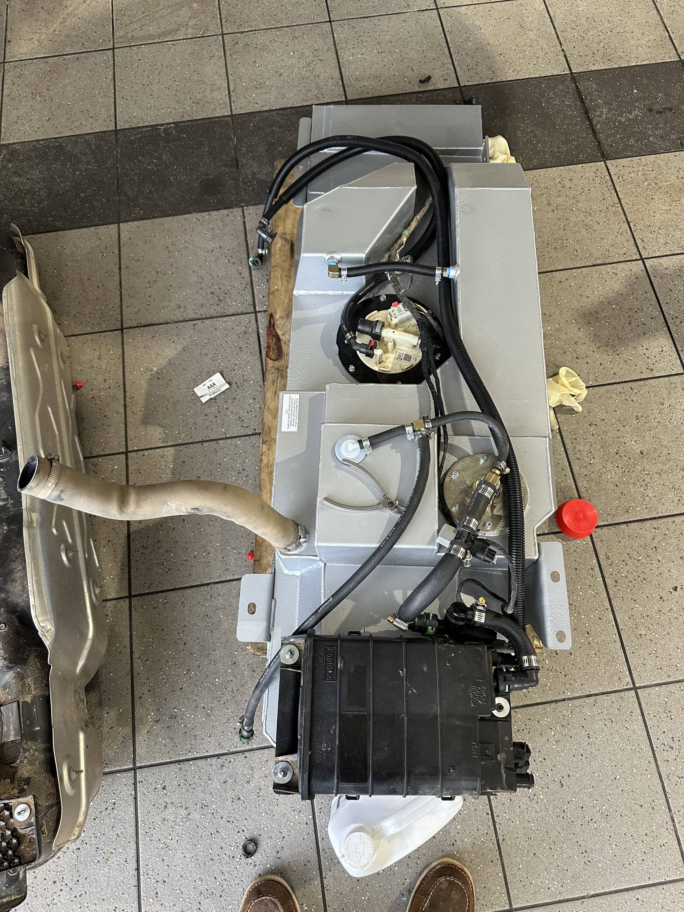

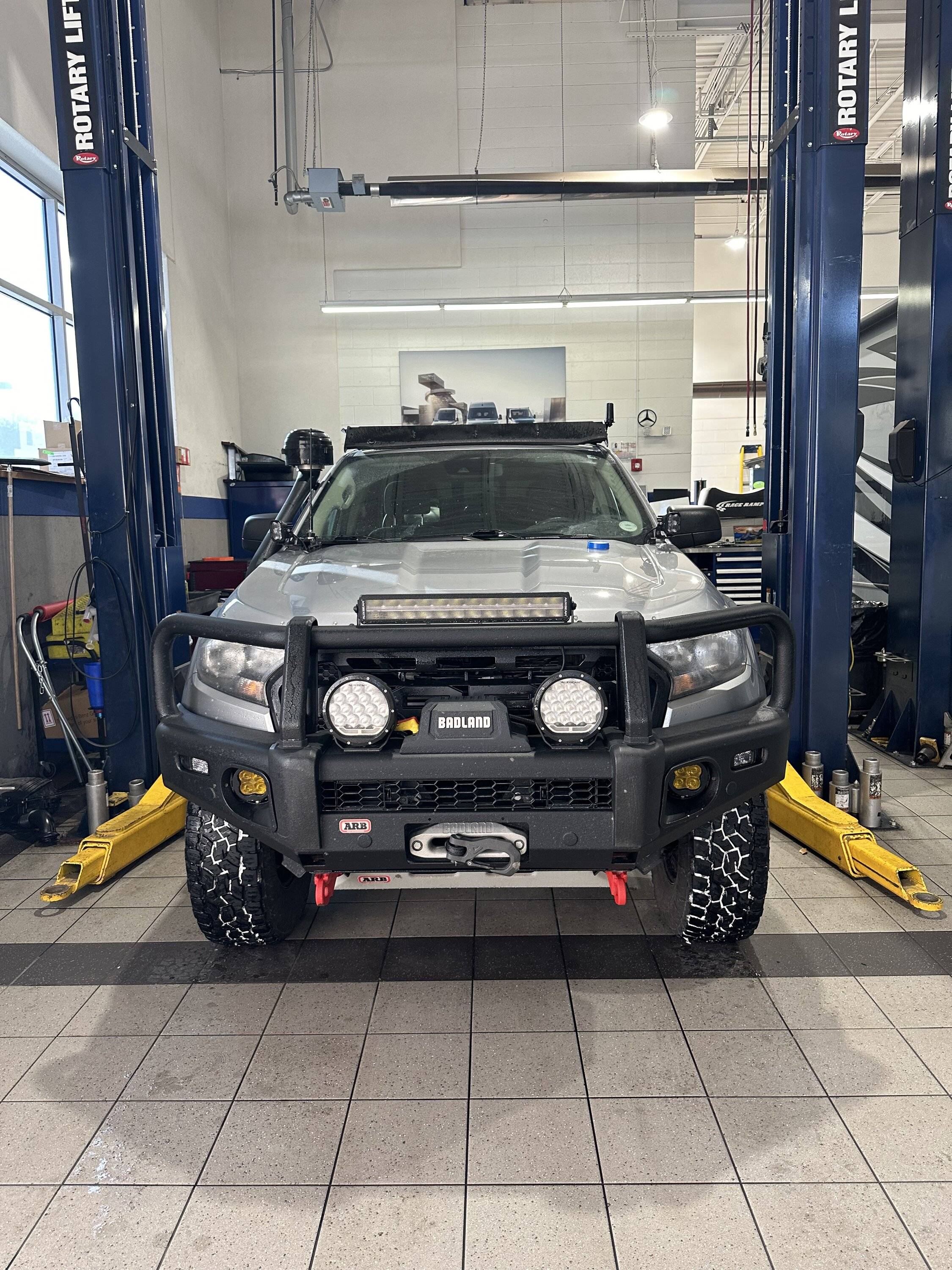

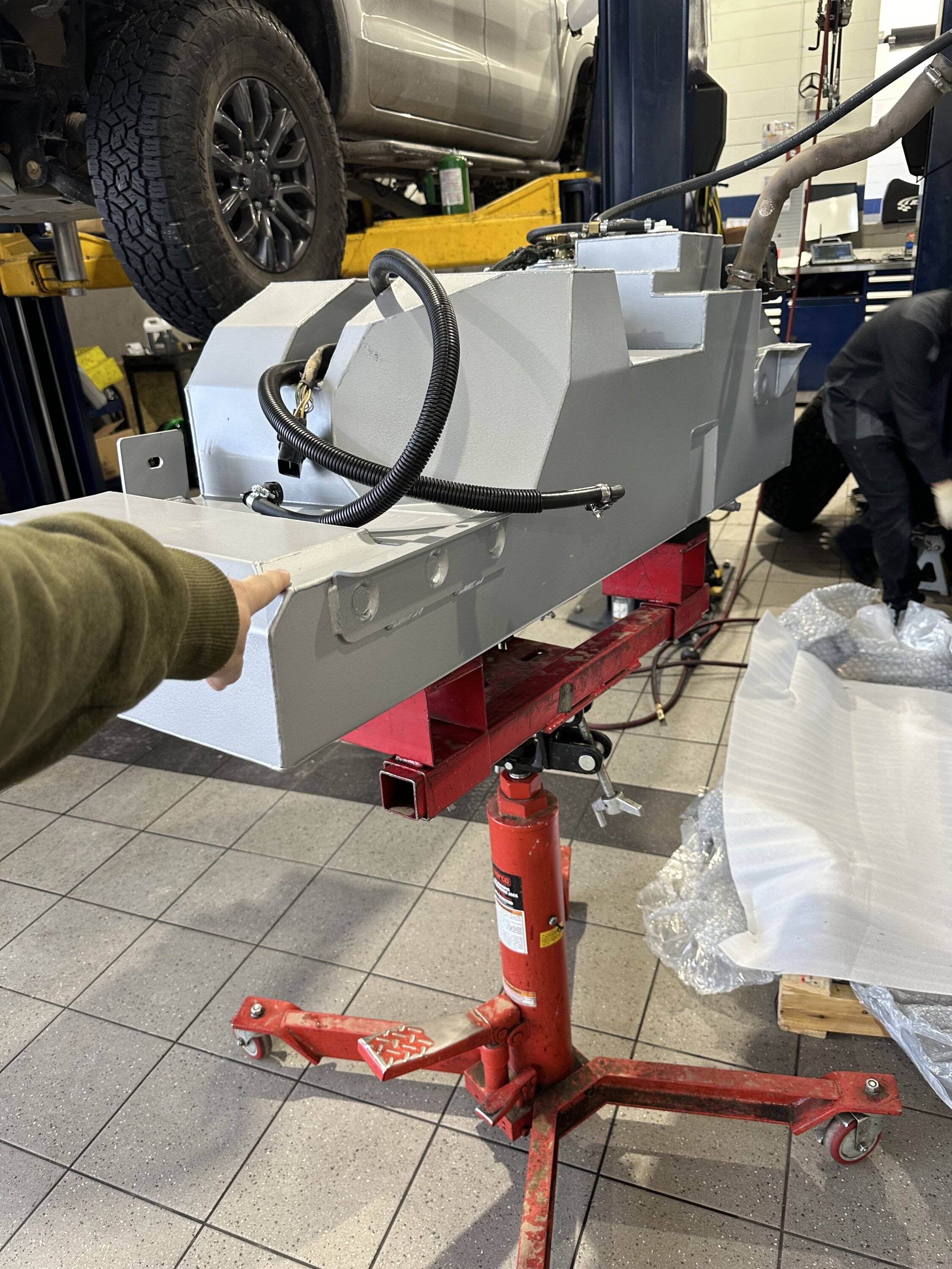

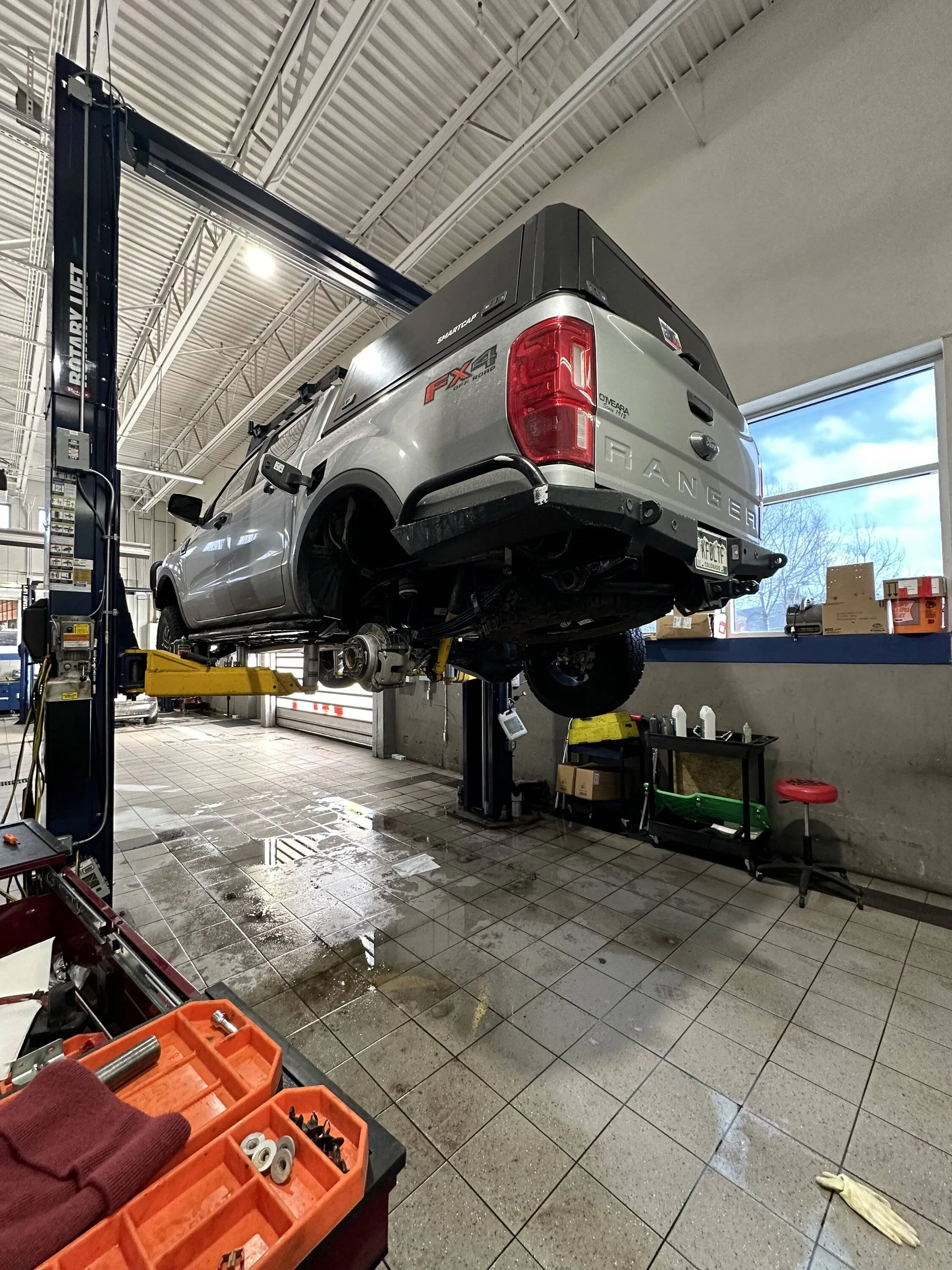

I am lucky enough to know people because of my Ranger. A buddy works for Mercedes and was able to get me in to his shop for my Long Range America Tank installation.
For how much this tank costs, the install directions should have been much, much better. None of the hoses were labeled like they should have been and you only get 3 pictures to go off. This was actually the hardest part of the installation.

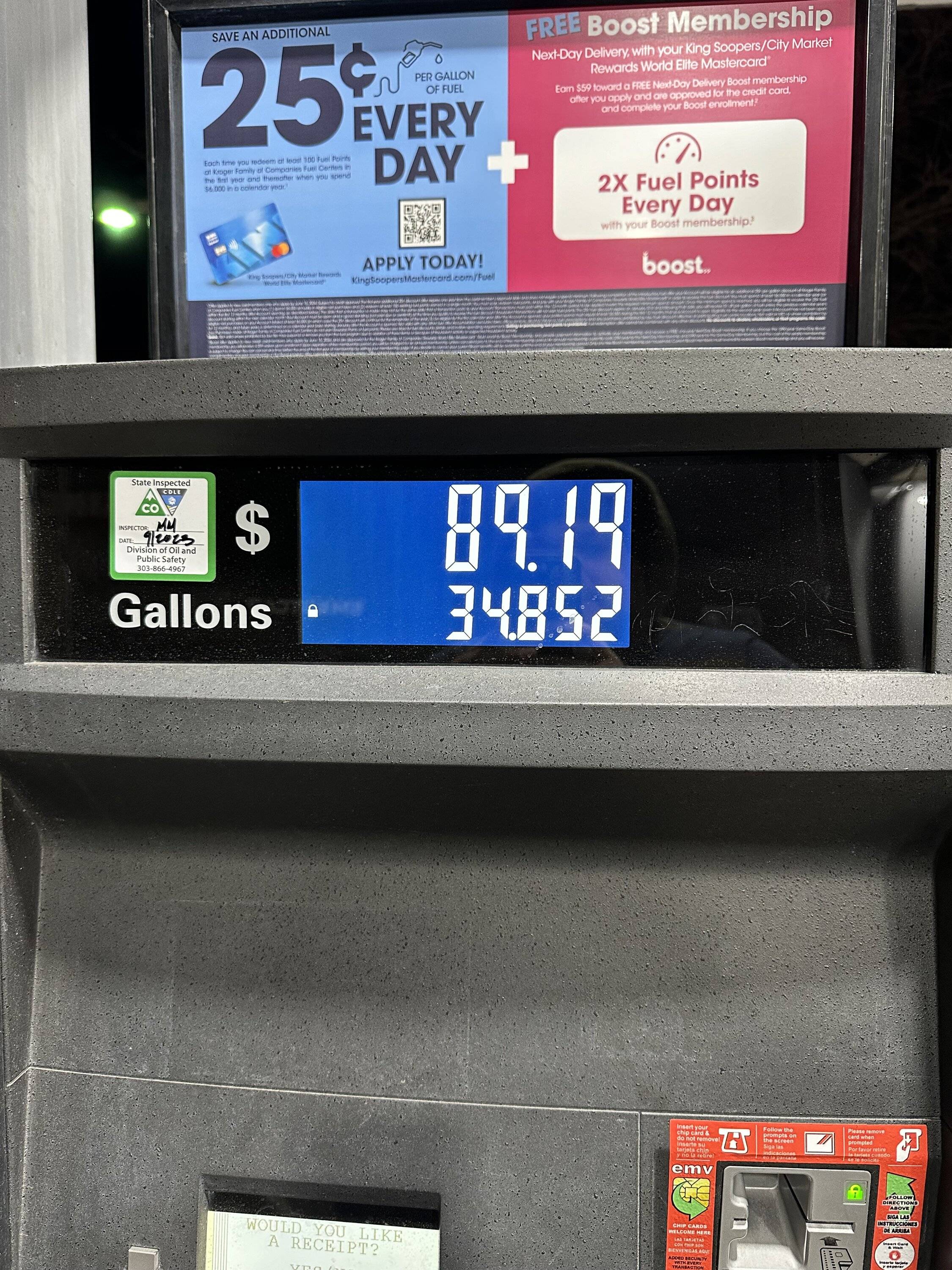

We pumped over the remaining fuel from my OE tank and then headed straight for the gas station. (Ignore the price, I got 50 cents off per gallon)
Showing approximately 800 miles per tank, since I've driven about 70 miles since I filled up.
Lucky you have access to a lift and shop. Thanks for the pictures should help with my installation.
A question about how low it hangs below frame rails? Before I install mine I plan having the exterior bottom portion covered in a spray on bed liner material to help with protection on trial from possible puncture. Not sure if it will really help but I don’t think it could hurt.

I posted a couple pictures on page 6 of this thread, comment #83.
My tank sits about 1 5/8" below the frame, and about 1/4" below the transfer case skid.
Yup, it sits below the frame, but I have the ARB skids and it doesn't sit lower than they do.

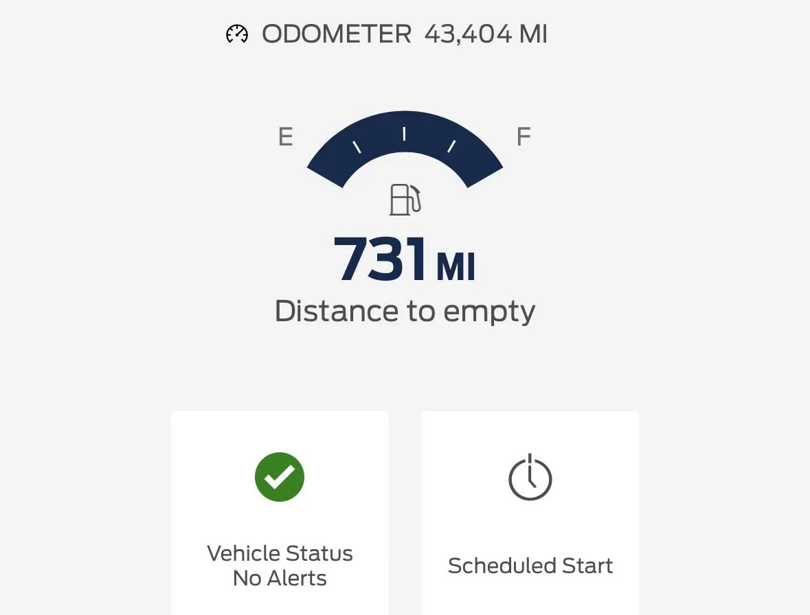

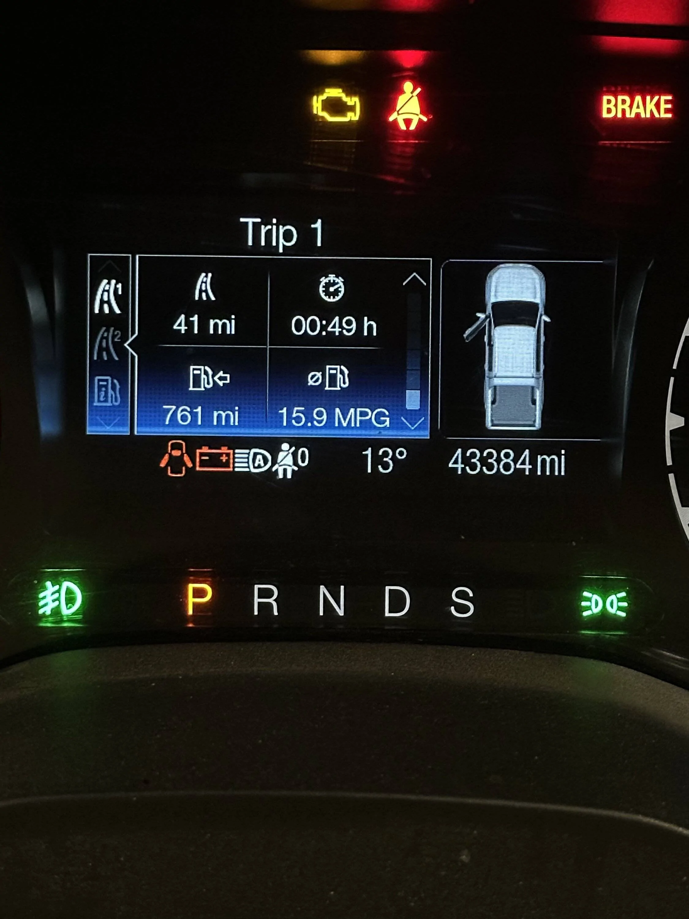

Dang I must have a ton of weight on my rig. My MPG estimator is showing 522 miles to empty after the LRA tank install
Colo_Ranger
Apr 19, 2021
3,847
13,215
2021 Ford Ranger XLT FX4
I average between 16 and 19 mpg. I don't think this has completely adjusted the calculation of range. I drove with the tank installed, but not updated for about 40 miles (I needed a windows laptop and I don't have one. My wife was at the hospital) and then I updated the size in Forscan. I don't trust the range yet, hoping it will settle into a more accurate reading soon.
