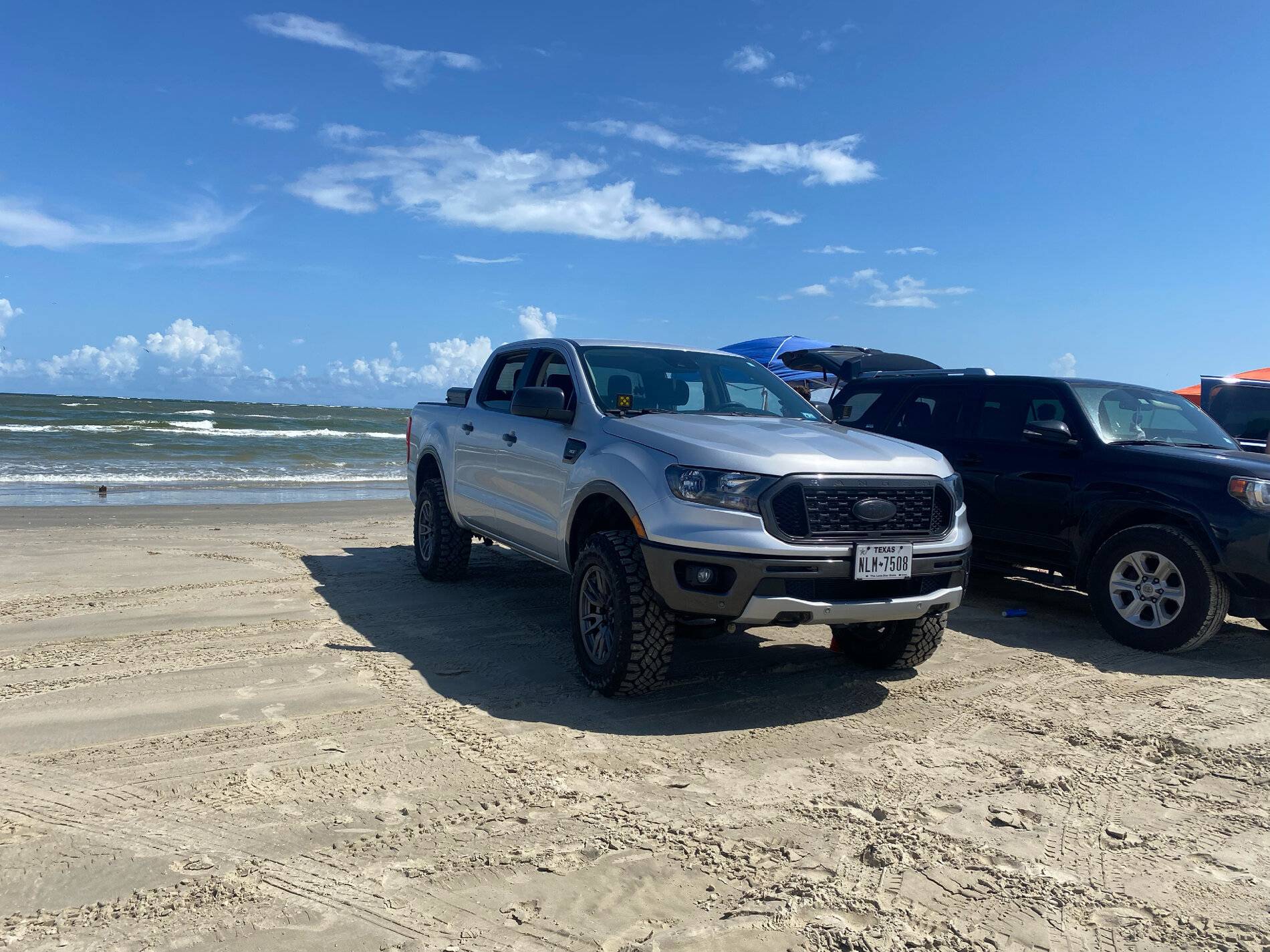

so I went to San Luis Pass on the coast of Texas today and put this to the test… on the way in I was cautious and stuck to the shoreline as much as possible but had to go through some deep sand (maybe 50 yards) to meet up with my friends with no problems without airing down on a 2wd open diff but TC and adv trac off. On the way back I hit the same path but couldn’t carry as much speed since I was behind my friend in his Z71. Sunk full stop maybe 10 yards from being home free and pulled up the e brake and gave it steady gas in the same fashion as clutch+gas on a manual. Immediately started rolling out as my friend started reversing ready to pull me out. Glad I read this thread before heading out there today hahaha. Now I have another trick In my back pocket until I can afford a locking diff or better yet something 4x4 with locking front and rear axles ?
