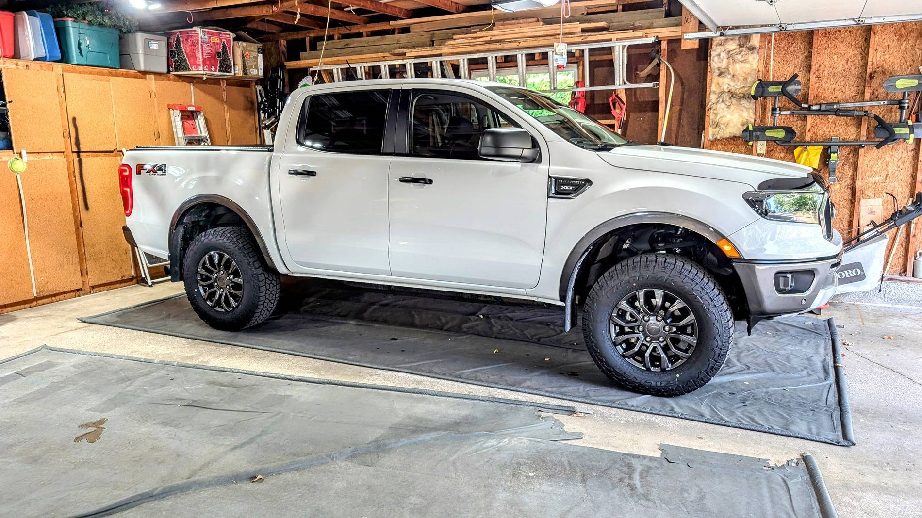

Well, I ordered the 275-70-17's, it will be interesting to see how they fit:oops:
They’re going to look great. If you need a tiny bit more crash bar clearance for peace of mind, you can remove the covers from the front bars, then loosen the bolts, angle them out of the way, then tighten - leave the covers off. Same for the rears but they don’t have covers.
If you want to test for rubbing at full lock, do a quick 3-point turn with exaggerated braking and acceleration. You’ll get decent compression of the front suspension and you’ll quickly know if you’re rubbing.

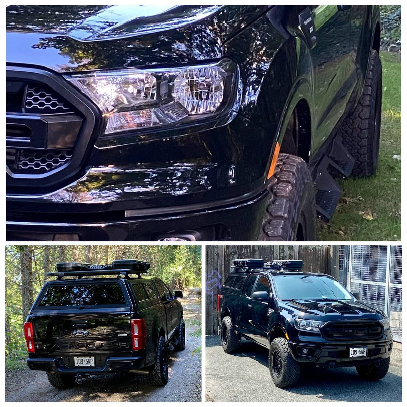

With those spacers and Tremor wheels, expect to see a noticeable amount of poke. If I’ve done the math correctly, 1-1/4” spacers and +42mm offset wheels nets out at roughly +10mm of offset and 1” spacers would put you at about +17mm of offset.
I have +15mm offset wheels with 275/70R17 General Grabber A/TX so your truck’s wheels will look a bit like this…
The small increase in height will seem HUGE and you will notice how they fill in the wheel well.
Your awesome Tremor wheel well trim pieces, that I’m totally jealous of btw, will tame a bit of that poke.
