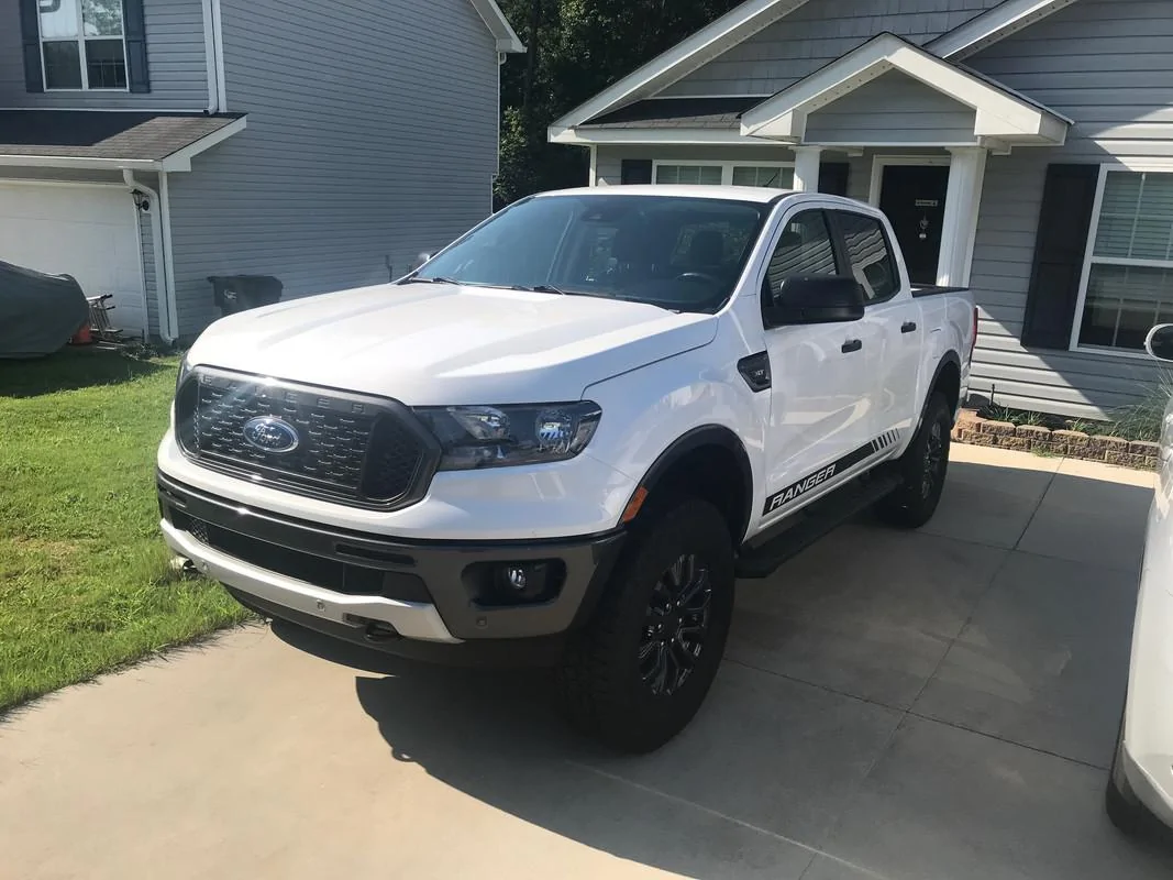

275/70/17 on Stock Sport Wheels
TKDMasterV
Mar 3, 2019
81
197
Pooler, GA
2019 Ford Ranger Supercrew XLT - Sport
I was apprehensive at first. I'm glad I pulled the trigger on them.

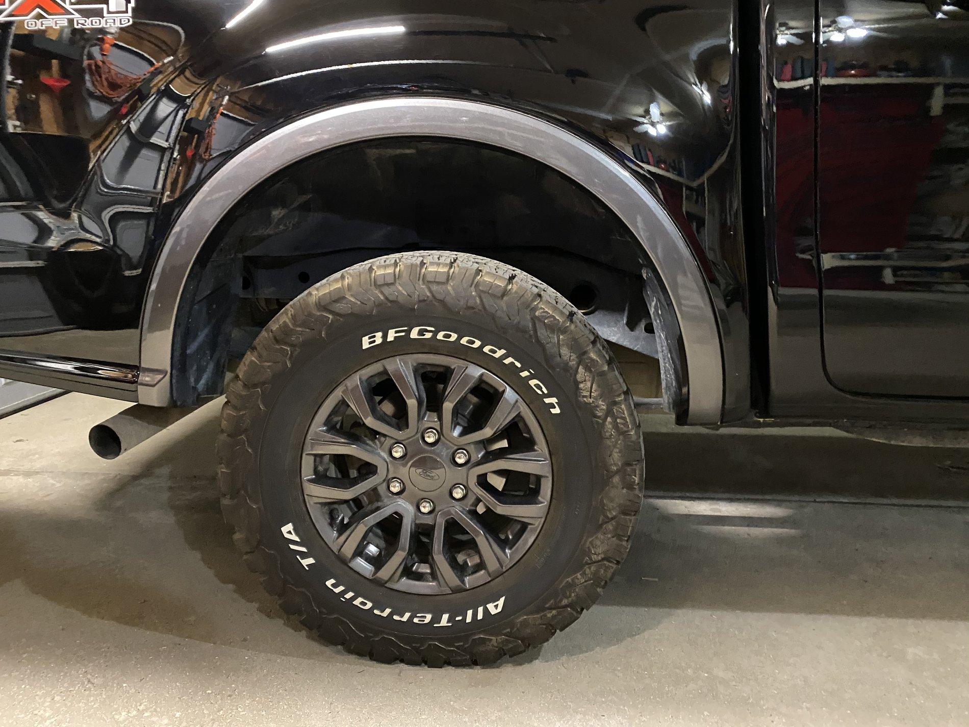

What brand? I read on the other thread that you took off the plastic and adjusted your crash bars. Was that after you installed these? Thinking of getting some. My 275/70/17 don't rub at all right now with nothing removed or adjusted. Real tight on the inside though.
Dick Richie
Richard
Nov 23, 2019
48
173
Houston
2019 XLT Ranger

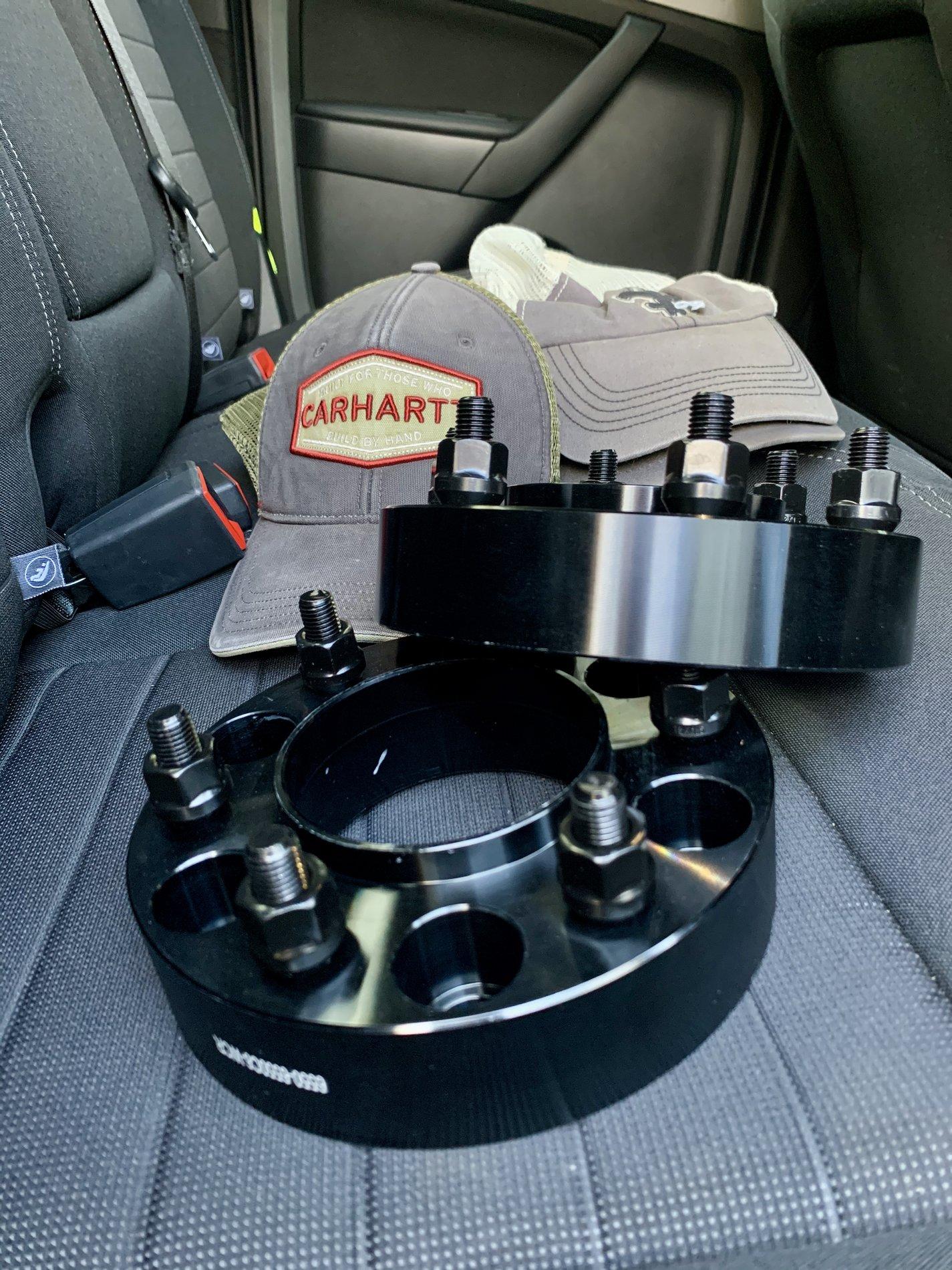

. Yes, after installing these. No rubbing before at stock height on the 265/70/ Falken. I found them eBay from LUGNUT GUYS. Shipped from Los Angeles. They were
$129.35 with free shipping. They arrived in about a weeks time. It was the only place I found them in stock and ready to ship. If you were to go with a 1 inch spacer it likely won't touch the adjusted crash bar. Personally I'm cool with the slight rub to get the tires slightly outside the fender well. I plan on finishing the truck out with RTR flares.

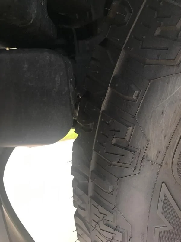

One more question. Was it rubbing on the front and back crash bars? Just checking to see if my mud flaps will have to go. I like the RTR flares too, would be my first choice.
Dick Richie
Richard
Nov 23, 2019
48
173
Houston
2019 XLT Ranger
Just the front. Only at full steering lock, such as pulling into or out of a tight parking spot.

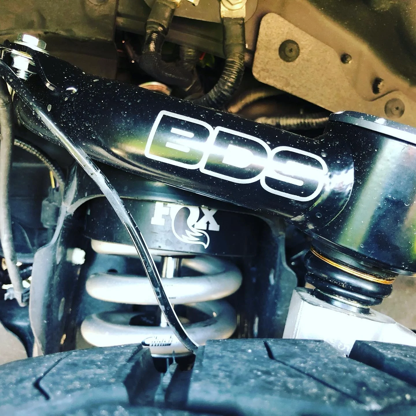

Do the UCA's do anything to help with the tire clearance?
I don’t believe so but I’m not 100% . It helps with range of motion and alignment. Also it’s obviously stronger than the stock part.

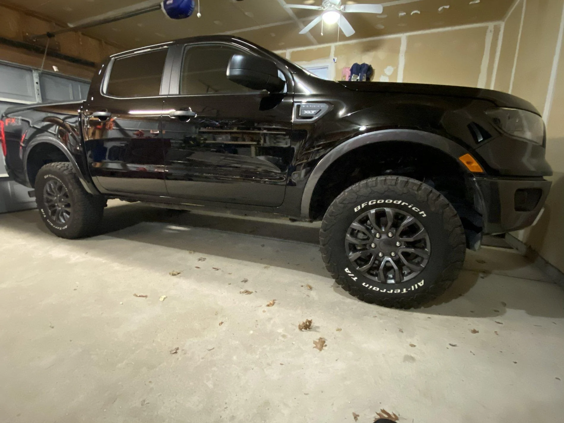

BladeRanger
Bladimir
May 16, 2020
907
2,267
Escondido Ca
Ranger 2020 XLT FX4
Electronic Engineer
BFG KO2’s 275/70R17
Rough Country 2.5” Level Kit
No other mods. Stock Crash bars still in tact. No rubbing at all. 4,000 miles on this setup.
The BFG’s are the only tire Ive seen fit in this size without removing the crash bars. They run slightly smaller which is why they fit.
I can get better images tomorrow as It already in the garage for the night and Im too lazy to take it out.

UCAs definitely make for a smooth ride, glad I did the package.
Hey FL.Ranger hope you're well. Another question for yah. Would you reccomend the UCAs? I recently installed the fox 2.0 and I am very happy with them. However I wish they were smoother over these rough and jagged Hawaiian roads haha. Thanks for your input! Have s good day
FL.ranger
Feb 29, 2020
135
186
South Florida
2019 Ford Ranger Lariat
I think they will help you achieve a smoother ride, although someone could make an argument against.
I guess the question would be “to what degree.....” very subjective.
