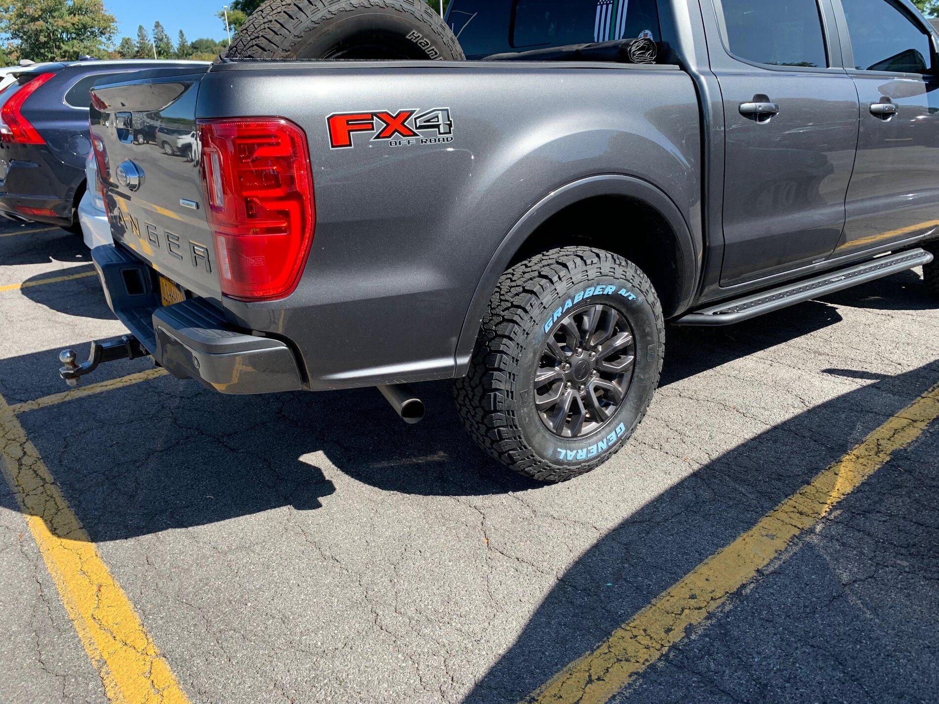

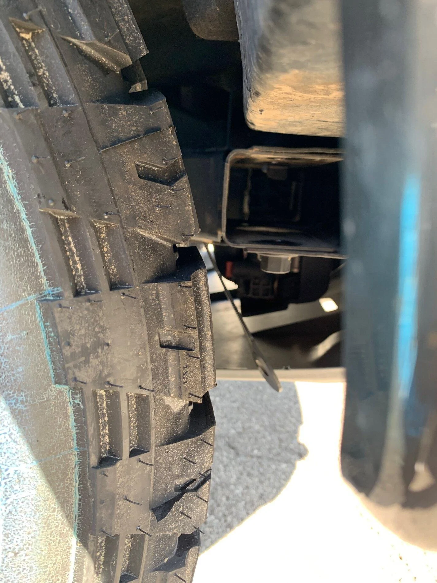

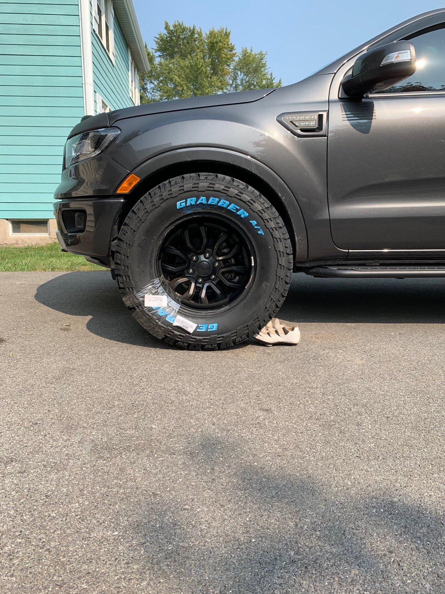

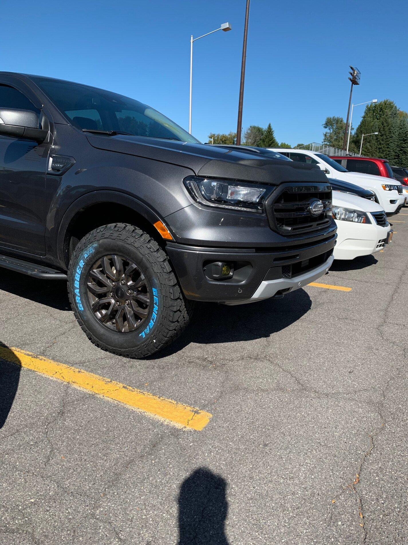

So I just wanted to let everyone know this size fits without a lift. I removed the crash bars before getting them mounted just to make sure. I did it by loosening the front bumper enough to slide them out. just in case people wanted to go larger than 265/70 which i had on my first ranger (flipped it).
I am posting before and after as well as clearance at full lock.
tires are
General Grabber ATX
275/70/17 (32.2x10.8)

I would 100% take the crash beams out before hand. I don’t think they’ll fit with them in at stock height
