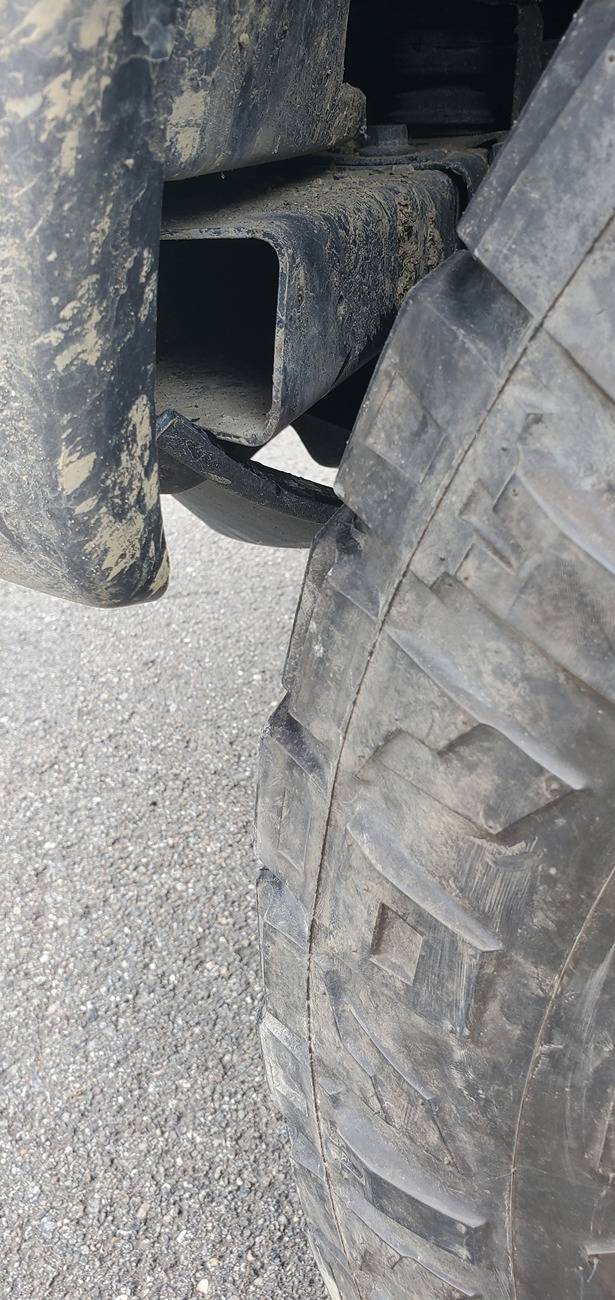

275/70 should not rub with a 2.5
I have 285/75 on a 3.5 backing up turning it kind of grabs that plastic rain flap but thats an easy fix with a heat gun LOL
I know they are dirty LOL a lifted 4x4 with clean mudders is just gay....
