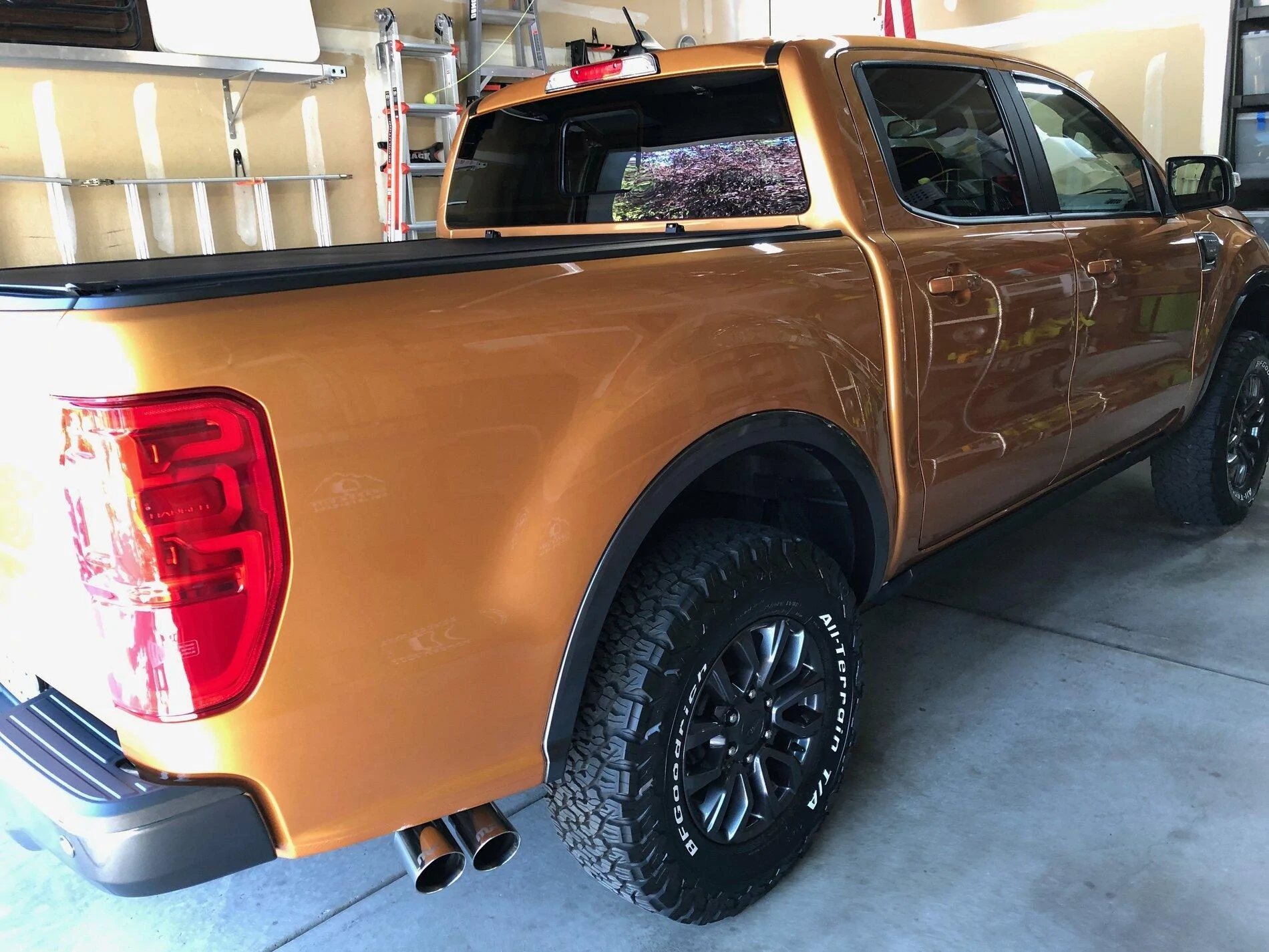

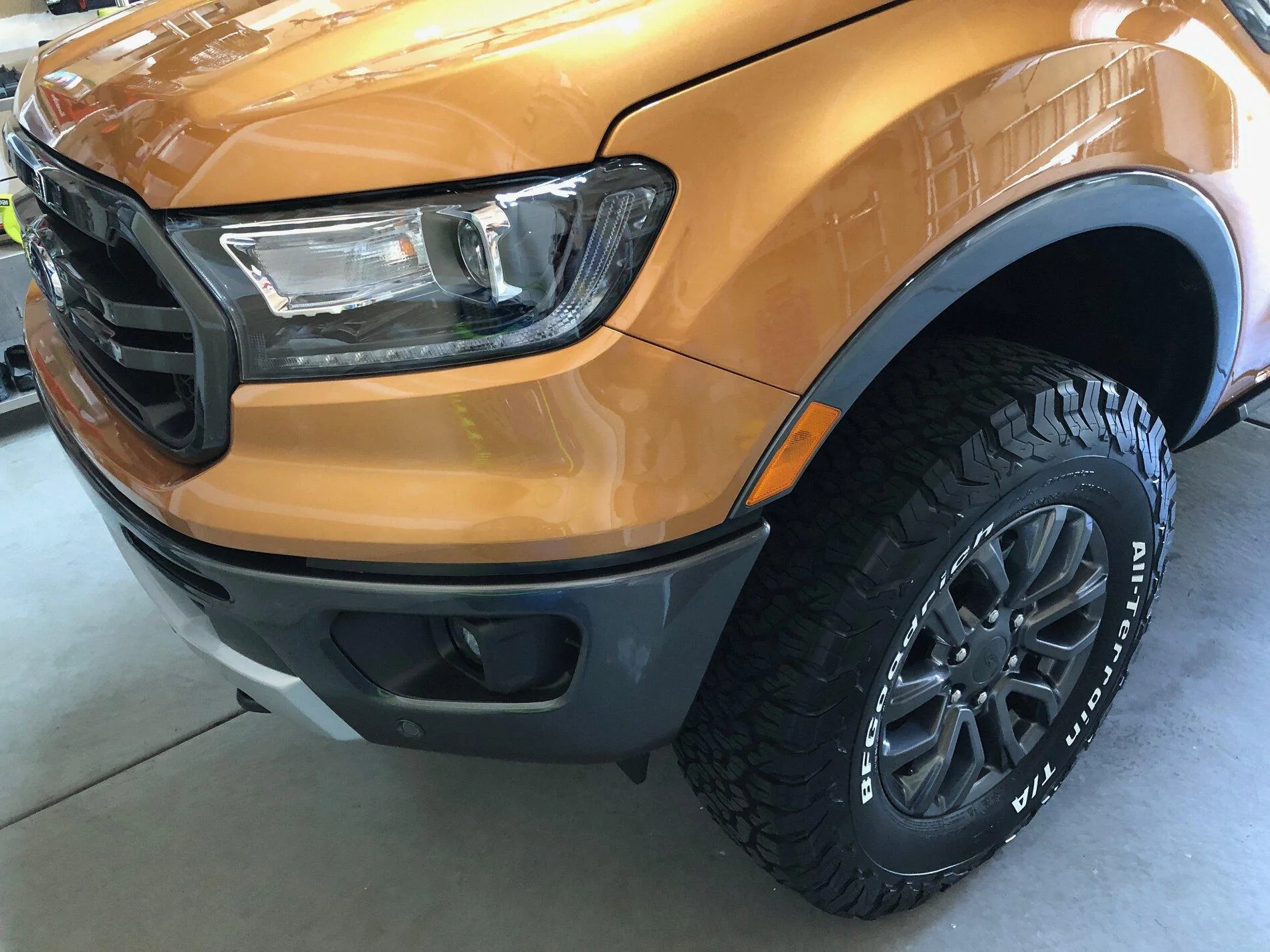

I've posted info on some other threads; but in the spirit of trying to help Fellow-Ranger-Owners decide on tire size for the Stock Sport Wheels, here's my set-up:
BFG K02's LT275/70R17
ReadyLift 3" Level (front only)
Stock Crash Bars Intact
After the initial install, I decided I wanted a bit more "aggressive" stance, so I added the 1" BORA spacers. (FWIW.... the above pic's are with the spacers installed)

Looks great! How does it ride? I'm curious since that size is a load range E. I was considering that size or the LT255/75R17 BFG K02. It's only slightly taller, but 1/2" narrower and a load range C.

Thanks Shea!
I remember your excellent/informative comments on the tire pressure thread of this size tire when I "chalked" my tires:
https://www.ranger5g.com/forum/threads/bfg-ko2-lt275-70r17-tire-pressure-info.7792/
I really like the ride, and while I only had the original tires on for a short time, I don't think there was/is much difference?
I am very happy with the on-pavement performance & overall feel/ride; and with the occasional off-road/snow use I have encountered.... for me, the tires are excellent!
I'm no expert; but my wife is and she says "I like how your truck rides.... it's comfortable and smooth".

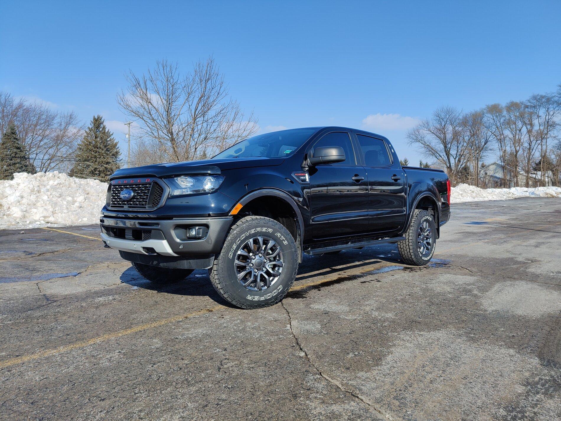

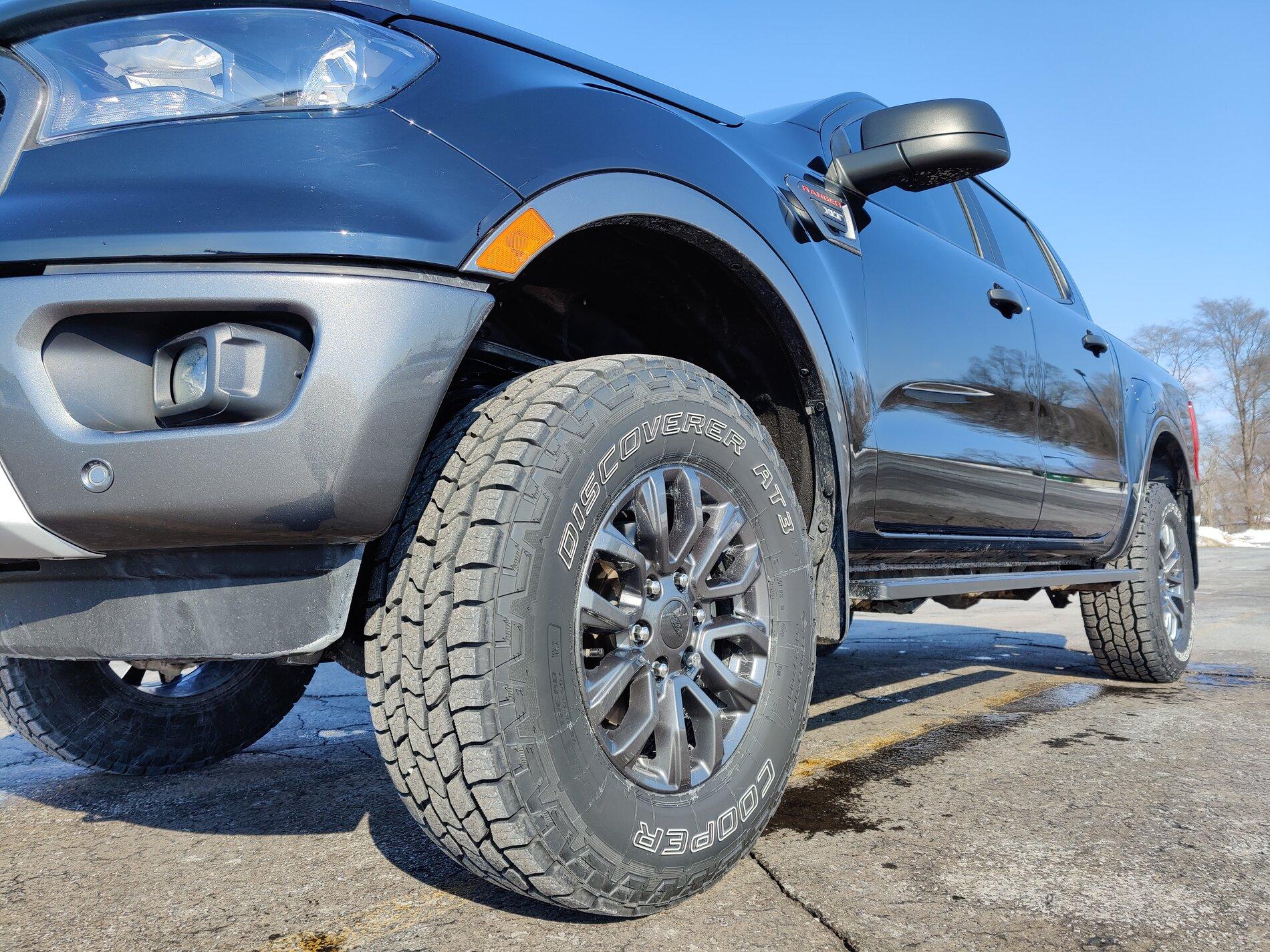

I just put some 275/70/17 Cooper Discoverer AT3 on my generally stock XLT Sport. I love the look, ride is fantastic. I have a RC 2.5 leveling kit on. That's the only mod.
Nice set up man! What running board to you have installed?
Do they rub?
