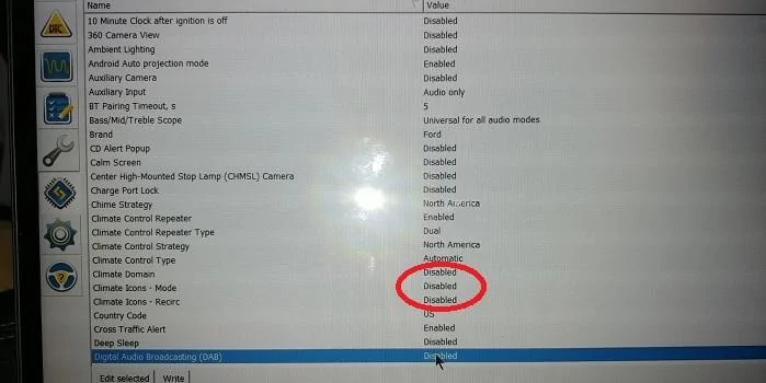

Prior to the update to Sync3.4 I enabled the three climate features with FORScan, as my APMI was defaulted to DISABLE which would have resulted in loss of climate controls.

You stated you Enabled all 3 Climate settings (Climate Domain, Climate Icons - both Mode and Recirculation) prior to updating to v3.4 as were all previously defaulted to Disabled. What trim level do you have? Ex: XLT 301A, XLT 302A?
Also by doing this, when you updated to v3.4, you didn't lose your climate controls?

I have an XLT 302a package non NAV. Following the Ford instructions it only took about 25 min, and it maintained Climate Controls.
I believe the credit goes to UofMEngineer who said that there was a glitch in the system that allowed the climate controls to appear and function even though the Hexcode was wrong. Someone else did post the code and change needed to Enable the Climate Domain, or do it the easy way and just Enable it under the menu option in FORScan.
Below was my original settings. I Enabled these first then updated with the Ford Factory files to v3.4

Just did sync 3.4 update. No climate either.
Enabled the 3 forscan climate items in the apim, and didn't show up immediatly.
Did a soft reboot and it was there. All fine now.

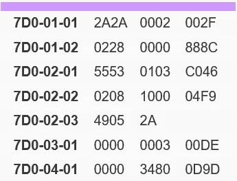

My build date is 11/19. Heres my 7D0-04-01
7D0-04-01 0000 3480 0D9D
