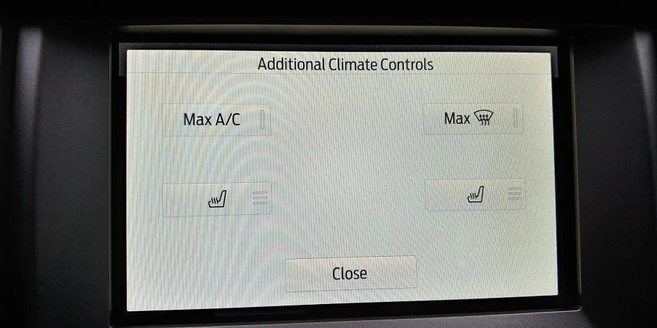

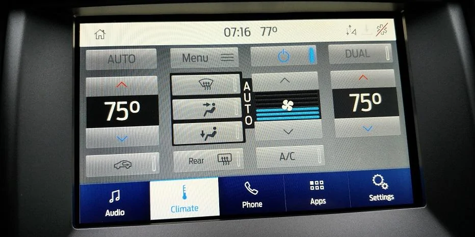

Prior to the update to Sync3.4 I enabled the three climate features with FORScan, as my APMI was defaulted to DISABLE which would have resulted in loss of climate controls.
Ford needs to hire a graphic designer as the appearance of all the displays looks like a kid's first attempt at a PowerPoint presentation.
New design from Sync3.4. Under MENU - Additional Climate Controls it appears there are less controls in the new menu than the older 3.3 controls. Is this normal or is something missing again due to the glitch like Climate Controls?

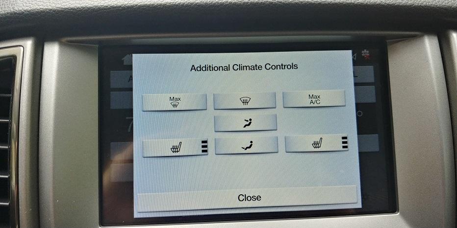

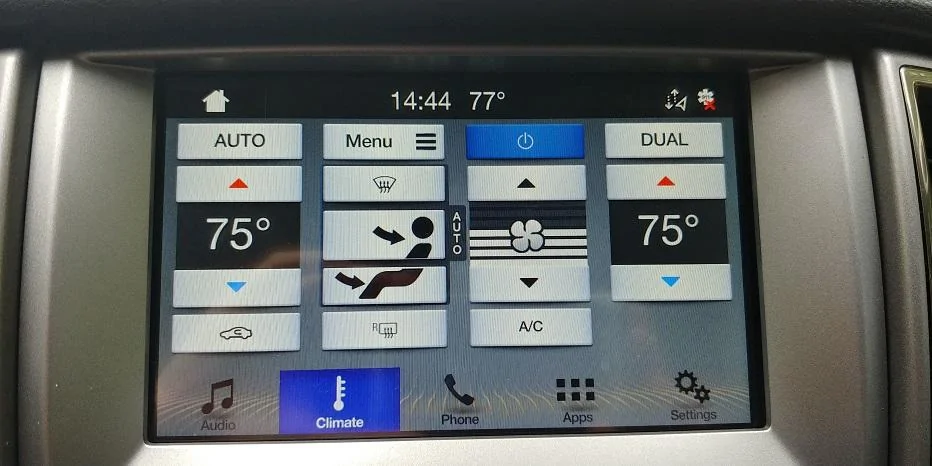

Sync 3.3 views and Additional Climate Controls menu. The missing controls under this menu in 3.4 are actually on the main display, so no big deal, however, under 3.4 the design and layout of this sub menu is horrible. Will have to play with the design and see if I can get the Ford Classic and Lincoln Timeless mix back. As result of another glitch in the system.
I guess I'm going to have to play with ForScan again. I went under menu and the heated seats aren't showing up there. Can anyone point me where to look to fix this?
It’s under another option further down the configuration menu. I think they call it power seats, then you have the options (disable) (heat and cool) (heat). This is all from memory, so don’t count on my description. Next time I’m on FORScan I will take a screenshot.

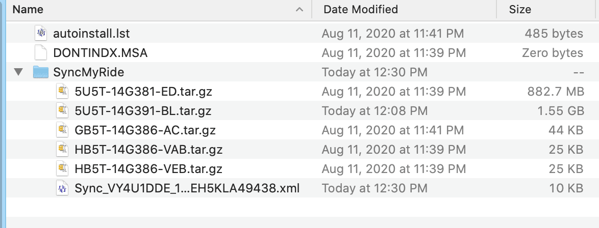

I'm not going to plow through 65 pages of files....
This said, in the last three days, I've spent more time talking to Ford and their Sync supplier, than I would like. But, I finally spoke with a really knowledgable Ford Rep, with a sweet voice and disposition. Only to find out, she uses an iMac at home! Great!
The reason the down loaded files don't work when using Apple's iMac software, is that it doesn't organize them correctly. Considering what base operating system Ford's Sync operates on, I down loaded the free version of Win-Zip for iMac. Further, from talking to the young lady, even Window's built-in, zip application, doesn't do it correctly most of the time.
The photo below is what the unzipped file should look like on a Mac or PC. If it doesn't, download some other app and try it.
I'll agree with one or two comments from above. Apparently, not everything works until you reboot the program after the update. All this reminds me of the old adage about try, try, again!

I have downloaded the 3.4 zip file for my Lariat. I have *.gz files but no *.xml file. I expanded the zip file both on a Mac and Windows machine and no *.xml file which is also what the Ford website shows should be there.
Any ideas why this is ?

Is there supposed to be a*.xml file in the SynchMyRide folder after unzipping the downloaded file ? I have downloaded the file several time and extracted on a Mac and Windows machine but there is no .xml file in the folder. Is the .xml file created after the update is complete ?
SYNC should add it once you finish the install. It’s not part of the download. It’s what you upload back to Ford.
Thanks so much ! The screenshot on the Ford download page showed the file so now I'm good.
