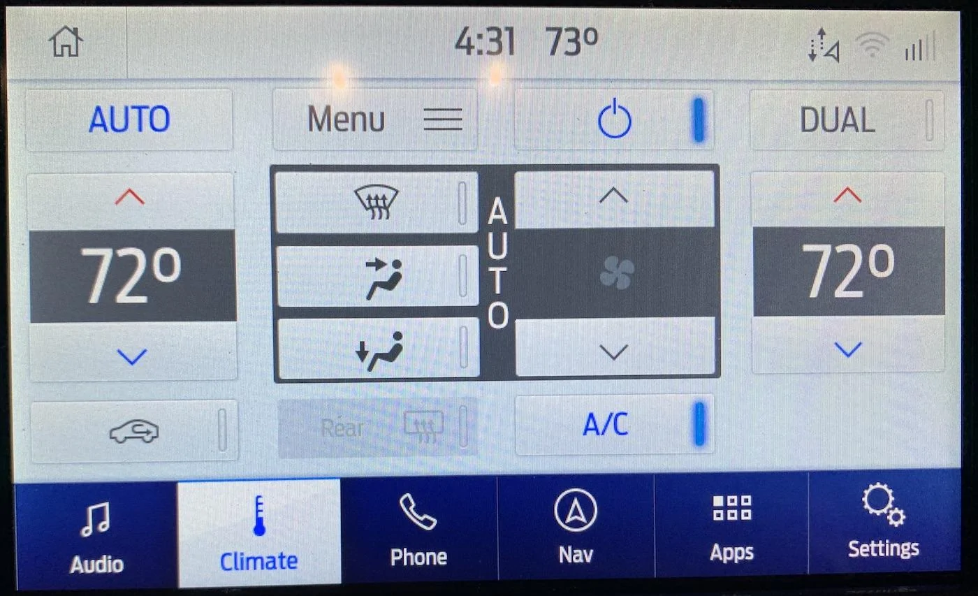

Just Climate Domain in the APIM Module and not the APIM (As Built)?
Just the “Climate Domain” but NOT in the “As Built” module.
On my screen there are two APIM Modules shown. I clicked on the one named “APIM” and enabled the “Climate Domain” and clicked “Write”.
I have never changed an “As Built” module.
It is always safer to use the configuration menus than changing the As-Built. Changing the As-Built requires you needing to know the correct thing to change. Some modules don't have a configuration menu, but you probably shouldn't be changing them anyway.

Just climate domain.
Are the other two enabled by default then?
Climate Icons - Mode​
Climate Icons - Recirc​
My climate screen shows Mode and Recirc Buttons (they work) and they are nice but I wasn't sure if these needed to be enabled separately or if they'd be enabled when the Climate Domain was enabled. In any event enabling them seemed the way to go.
I think I will also do this just in case.

If the Icons are on your screen you shouldn't need to do anything more.

Not sure if asked before but those that have lost climate after updating I wonder if you were missing the heated seat controls prior to the update? I updated on my lariat to 3.4 and am also missing the climate icons. Seat control was not showing on mine on 3.3. Just looking to see if a common factor.
