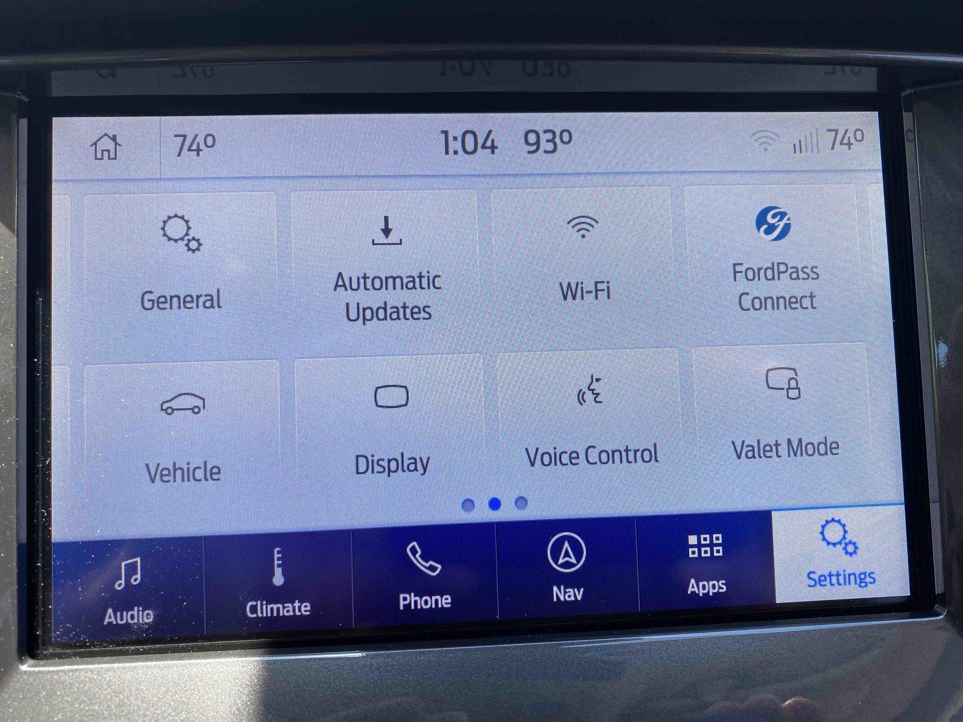

I noticed on the "new" 20021 Build Settings panel a "new" icon labeled Automatic Updates with an arrow pointing down.
I truly hope since my current Sync 3.4.20021 Build level is less than the proposed Build level of 20136 I will be able to update my 20021 Build level without any problems or issues.
And, I am curious if at the 20021 Build level the software upgrade would in fact be automatic?
