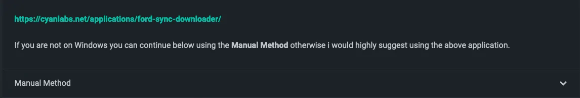

My post 140035 was based on an earlier version of cyanlab.net/tutorials to upgrade your Ford Sync software. This post is based on the new tutorials with two new Ford Sync software update options.
https://cyanlabs.net/tutorials/update-ford-sync-3-2-2-3-0-to-version-3-4-all-years-3-4-19200/
Option 1: Automated Method: A Ford-Sync-Downloader Windows application that will download the files directly from Ford, correctly prepare the USB drive, and copies the files to the USB drive.
At the end of this automated process the USB drive is ready for you to insert into your vehicle to execute the Sync update.
https://cyanlabs.net/applications/ford-sync-downloader/
Option 2: Manual Method: only option for macOS, optional method for Windows users.
As the name implies the manual method requires you to manually execute the steps of preparing the USB drive, downloading the reformat tool, downloading the autoinstall.lst file, downloading the update files from Ford, and creating/editing the reformat.lst file, and then copying all of the files to the USB drive so it looks like this:
All of the tar.gz files should be in the SyncMyRide folder.
The Manual Method steps are well documented on the website to guide you through each step of the process, and there are links to click on to download the necessary files to create your Sync update USB key.
The default page on the cyanlabs.net/tutorials/has the Automated Method (Windows Only) section "open". To see the documented steps and links for downloads for the Manual Method click on the "small v" on the far right of the row with Manual Method on the far left.

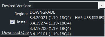

There is a documented history of many users of this forum using cyanlab.net/tutorials and creating a USB drive with versions older than 20021, executing the Sync Update, and then realizing after the Sync update was complete the Climate controls were removed from the display.
If you have not previously executed a Sync update and "lost" your Climate controls on your display screen, members of this forum using the new cyanlab.net/tutorials selecting 3.4.20021 for their first attempt to create a USB drive to update their Sync version have successfully updated the Sync version without "losing" their Climate controls.

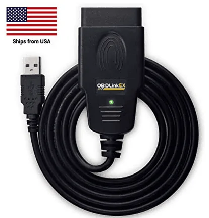

Full Disclosure: I share this information to inform future "beta testers" in an attempt to ensure they do not lose their Climate controls, which then requires an investment in the FORScan software and the OBDII adapter to reset to put the Climate controls back on the display.

I don't know that success was due to the 20021 software alone, the install tool seemed to have some automation in place to make sure the install was successful. Maybe combination of both.
After everything I have seen and read in multiple forums on this topic I think your success was doing the update with the automated tool going directly to Sync 3.4.20021.
I just posted my most recent experience yesterday where I downgraded by Sync version from 3.4.20012 to 3.4.19101 in order to use the tool to update my maps.
As stated in my most recent post when using the Automated Tool and selecting the 3.4.20012 option "HAS USB ISSUES", after the completion of the automated process the USB drive was blank.
I was able to create the USB drive for the 3.4.20012 update using the manual method, and I successfully updated back from 3.4.19101 to 3.4.20012 with NA 119 maps.
As I stated before, it would appear the difference is the update to 20021 rather than an older version
