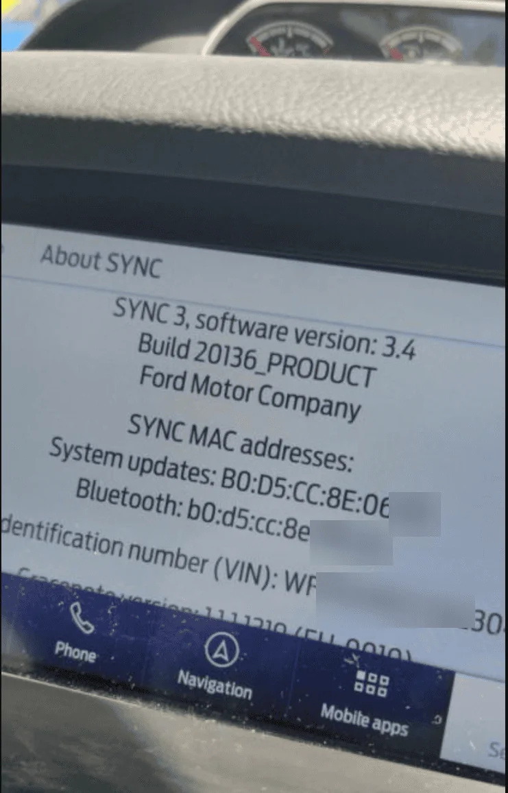

Just updated to Sync 3.4 on my Ranger 2019

Just updated. No problems. Any new notable new features?

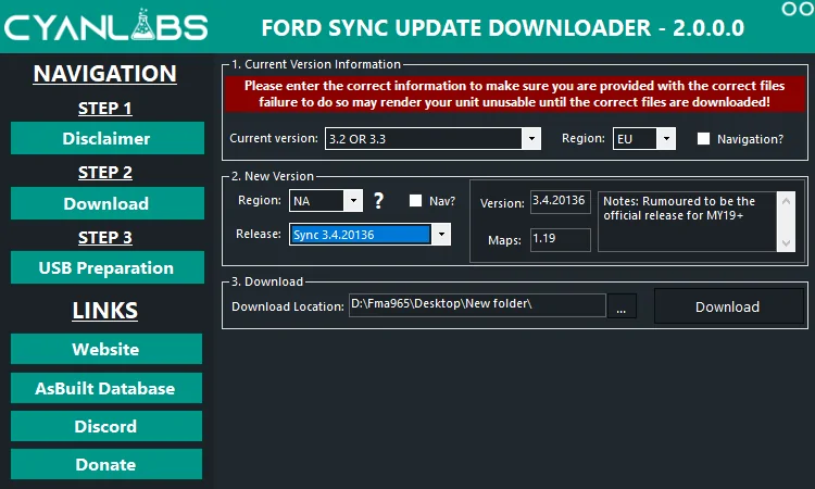

Firstly to confirm i am "the cyanlabs" see here https://cyanlabs.net/about/
Thanks for linking my tool :) i hope it makes things a lot easier, i am trying to implement "update" and "reformat" but confirming what people are currently running is the issue, depending on current voice versions, gracenotes versions etc they may or may not needed updated one when they update apps etc, i have access to the Sync filesystem and can see things the normal end user can not.
To clarify i had no legal issues with ford at all but it was technically their IP and could be liable. i decided it was best to remove the packages, and instead link to ford's own hosted files on azure. the reformat tool is hosted elsewhere not affiliated with meand MD5 checked to ensure integrity

Yes although my guide/tool is mostly for 3.0 and older, it can be used on newer but there is technically no need. or retrofitted cars.
follow the manual guide on my website ;)
oh ALSO added 20136 to FordSyncDownloader

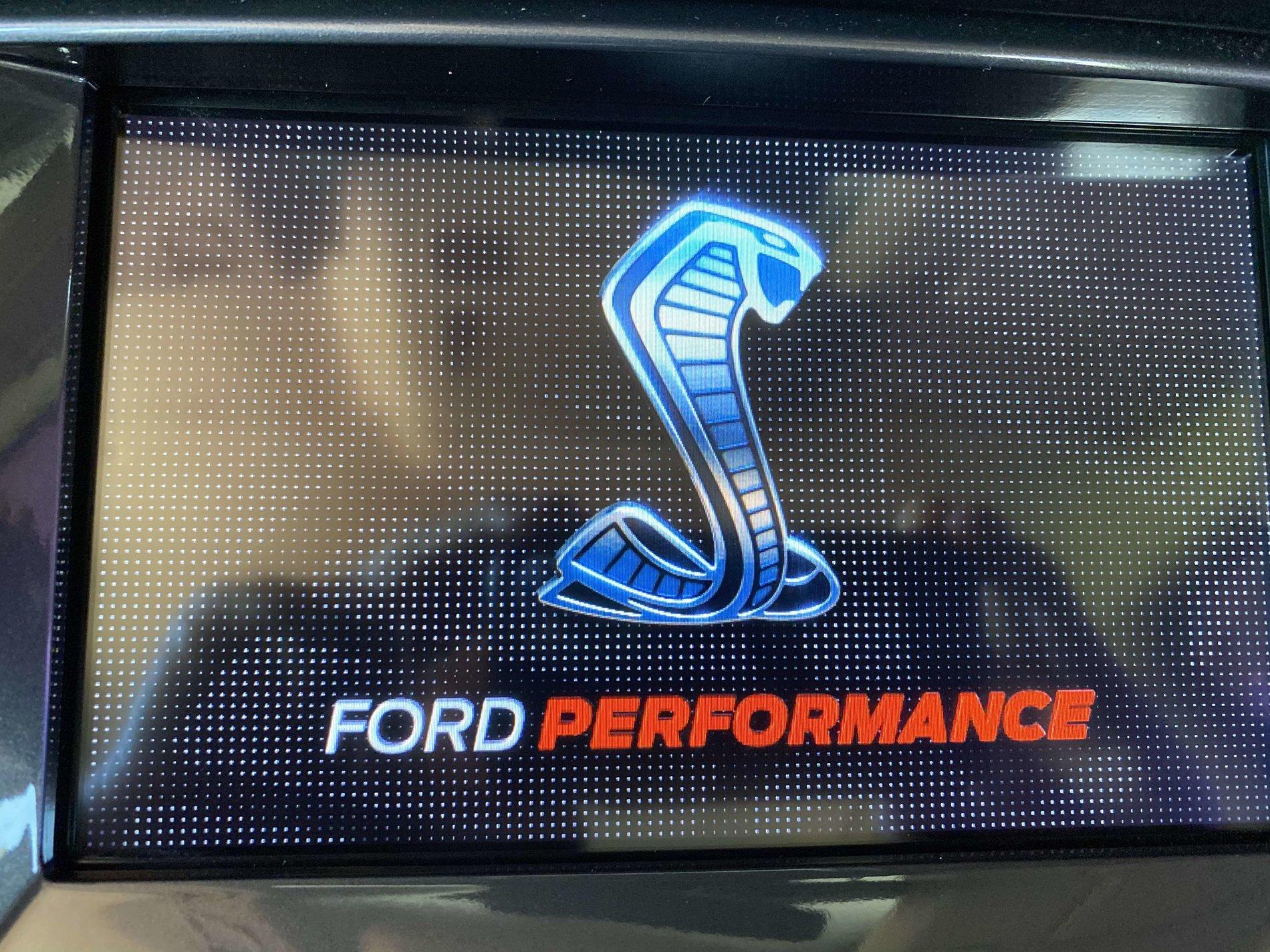

I found this splash screen back in March when I used FORScan and my OBD II adapter to restore my Climate controls.
I had watched Ford v Ferrari for the first time a few weeks before, and I liked this one because of the "EcoBEAST" in "S" when you floor it. Just makes me smile while I am enjoying the Ford Performance.

There is an updated 2.0 version of the Cyanlabs.net Ford Sync Update Downloader tool.
If you have already downloaded and installed an earlier version of the tool you can update to V2.0 right in the app.
Since my build level was at 20021 I had to "downgrade" my Sync build level below 19274 to be able to use the tool to upgrade to 20136. I decided to try the new version of the tool in my Windows 7 virtual machine via VMware Fusion on my Mac, and this time around the tool worked great for me.
I created two USB drives, one to execute the Sync level downgrade, and one to execute the Sync upgrade to 20136. I decided to create two keys rather than reuse the same key because I prefer to be driving when doing the Sync software update rather than sitting in park idling in my driveway.
The Sync downgrade used only 1GB of space on the USB drive, and the execution time of the downgrade was 6 minutes 45 seconds.
The Sync 20136 upgrade used 14.42GB of space on the USB drive, and the execution time of the upgrade was 28 minutes. I do have the Nav package.

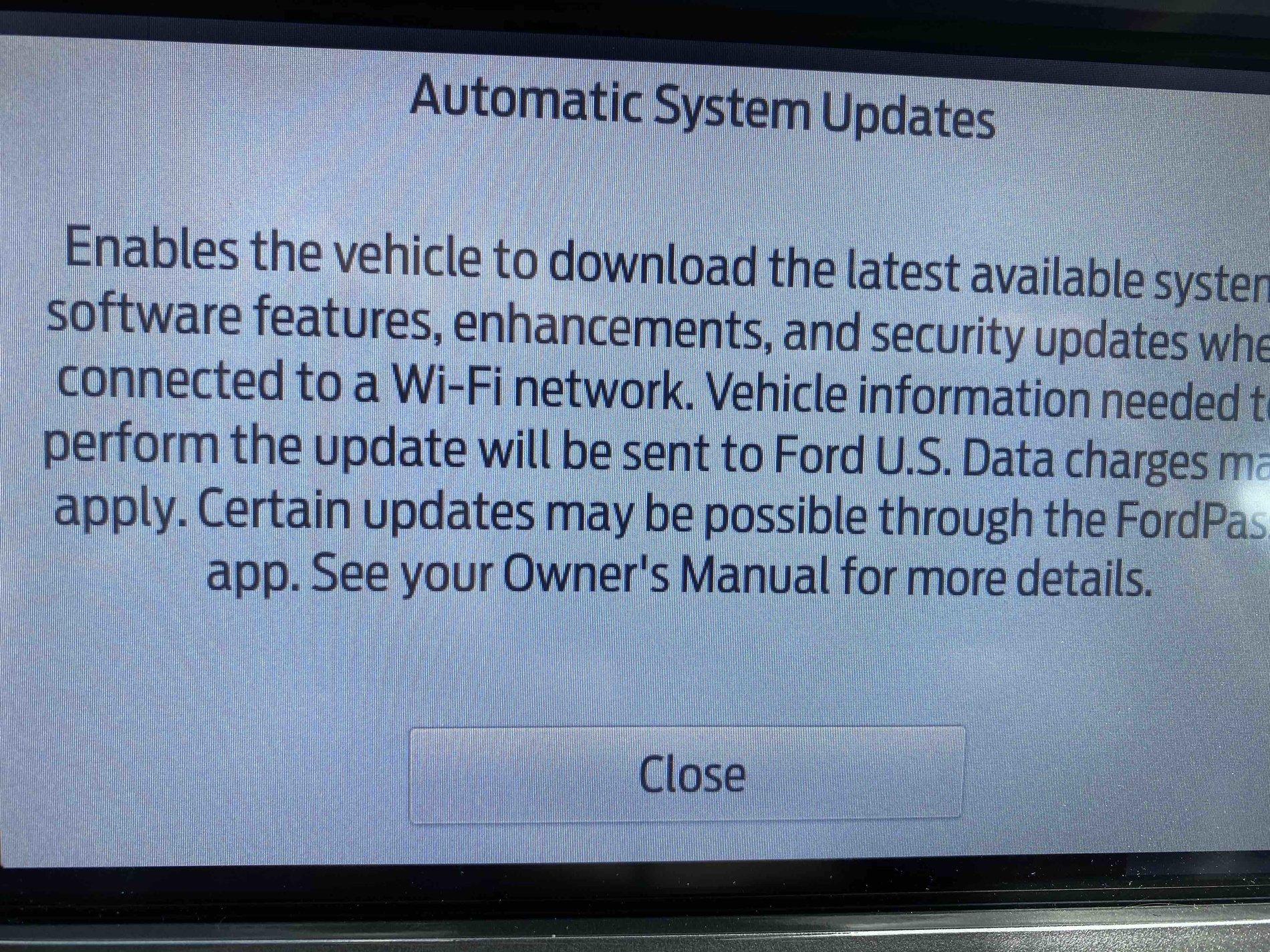

Based on the "Automatic System Updates" panel and info it would seem this "could" be the last time I have to update my Sync App or other software using a USB drive.
The new info states the latest available software updates are enabled via a Wi-Fi network, while certain updates may be possible via the FordPass app.
Ready for my future Sync updates to be wireless via my home network.
