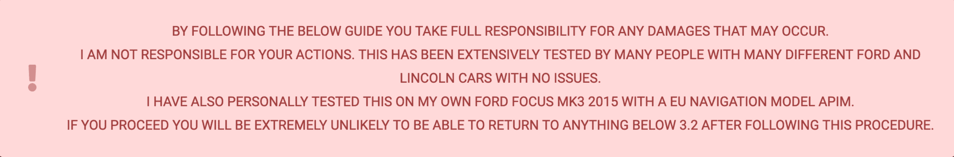

so, fully understanding the disclaimer, and I would also say your choice, but based on my manual method I updated the "APP" software 2 times after my first update to 3.4
My original update took me to 3.4.19101, 1st APP update took me to 19274, 2nd APP update took me to my current level of 20021.
Based on other info on the Cyanlab.net website If I was starting over I would choose a selection below the 3.4.19274, either the 19101 or the 19200.

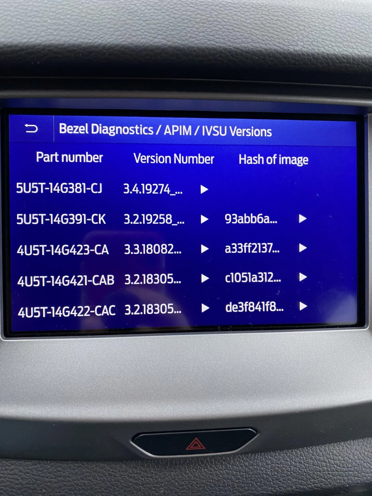

Edit the autoinstall.lst on an existing usb update stick as follows:
[SYNCGen3.0_ALL]
Item1 = 5U5T-14G391-CK
Open1 = SyncMyRide\5U5T-14G391-CK_1571088381000.TAR.GZ
Options = AutoInstall
Download and place the 3.4 compatible voice pack in the SyncMyRide folder:
5U5T-14G391-CK
You can see the current version of your sync3 packages as follows:
Press the "skip forward" button on the steering wheel and the "skip forward" button on the center console at the same time and hold them until you hear an obnoxiously loud beep. Don't worry, this is diagnostics menu and the beeping is for testing your speakers. Press end audio test and in the menu go to APIM-> IVSU Versions and grab me that screen.
Pictured is what you should have for a fully functional 3.4
In a post dated Feb 1 in this forum kadettje documented what the edited autoexec.lst file for the update of a single Sync software module should contain. He was updating the voice data pack module to the correct compatible module because the cyanlab.net tool at the time downloaded a Sync App module (381) with an incompatible voice data pack module(391).
The Sync App module has a "paired" compatible voice data pack module, and if the compatible voice pack module is not installed the voice navigation commands will not work.
As stated, edit the Autoexec.lst file on an existing usb update stick to identify the software module file to be updated, then place the software module file in the SyncMyRide folder on the stick.
Do not extract any TAR.GZ files.
This method does NOT do a reformat, and is the recommended manual method if your Sync App software is already at Sync 3.2 or higher.
