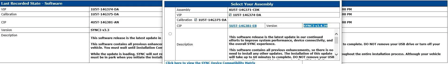

Sync 3 is mostly deployed on the same hardware across Ford's lineup per model year. There are a few exceptions though but none that apply in your case. The link to the F150 forums is my thread and the files linked in it are from my google drive which are the official files I downloaded directly from Ford. I understand you are or were waiting for Ford to release an update through a more official / public channel and a few weeks ago they momentarily did publish the update you want through OASIS before it was revoked for unknown reasons.
The update Ford packaged together and uploaded to OASIS is exactly how you'll find it packaged together from any other Ford forum on the internet, (screenshot of Oasis below). Thanks in part to the advice of the user UofM Engineer who is a developer at Ford who directly works on Sync products. He's also a user here and has posted in this very thread a few times already, but primarily you'll find his most influential posts on the Ford Explorer forums.
If you're waiting on Ford to re-release their update through OASIS, below I linked to another F150 thread which is something you will want to keep an eye on. The F150 forum user Tmcolegr is a Ford fleet tech who checks Oasis for official updates every day and posts anything new right away.
https://www.f150forum.com/f118/ford-releases-sync-3-v3-4-39-some-2019-vehicles-v3-3-a-470402/
