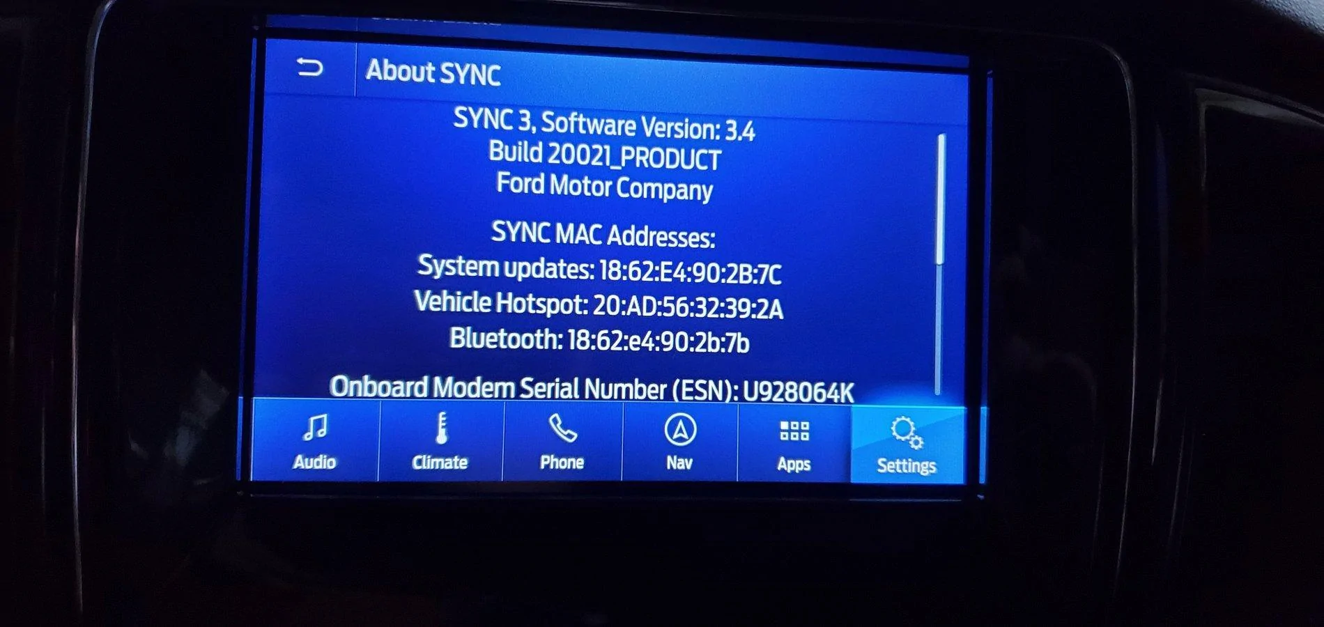

Just updated to Sync 3.4 on my Ranger 2019

During this lockdown Ive been very tempted to do the update. If I do, when the genuine update comes how will we go from the leaked to genuine version?
Its just software - it would be another upgrade. You can apply the 3.4 upgrade over and over if you want. Just like if it doesn't work you can go back to 3.3. That is slightly harder since it seems they made some formatting changes for 3.4, but it is still easily possible. It's all software - which is good and bad.
