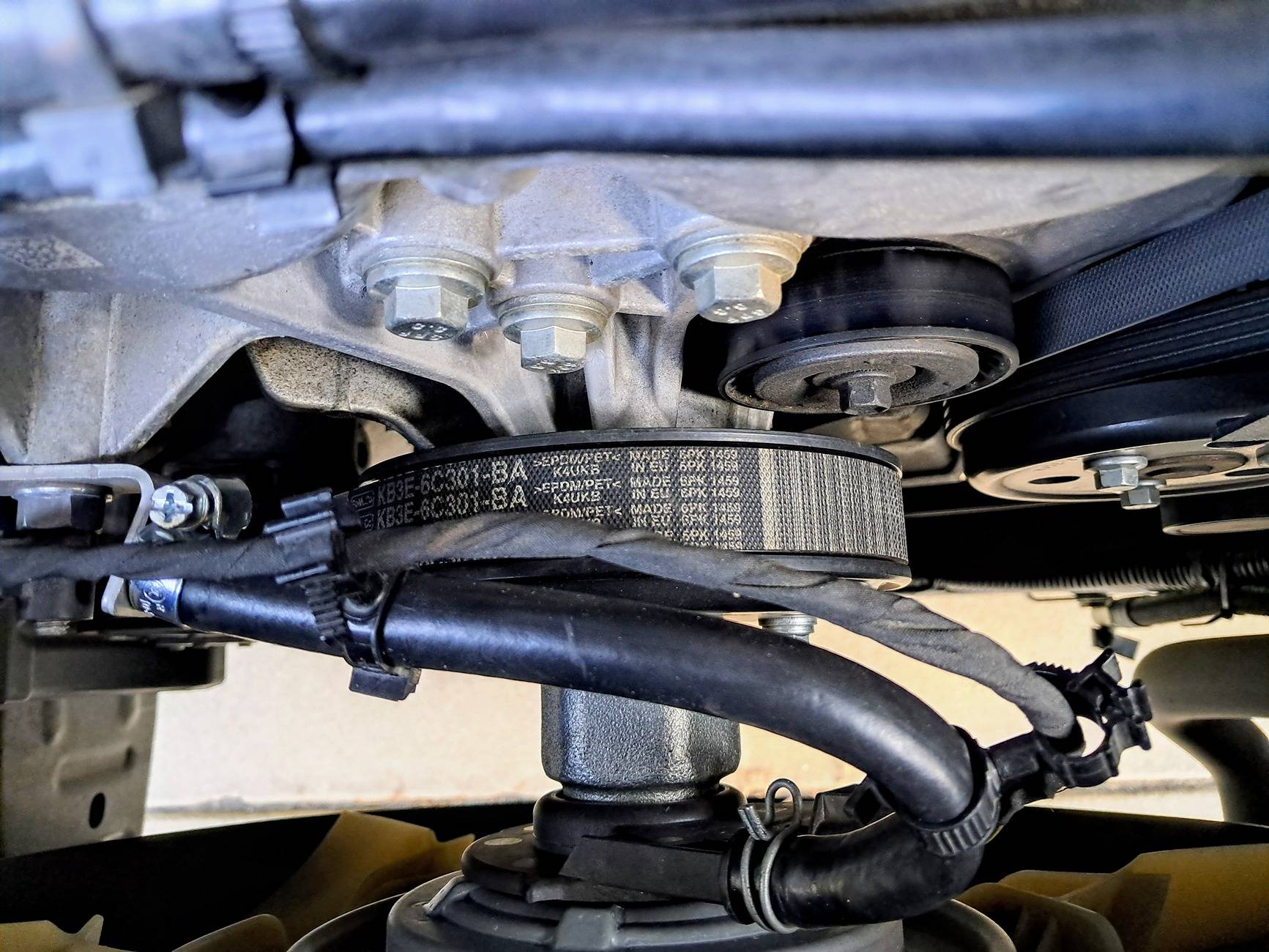

Notice at rest in that pic above that the engine mounted bracket is laying at an angle. When I put the clamp on the replacement hose and tightened it the bracket turned towards the fan slightly. I didn't try to bend it back since I was concerned about fatigue to the metal and since it looked like it pointed the hose at the clutch without binding anything I left it be.
