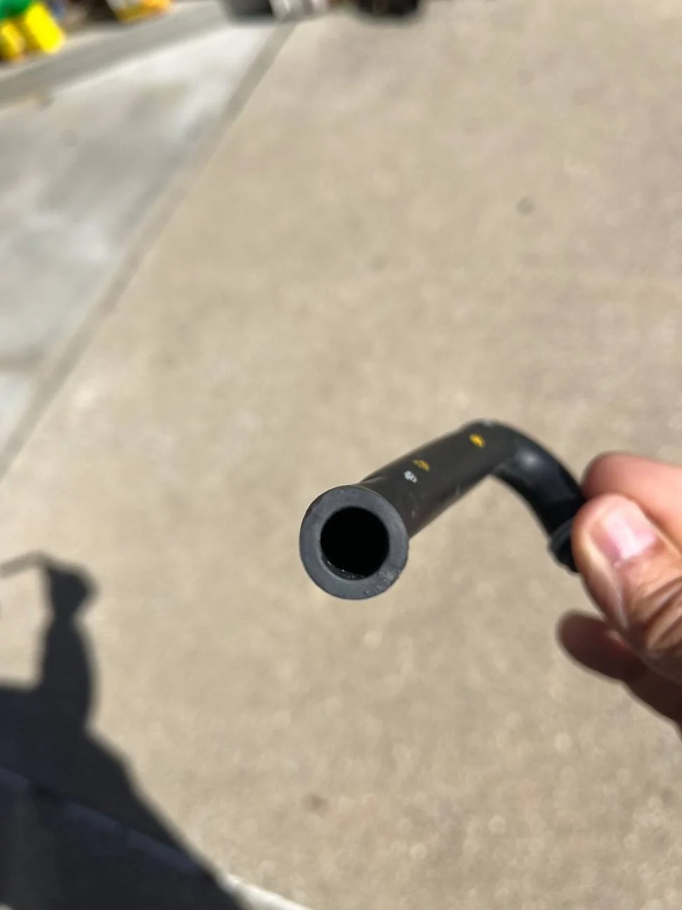

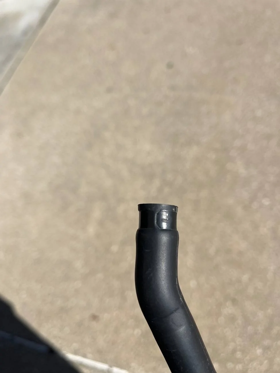

Wondering if there was a change made to the hose at some time. I did the preemptive silicone hose fix on my 03/22 build. OEM hose was ok with a pretty distinct bulge/edge at the engine side. From other pictures that I’ve seen on here it appears the hose that I took off is a bit beefier. Measured.375 id and .600 od. Maybe someone can compare? Posting pics for reference
