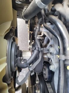

Reviving this thread for an FYI: I replaced the stock fan sensor hose with some high pressure fuel line that I stiffened with short length of soft-drawn copper tubing. Since this thread began, I've wondered what the start-up torque was on that hose and what it was while running. I pulled the stock hose a set a Newton force meter in it's place. I thought it would be negligible, but y'all can decide for yourself.
At approx 50grams of force on the senor stub, it looks to be about .22 in-lbs. IMO it's heat, vibration and rot that causes the failure, not the stress from torque.
(This pic links to imgur)
AWESOME - T-Shooting - Information
And this appears to back up the conclusion thus far - the Clutch Fan itself is not failing or wearing it's the hose deterioration.
Now it is still possible for some wear creating some extra rotational stress but with - Thus far no major reports of any failure codes or issues with the Clutch Fan itself, tells me that it is a solid reliable part and the only reports that I recall seeing of codes or issues shows the hose broken and with your (TEST) it clearly shows that the hose does see a fair amount of stress applied against it.
So, with that (if the hose was a better quality) then we would most likely not see the issues that we have.
Thanks for the extra step?
