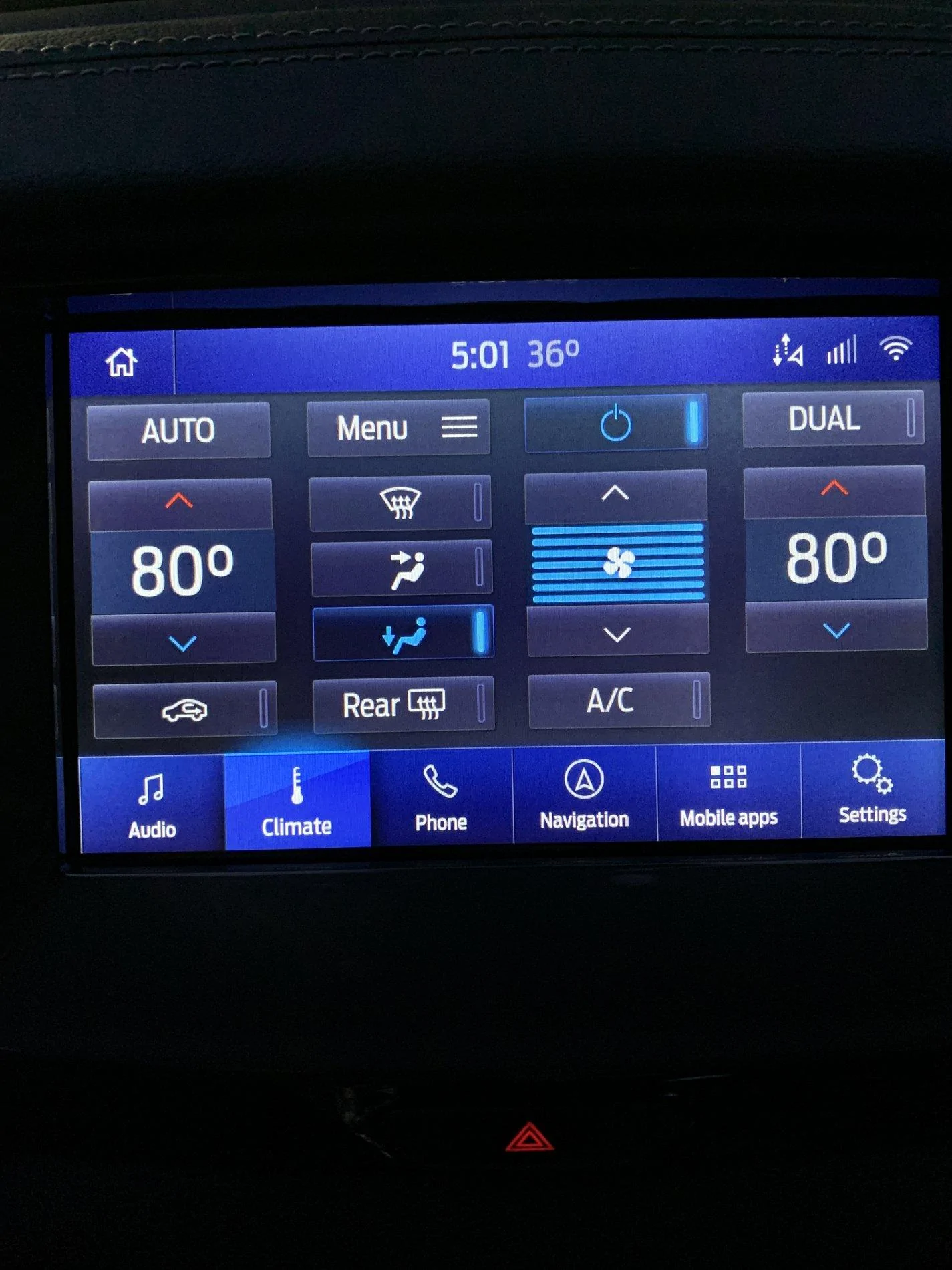

Solution found> on another Ranger forum I posted the issue and attempts to resolve. https://www.saeb.net/viewtopic.php?f=66&t=3312&start=25
Moderator had me upload my APIM to the site. He found an issue in settings, sent me a revised APIM, Climate icon is back!
Thanks to all here as well who offered ideas and information. If anyone else does the upgrade from 3.3 and had the issue, PM me and I will send you the APIM.abt given to me. Cheers!

@James Caper > Yes, of course I saved my APIM before applying the one I was given. I have numerous iterations of the file that I kept while trying to troubleshoot. I have the comparison tool but it was simpler to upload the new see if it worked then back it out if it didn't. Fortunately, it worked. I may look at the comparison when I get a chance. The key to what the guy did was in the fact that I had my factory APIM loaded before I upgraded to 3.4. The instructions on the F150 forum made that clear. So the dude that solved the problem was working with a clean APIM from a '19 Ranger, Lariat with 501a. If you have that truck, then you have the same APIM I would have to say.

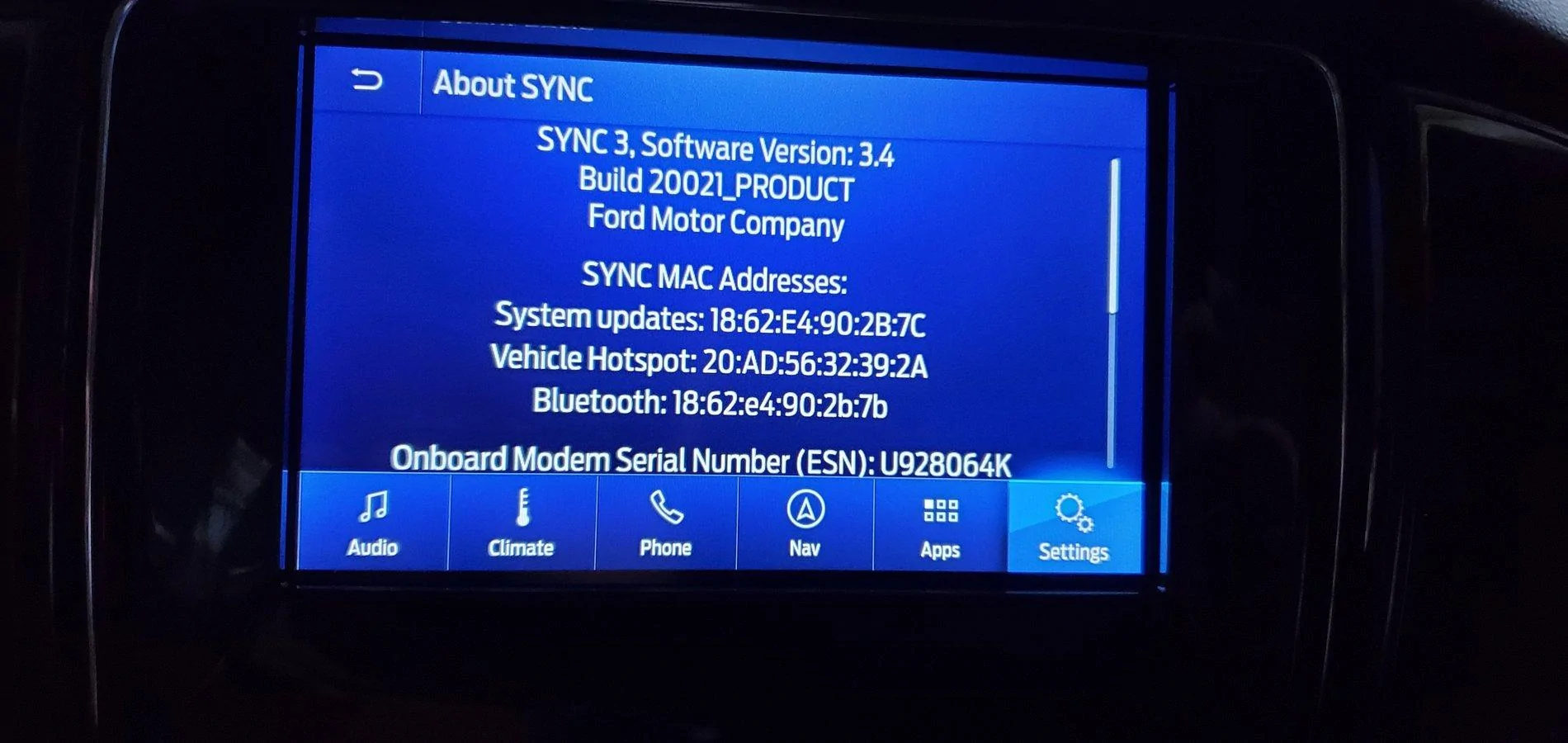

I installed Sync 3.4 build 20021 last night. It took about 25 minutes but I already had the 1.18 map update installed. I noticed two problems after the install. The maps still show as 1.17 and the Climate controls are missing from the Home Screen as already mentioned by Nluongo. Sync 3.4 is displaying the temperature pop-up when changes are made using the hard buttons. I have 14G421-CAB maps and 14G422-CAC nav voice in the IVSU software screen so I thing everything installed ok. I also ran a factory reset after installing but that didn't fix the issues.
I played with it for about an hour so there may be other issues to resolve before Ford releases the official Ranger build. I don't think it should be necessary to use Forscan to fix either of these issues. I hardly ever use the climate control screen so I'll just continue to use it and wait for the official Ranger version.

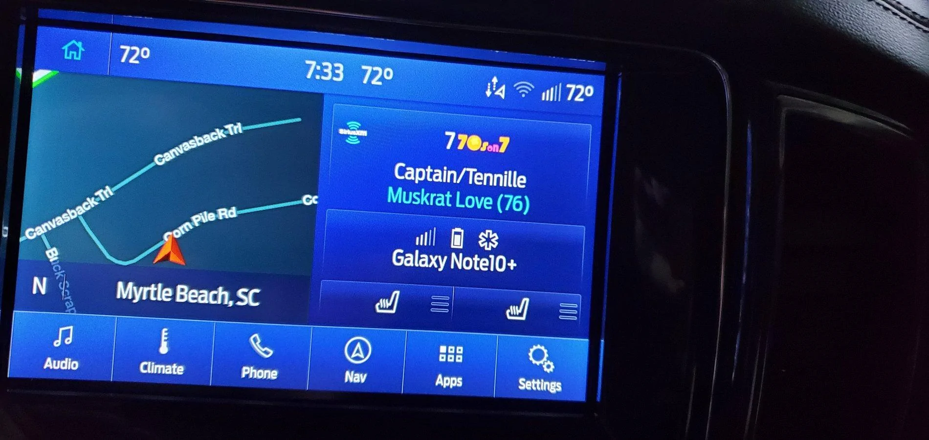

I used Forscan after the 3.4 update to bring back my climate controls, to shut off stop-start in, added seated heat icons on the screen below the phone. There are few other things I'm looking to do like turning on the fog lights with the brights. That can be adjusted with Forscan but I was using the F-150 list.
