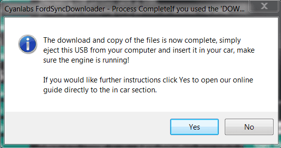

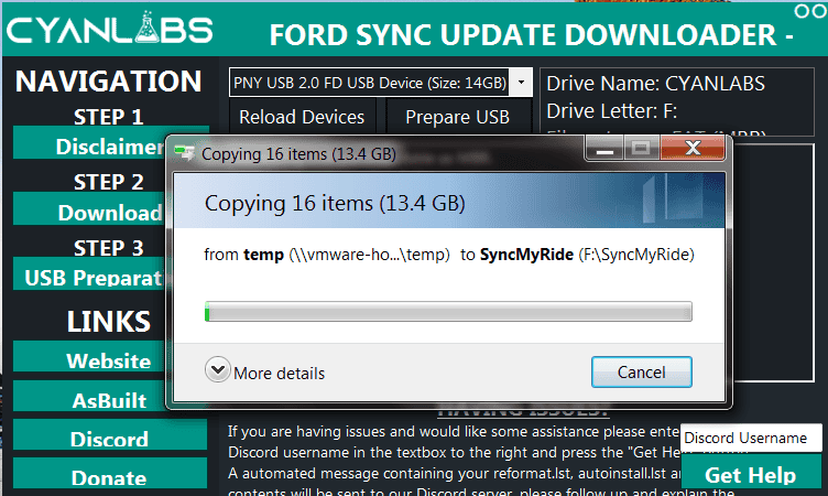

Cyanlabs.net/tutorials now has a "NEW" Ford Sync Upgrade tool (Windows only) that provides a step by step guide to upgrade from Sync versions 3.2 0r 3.3 to the desired Sync 3.4 build with maps.
https://cyanlabs.net/applications/ford-sync-downloader/
The Windows tool automates the entire process from Disclaimer, download of files directly from official Ford links, building the USB key for update, etc...
This tool only requires one USB stick, but because it is downloading the Sync App files, compatible voice files, and the maps, a USB key size of at least 16GB is recommended. USB3 not required or recommended.
I just tested the creation of the USB key and the files size required 13.4GB.
They obviously ran into some support issues with the manual process as they mention they had to remove the downloadable files from their website to not get into trouble with Ford.
I was able to successfully update my 2019 Ranger to Sync 3.4 Build 20021 using the manual method, but this automated method is recommended because the process downloads the correct, compatible files for you and formats and prepares the USB key automatically.
