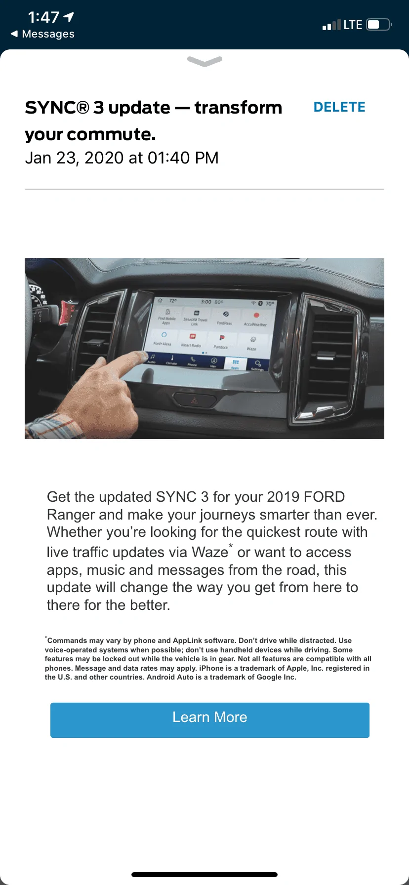

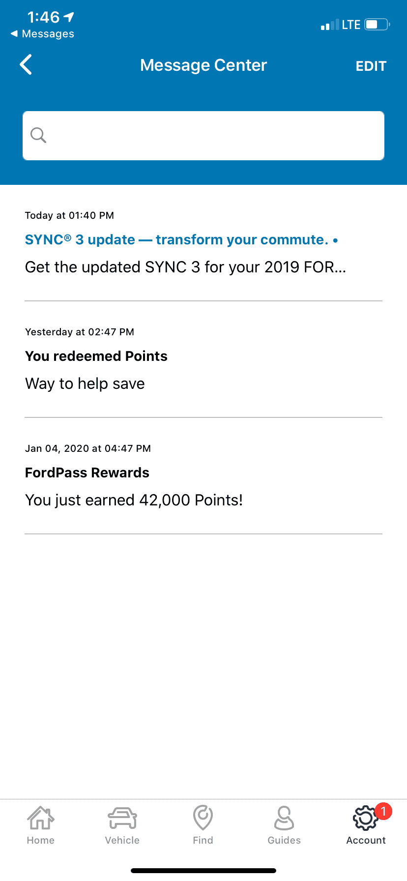

Just got this notice on my Ford Pass. Sync 3.4 update. Now if I can only get my truck to find the update and connect to the internet.
edit. Looks like it has to be via usb.

I should say sync 3.4
I saw the same on Fordpass, but when following the links, it shows 3.3.... Now I'm confused what it is :S
Well, it looks in the pictures it shows the blue bars which would be 3.4 right?

The thing that makes me angry is that we have a WiFi system and there’s a button to update but they don’t use that. Has to be an old crappy usb drive and computer.

I also got the notice of the update, but when I navigate to it on my home computer it tells me I don't have any updates.
I know, and that's why I got excited.. however, I downloaded both the earlier update (from April 2019) and this one (the files inside the package are dated 1/3/2020), and aside from the date, they are identical. Same unpacked size and same names. Also, the Ford.com site itself states 3.3 not 3.4.
That said, there seems to be a 3.4 update available, as mentioned here: https://www.ranger5g.com/forum/threads/just-updated-to-sync-3-4-on-my-ranger-2019.5988/ it is through the F150 forums, but it appears to work for the 2019 Ranger (according to the OP).

I got the same "SYNC 3 update - transform your commute" message on My Ford Pass on my phone today. As others have done, I got on my laptop and no update is available. I then called Ford customer service on the 800 number. I had to find and give them my VIN (real convenient) and they also said that no update is available.
What a sh!tshow!!!
