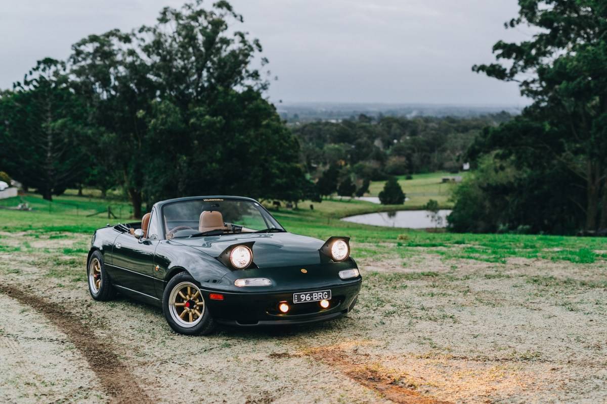

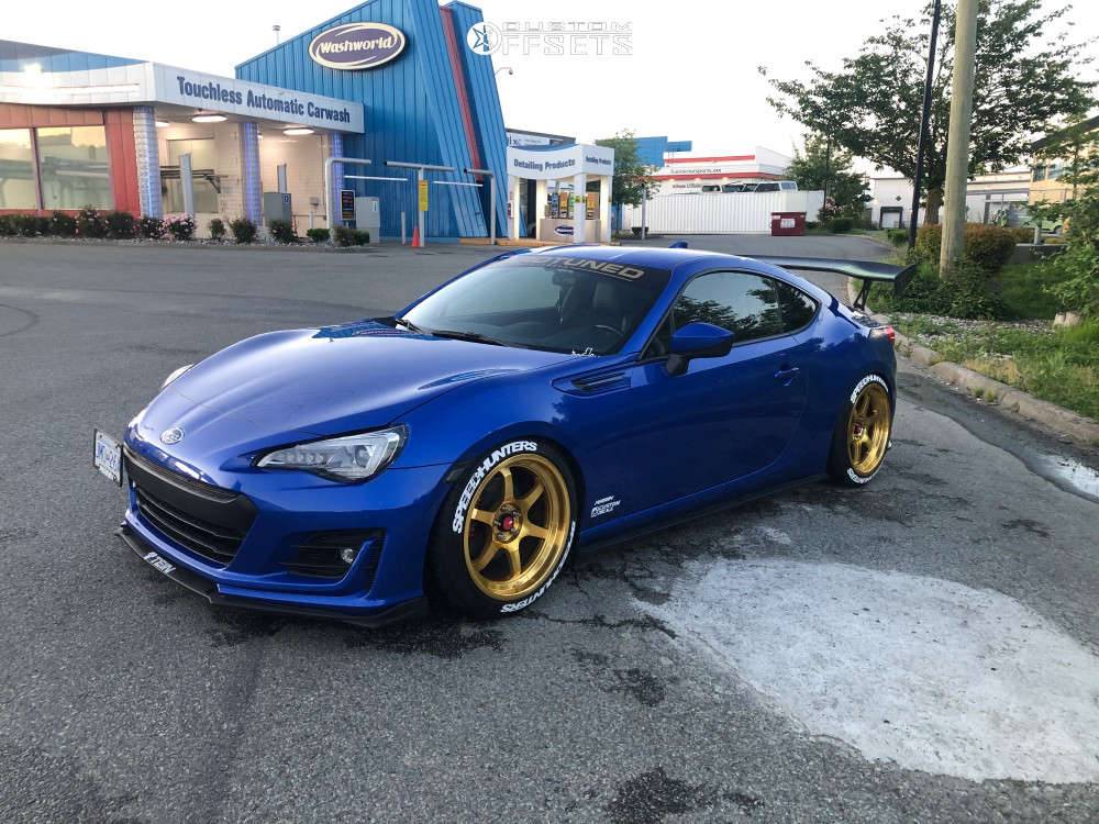

So what does the Miata offer over say, the BRZ/FRS?
Shawn listed a lot of good points. But I'll add removable roof, about 600 lbs less weight, and a complete lack of nannies. The '90 I'm looking at has no ABS, no traction control that never turns off, no TPMS, nada.
And then there's style
this...
Vs this...
And that's coming from a retired Subie guy.

Is that supposed to be ugly? Minus the wheels and wing I'd take the BRZ.
I drove a Miata once and while fun, my eyeline was about even with the top of the windshield.
Not ugly. But not pretty either. BRZs are nice. Very similar driving dynamics as Miatas.
For me the BRZ crowd are folks I'd prefer to not be associated with. Not looking for a new vehicle and most used ones have questionable history. Now that Toyota owns Subaru I'm probably done with new ones. Add in the fact that it's harder and harder to find a clean NA and for me it's a no brainer.

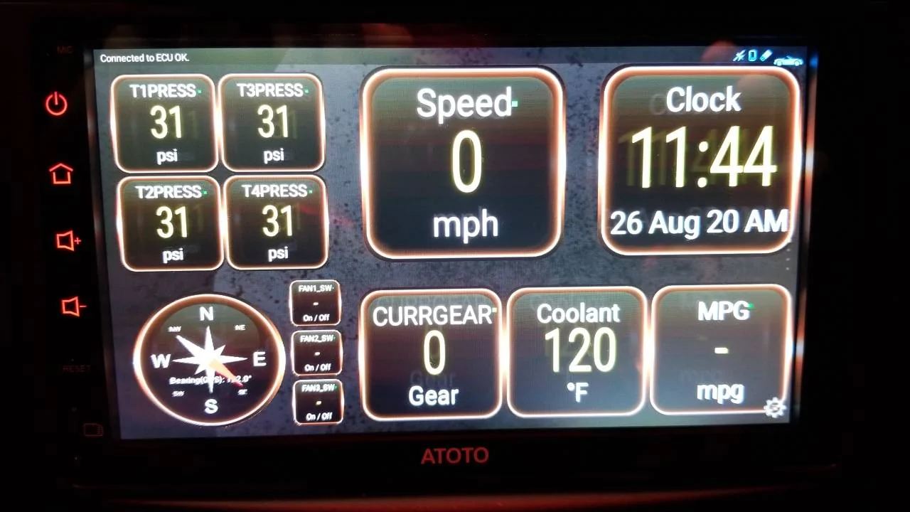

Not sure what options the NA has but I added an android head unit in my NC and along with a Bluetooth OBDII devices and the Torque Pro App, you can display a crazy amount of info... again, not sure if that's available for the NA but even without the APP the head unit will give you a very nice upgraded stereo.
