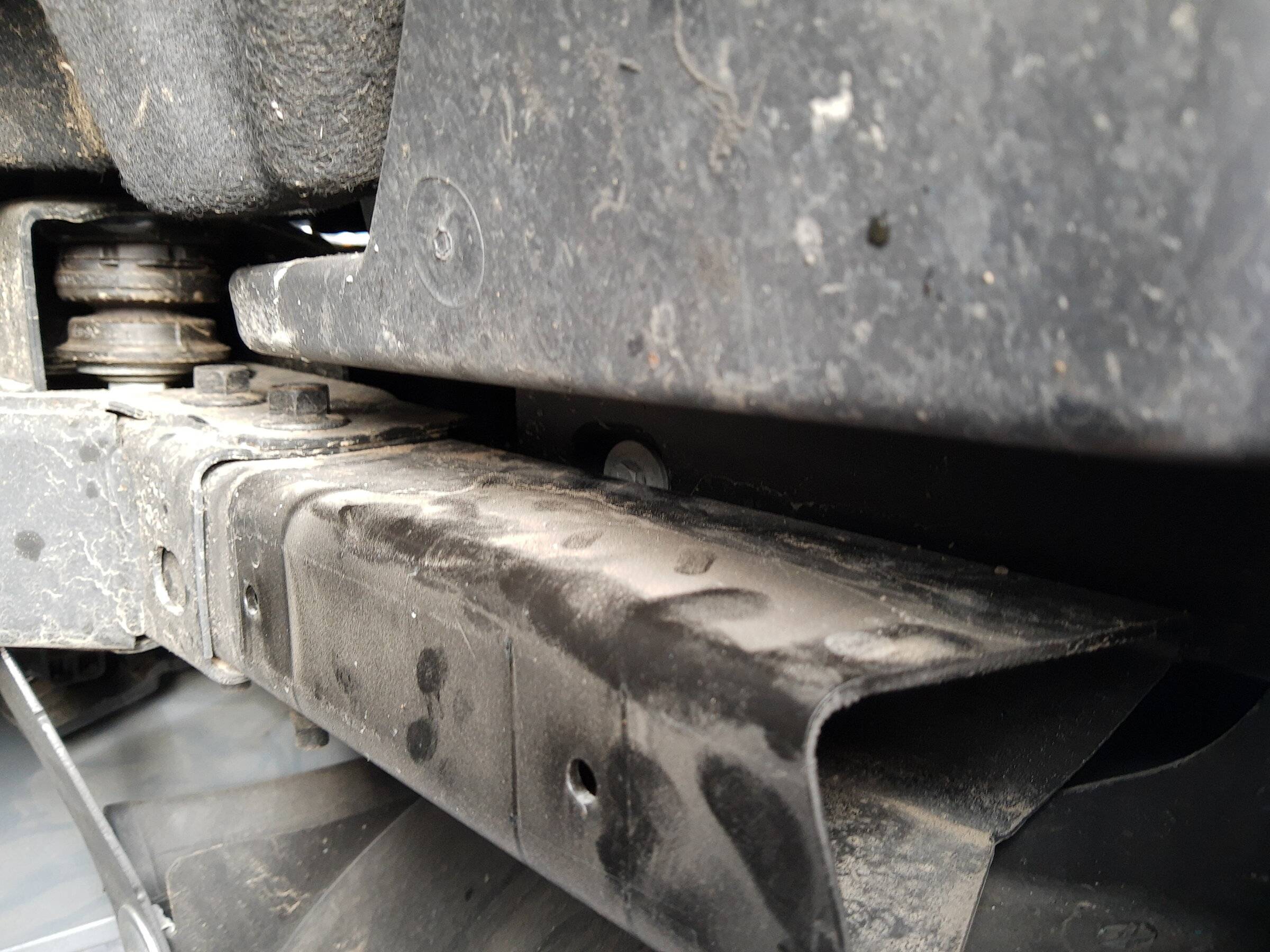

So I got a pair of Diode Dynamics fog light pods. To get the fender liner out to remove the factory housings you have to remove a few bolts. One of the bolts is behind the crash bar. I was trying to figure out how to go about as the only video on found on install had the crash bars removed.
Maybe I am just missing something. I was trying to make it a quick afternoon job but, I was running out of light and patience so I didn't get it done. Any "Pro-Tips" on installing lights?

I just put the pods in Friday. I put the truck on ramps to give me room to slide around on my creeper. Took the skid plate and little air dams off. Was able to get to everything from underneath. You don't need to go through the wheel well or remove the crash bars. Also, the bracket behind the fog lights doesn't need to come out Each light pod has four small T25 torx screws holding it in. Removing the factory pods was the toughest part Putting the new ones in was a breeze.
