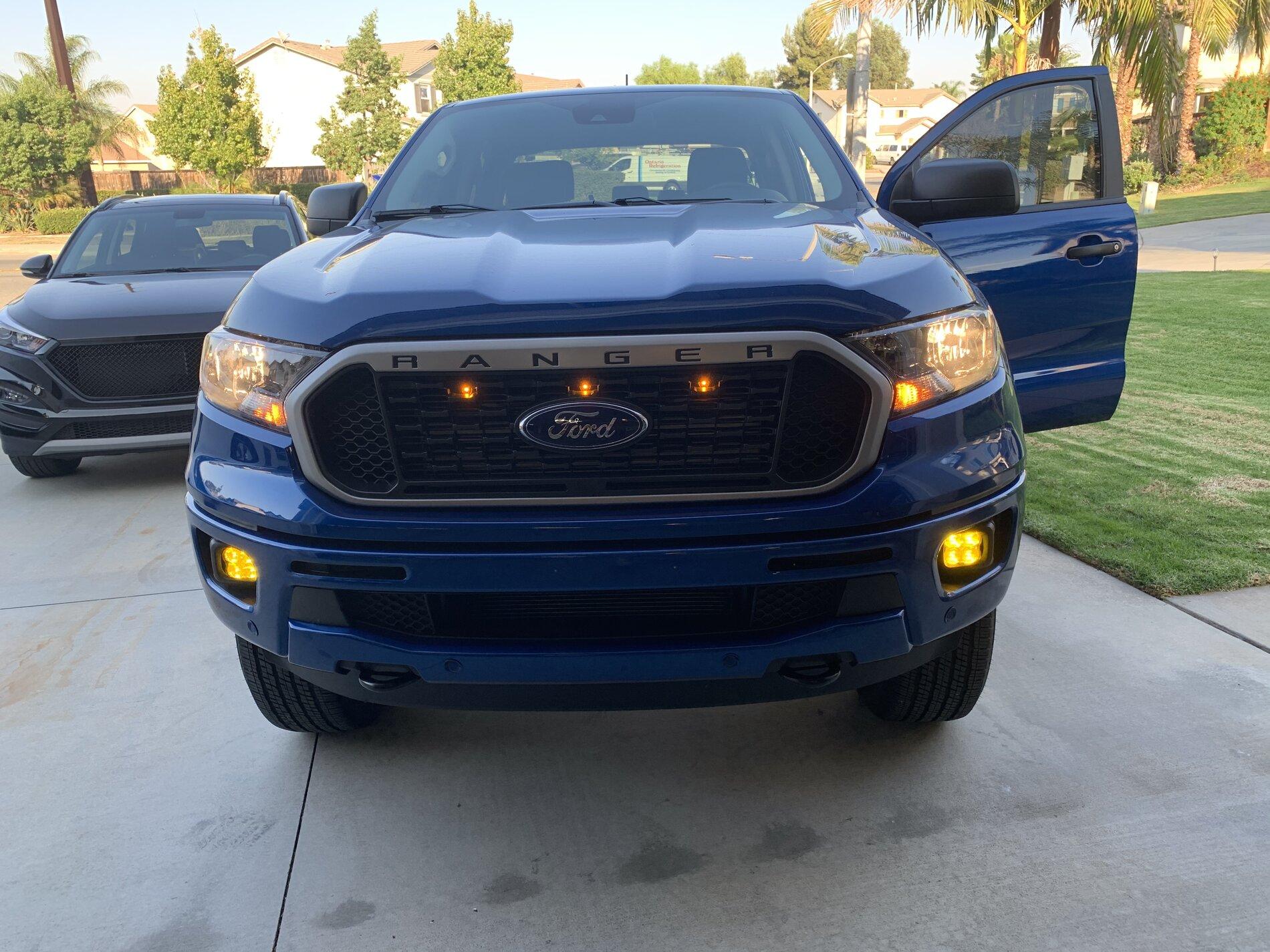

Installed my Diode Dynamics SS3 fog light pods today and really could not find any install videos except the one for Baja Designs Squadron lights. I found the way not to do it is going through the wheel well as per the video shows, it only works if you have your crash bars removed. There’s no way to remove that plastic panel with the crash bars installed and you can’t remove those with the bumper on, plus I really didn’t want to root around near my paint for that top bolt. They’re accessible below the bumper with a 1/4” ratchet and a T25 bit. It’s tight but all is required is to remove the bulb and four screws and the OEM light comes right out. Put in the pod, replace the screws and make the electrical connection and you’re done ✅ ???

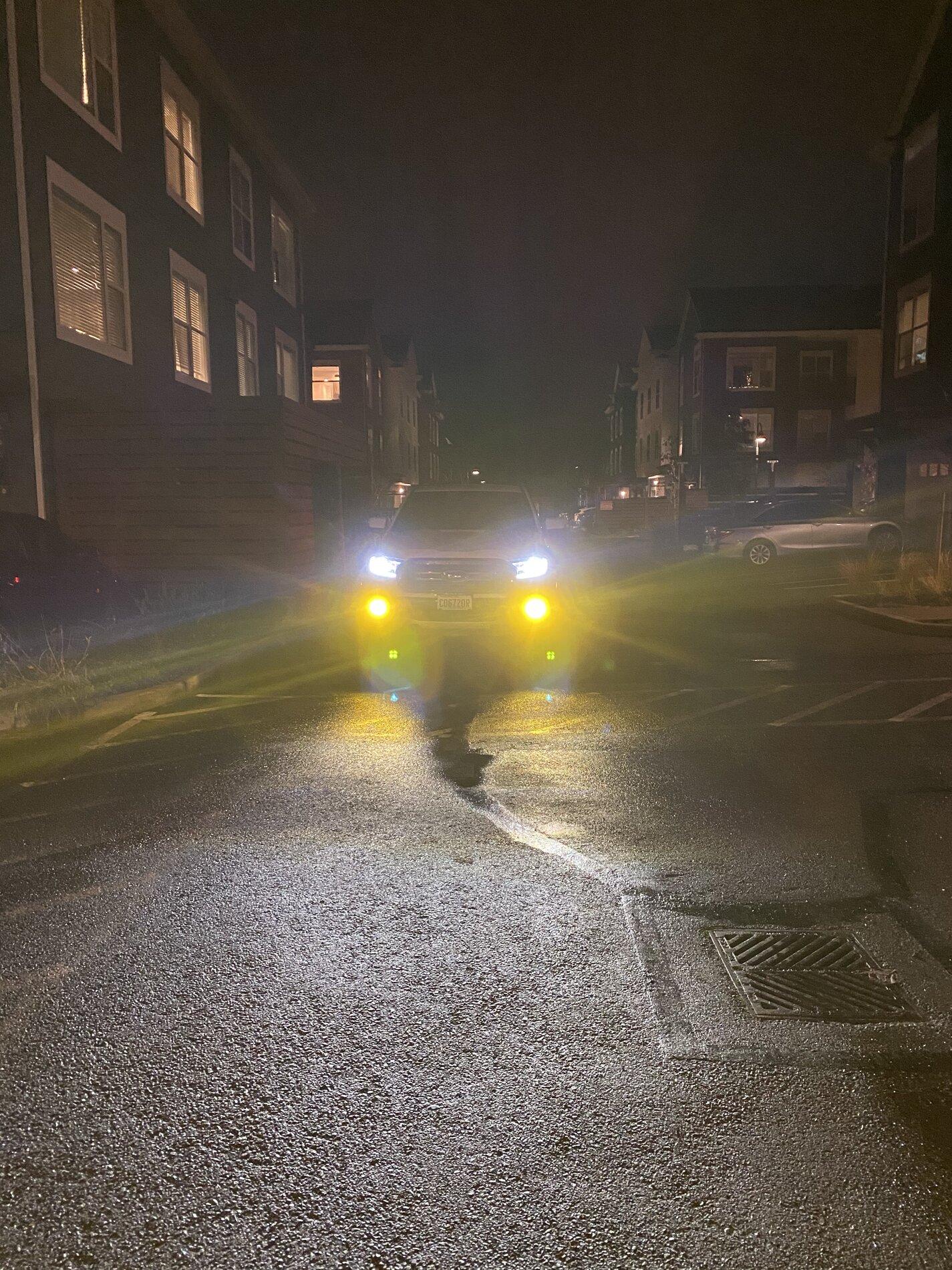

The picture doesn’t do it justice. Picture show lo beams on and then with lo beams and driving lights. They are insanely bright, I know they are angled correctly but I’m still getting flashed by a lot of other drivers.....which I don’t like...:I don’t want to the that guy with blinding other drivers.
