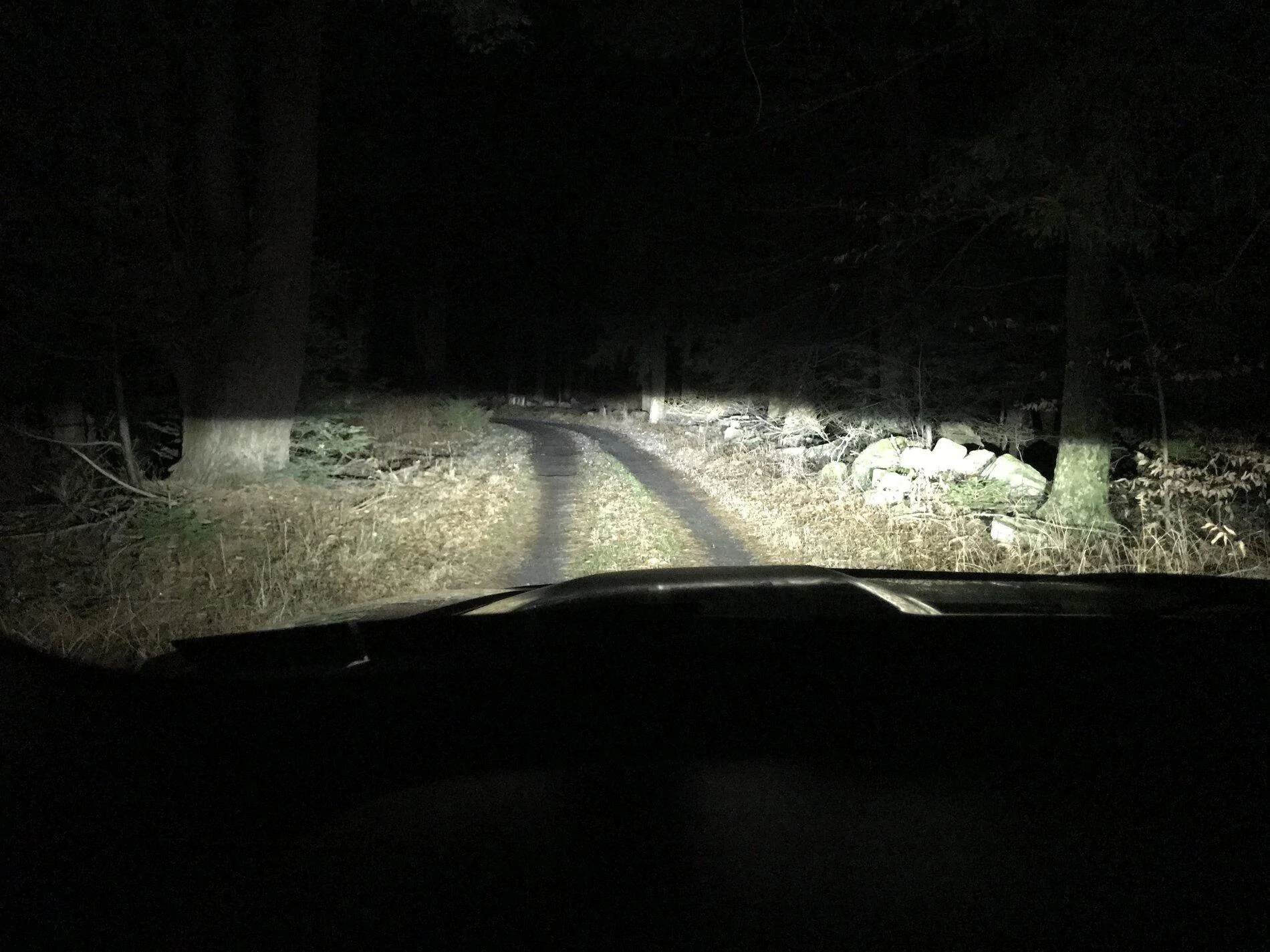

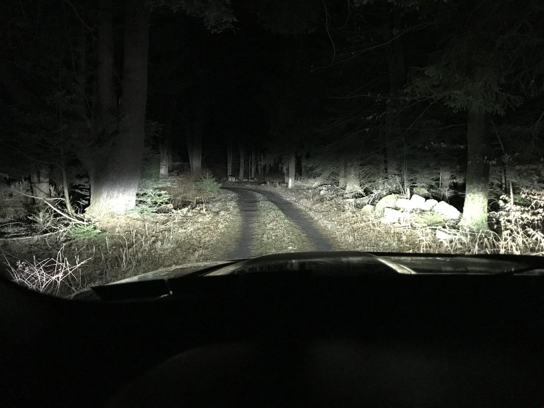

The picture doesn’t do it justice. Picture show lo beams on and then with lo beams and driving lights. They are insanely bright, I know they are angled correctly but I’m still getting flashed by a lot of other drivers.....which I don’t like...:I don’t want to the that guy with blinding other drivers.
They appear to be aimed too high. Notice how much higher the light is on the distant trees in the 2nd picture than with just the low beams.
The right one was a little too high but not much. I have since changed it. The output is immeasurable brighter compared to the stock LED’s. They are brighter than the LED low beams on my Lariat.
