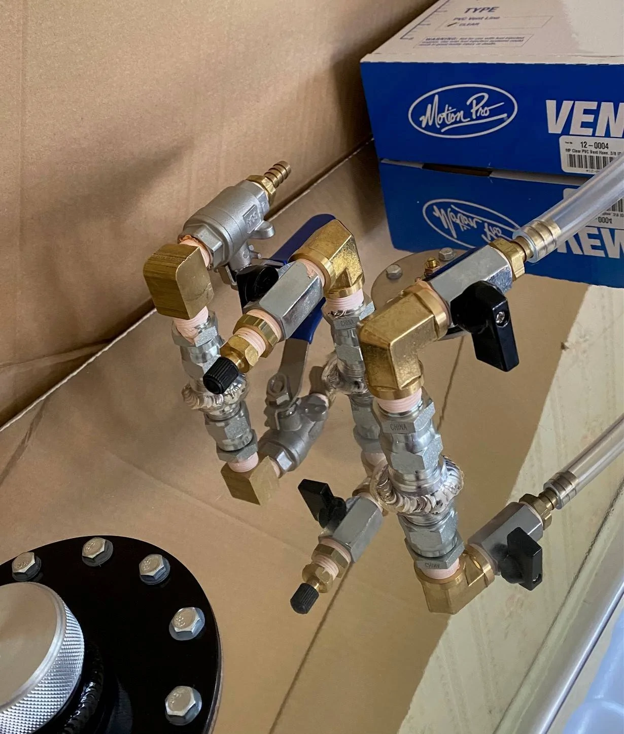

All the fittings and hose are in, but the tanks aren't in the truck yet. Over the winter I am welding a frame for them to sit on, and it will all get installed in the spring.
Mirror finish on the tank is pretty awesome.
