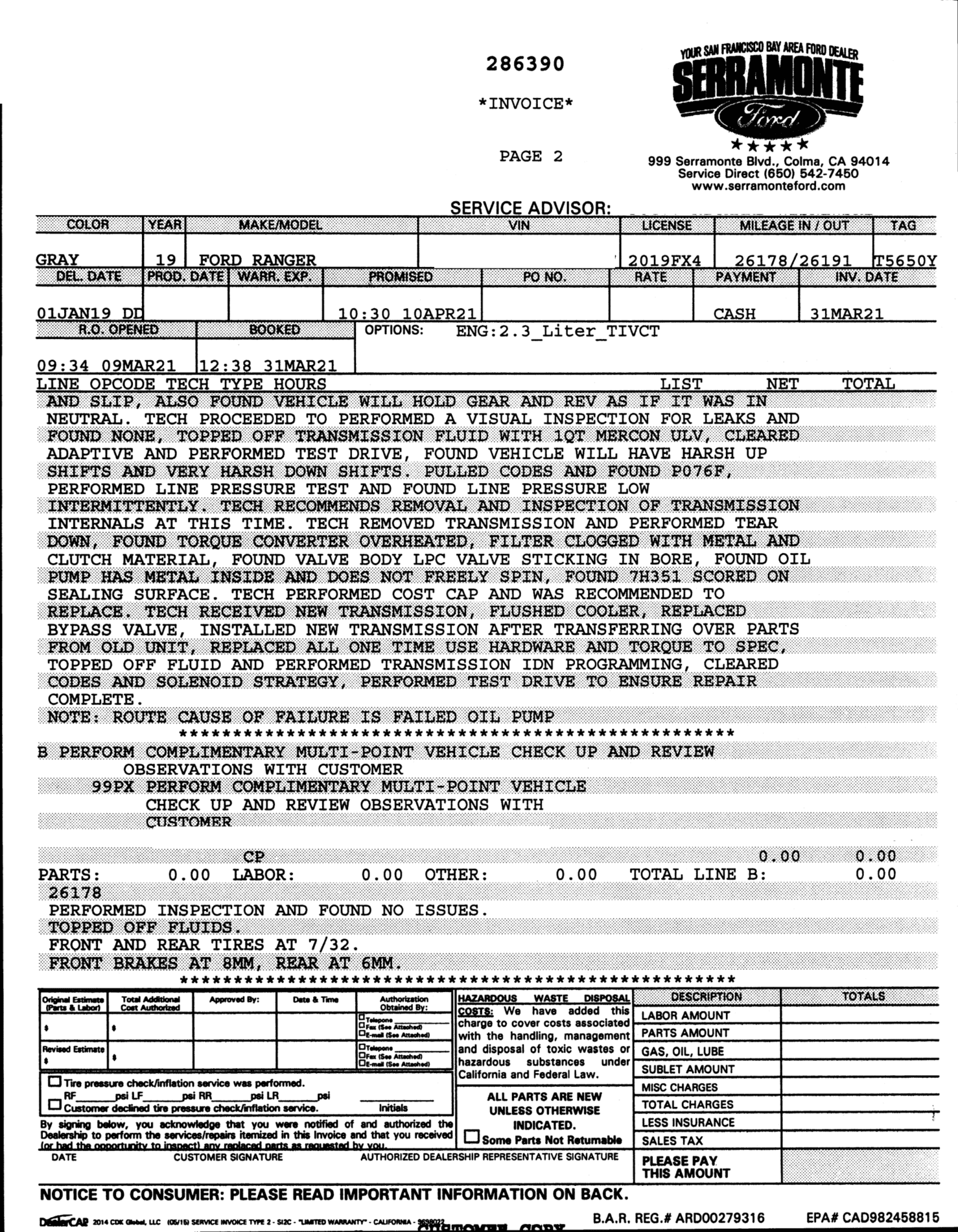

I'm getting my transmission rebuilt or replaced
