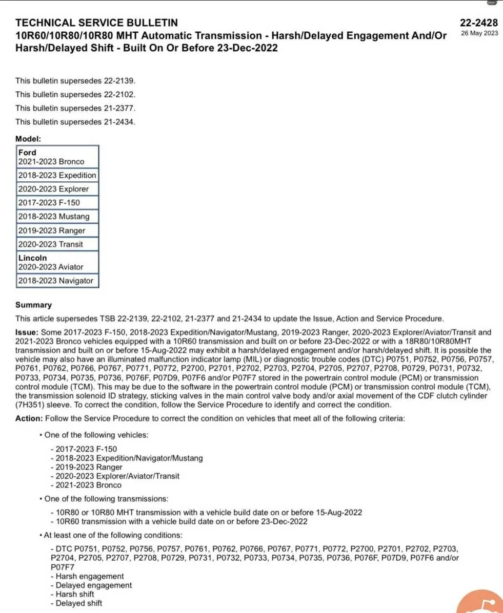

Brought the truck in for the hard/long shifts I’ve been experiencing (see prior post) and the tech drove the truck and acknowledged the problem. They updated the PCM with TSB 22-2428 (I believe Ford issues this in May) and noted to drive it a couple hundred miles so the transmission “relearns” my driving habits. The results? A noticeable difference in low gear shifts, a lot more smooth. Will this be the case in a week or month from now? Not sure but I did ask if my problem was mechanical (not software) related and he assured me it wasn’t. Of course my warranty runs out this week so joke may be on me…
Ive attached a copy of the bulletin. Mods may want to post with this with the other TSB if not already.
Buy your extended warranty while you can...

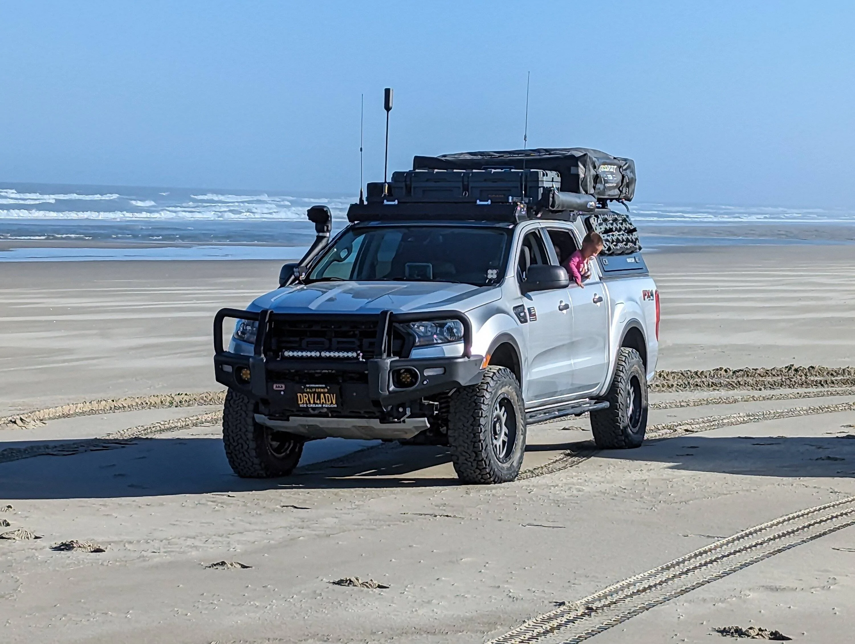

Update:
New transmission is good. Just came back from a 2 week trip. Drove 3,300 miles up the coast of California, Oregon, and Washington and back down on the east side of each state. I climbed....a lot! did some offroading on the beach and on the trails. Went through the desert, snow caped mountains, and everything in between. Even took a ferry. Shifting is as desired. 4 Low, 4 High, Locker, Highway and stop and go traffic all performed as it should. I do love this truck. I just wish the tranny lasted longer for me.

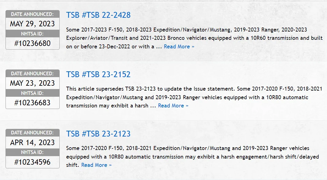

There's several recent TSB's on the trans. Not just the one listed above.
I would like to believe that many of us with issues, would see relief if they were applied.

Definitely not going to fit in my garage and I'm guessing 12 mpg highway...
Close. I get 14.5 mpg city/offroad and 17 - 18 on highway. I live in Commiefornia so it really hits the wallet. Gas around me is averaging around $5.00 for 87. Some are as high as $5.50 within a mile from here. I gas up from Costco and Sam's Club every chance I get. But it beats needing a Tesla supercharger any day. Murica!
That's impressive for the amount of gear and front area you're dealing with...$5/gallon would probably keep me on my Honda 125 more than the Ranger lol...
