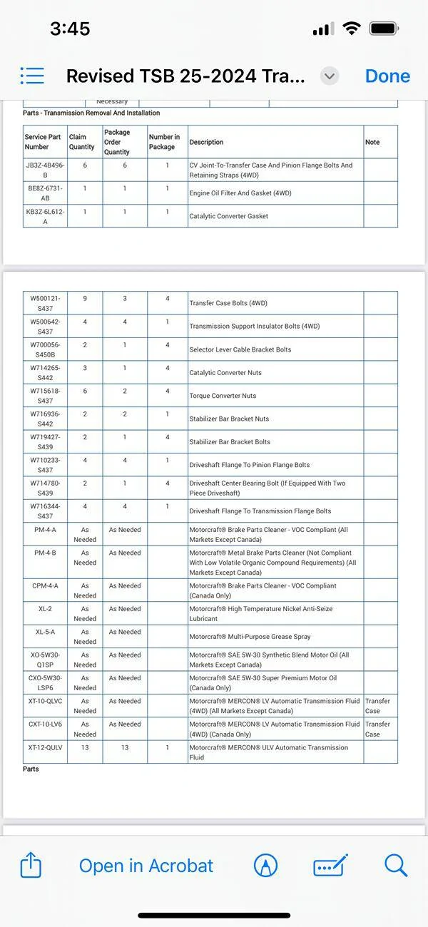

They shouldn’t charge you for it as the fluid for the transfer case is listed as required change on the parts list in the TSB
Thank you. I was surprised it wasn't already on the work order. I haven't yet be told what exactly they're replacing. Maybe they're not doing a full rebuild?

If they’re removing the transmission from the truck to do any repair then the transfer case gets drained/removed
