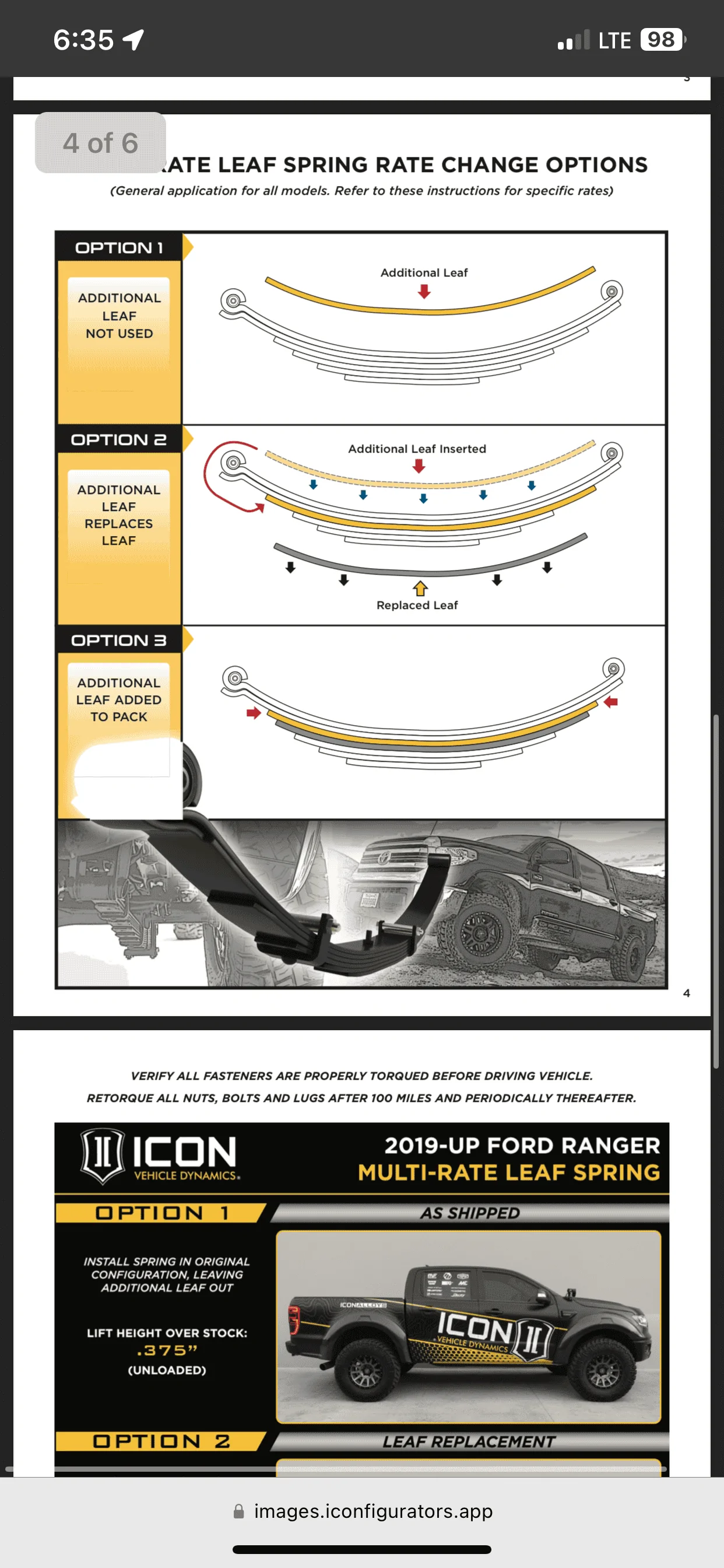

I’m ready to pull my Icon spring out and put the stock springs back in or purchase a used set of Tremor springs..
They are over an inch higher with 140 pounds in the bed and they squeak over every bump. I greased the pads on the springs but they still squeak and I hate it..
I have been holding out on doing a review on them from stage 3…
I may remove one of the springs but unsure what one to remove, anyone have what one?

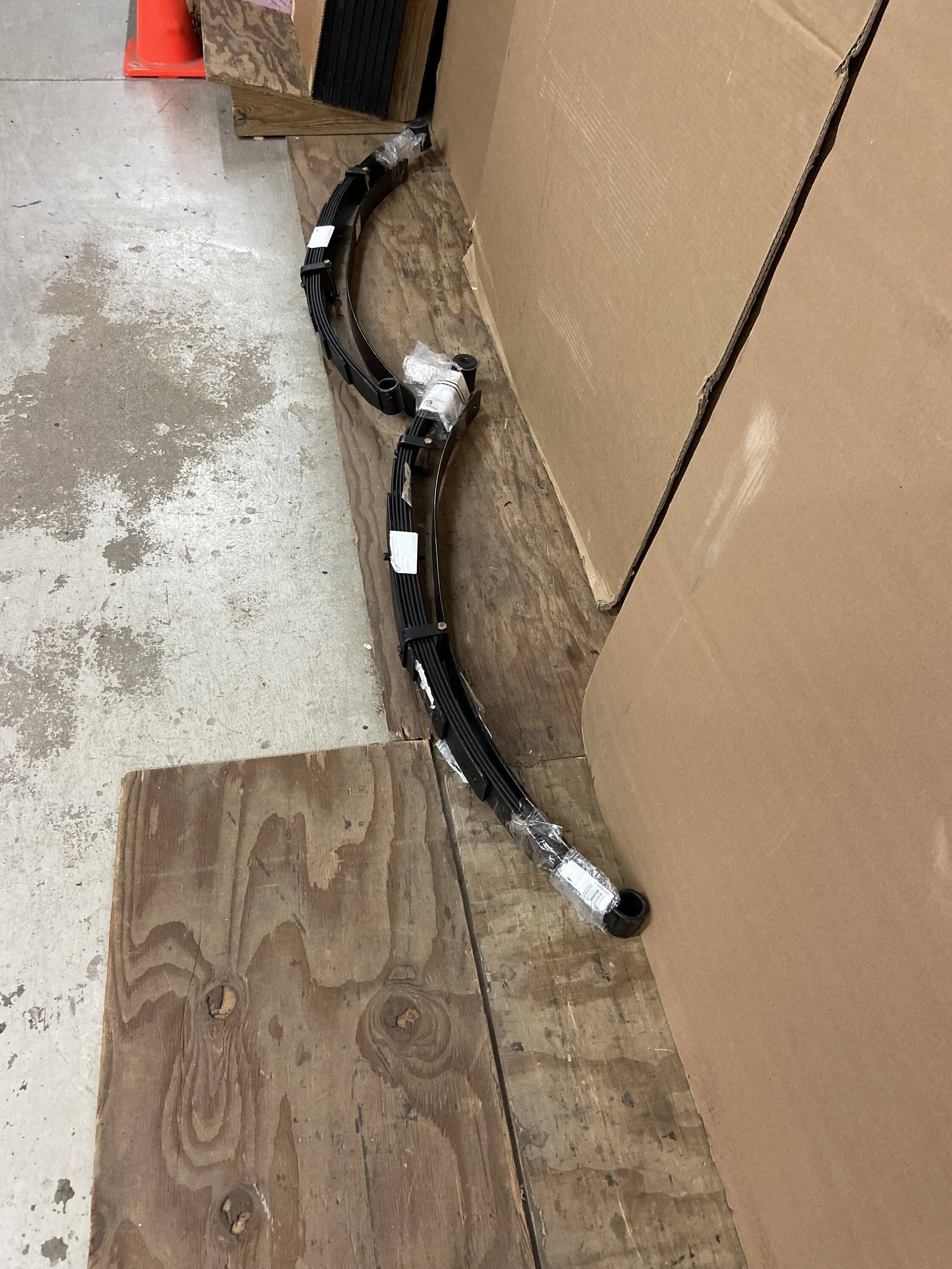

Where are you getting the used springs from?

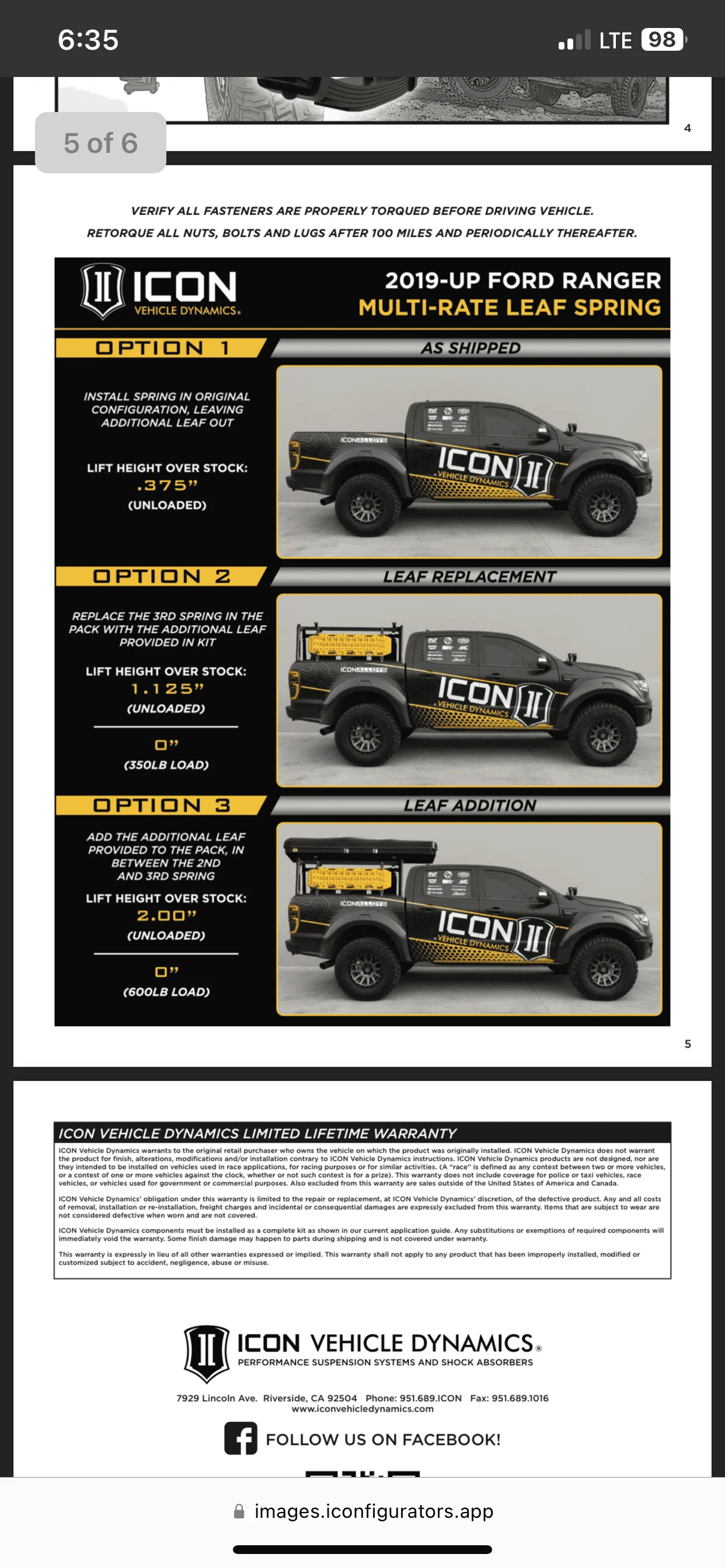

I keep going back and forth on these versus ordering the global multi-leaf springs from across the pond.
I also saw one reviewer on Stage3 said he removed the 3rd leaf entirely, leaving the pack with 5 leaves. They said the truck rides great, and it left it right at stock ride height. I know this isn't one of ICON's options and they're not going to recommend it, but could it really hurt?
that was me . it did, but i eventually put it back in. i’m on global leafs now. not quite as plush as icons, but it kept me around stock and is way better than the mono leaf.
