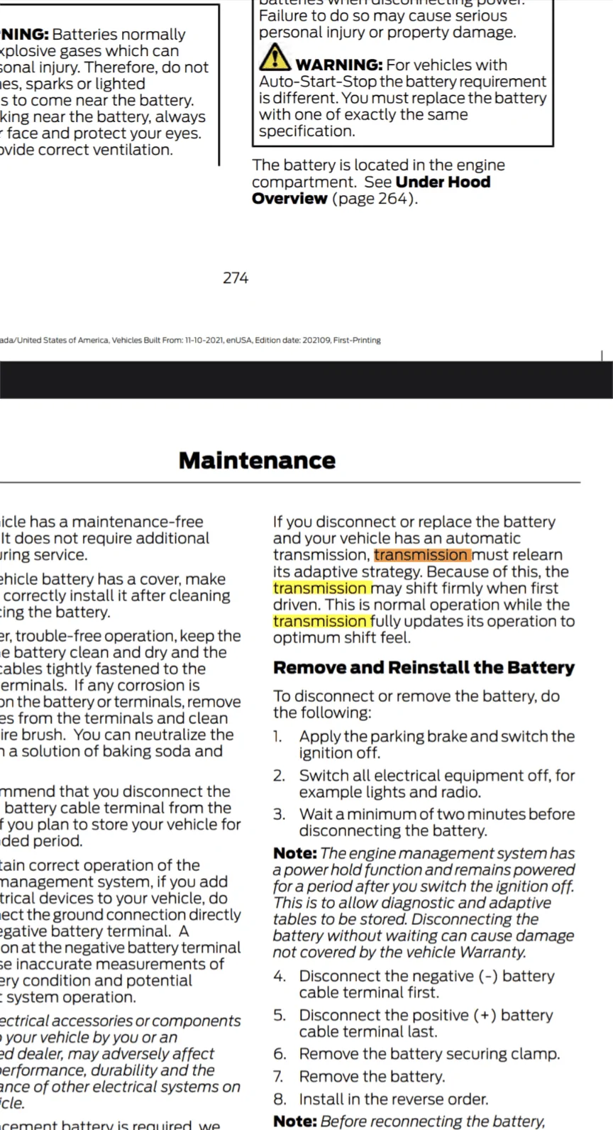

I was always skeptical that these transmissions "learn" our driving styles. That has been debunked at this point right?
Dr_Strangelove
Adam
Oct 14, 2022
1,180
5,418
Henderson, NV
'22 XLT Supercrew 4x4
Art, Design, Photo & Video
@gwhalin - There is one mention of it in the manual. I took a screenshot off my phone - the word "Transmission" is highlighted because I was doing a search for that word to see if it came up in the manual. This is the only place I found it.
