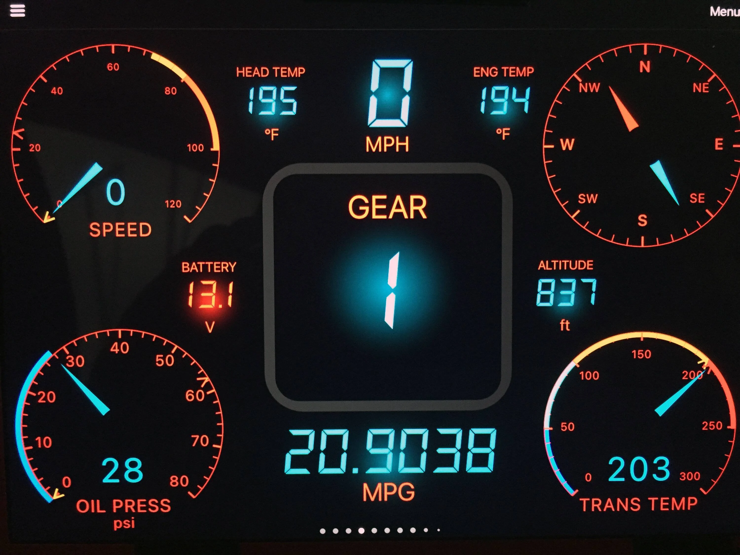

There are no dedicated sensors in the transmission and 220 is pretty high. IIRC the readings are based on coolant. At least the factory coolant system integrated with the trans cooler is good, but keeping those peaks down would extend the life of the tranny. Conventional coolants boil at around 235°.
There is indeed a temp sensor in the transmission. Else I and others would not have measured a difference in temperature with and without a PPE pan. It would simply track the coolant.
The ULV Fluid (And several other 'new' fluids) are designed to operate at what would normally be considered 'high' temperatures. I wouldn't be the least bit concerned until you start getting upwards of 240* and I haven't heard of a Ranger getting that high yet.

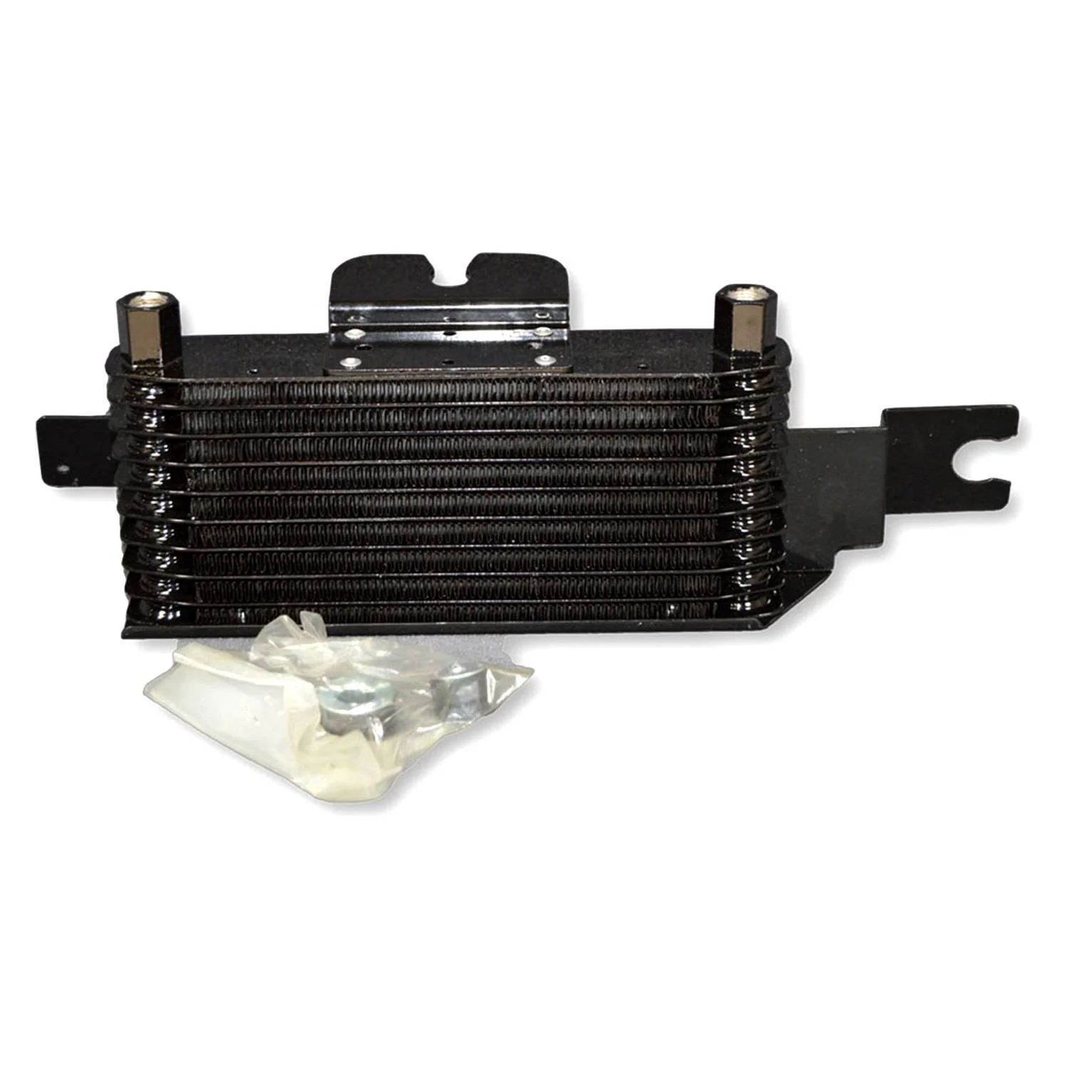

What about adding a secondary trans cooler radiator such as this. My 1995 F150 had something similar that came with the factory tow package. I don't remember if it was in line before going thru the engine radiator, or after. I guess you would still need to do something about the trans thermostat.
Bypassing or altering the temp the thermostat opens at or leaving it open seems smart to me given the inherent design. Adding an external cooler - I don't know. Where to mount it, the risk of introducing leaks and managing pressure in our trucks seems marginal in the pursuit of keeping the transmission in a specific range seem like concerns. You can tweak pressures it seems through the valve body. I speculated about enhancing the cooling system to compliment the transmission temperature but it seems Ford did a fair job of designing this part of the system - including the transmission fluid and coolant.

I also do not think that messing with the fluid circuit is worth the risk. If you are going the separate cooler route, make damn sure you're not dropping more pressure through the cooler than the stock one does. This is the last transmission I would want to have low line pressure or flow. From what I gather from Sonnax and some of the other aftermarket parts suppliers, sufficient flow may be a problem given that they are offering updated valves.
