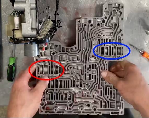

The Sonnax Part is the Pressure Regulator Valve and is located in the red circle. Sonnax doesn't appear to sell the Thermal Bypass Valve.
The Thermal Bypass Valve is located in the Blue circle

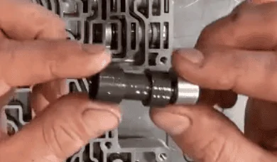

The original Thermal Bypass Valve looks like this

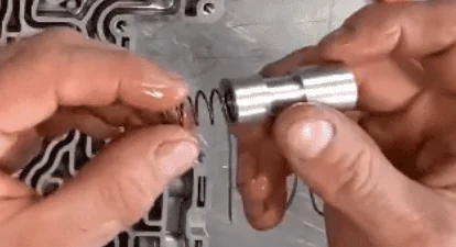

The replacement Thermal Delete Valve ( Allows full flow ) looks like this
This outfit makes the part. Video can be found here

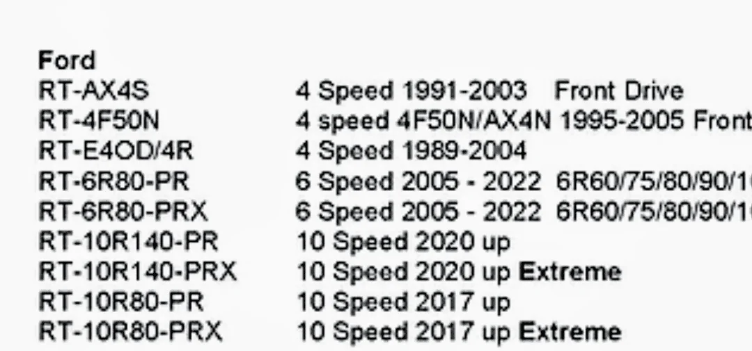

Here's a shot from the mfr site - note the years for specific kits?
An email exchange with Ratiotek got a recommendation of using #RT-10R80-PR.
