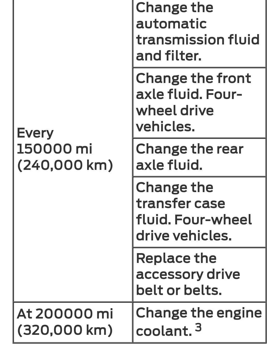

Opinions will vary.
Ford calls for a 150k change. In my opinion that is WAY too long to go.

See post #2 above, here is the maintenance schedule from Ford
